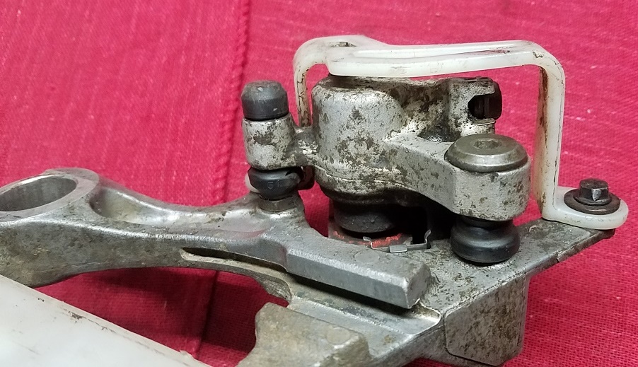

First on the agenda is the rear brakes.
Stock KX500 rear brakes stink... Sure, for the average rider like myself they work fine.
But I don't ride like Sean does so something a bit more updated and powerful is in order.
Here is what we are starting with a slightly used 06-12 KX250F, KX450F 08-12 rear brake caliper and mount :lol:

Yeah, whoever owned this bike was not in to maintenance... :o :shock:

Ok... After a bit of clean up I can now tell what I have to work with and I think it will work just fine...

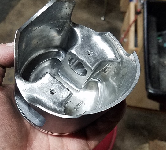

One of the other things we are going to do is to tame down the Beast engine by changing the porting as well as the timing.
Then along the way there are other things... (Secret things) we will do to put a smile on Sean's face..
Unless you are real familiar with a Wossner piston you won't know anything is different...
SEAN COLLIER THE BEAST KX GURU RACING REBUILD 107.jpg (126.19 KiB) Viewed 22241 times
