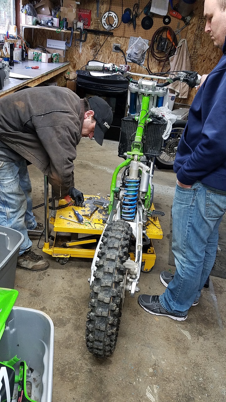

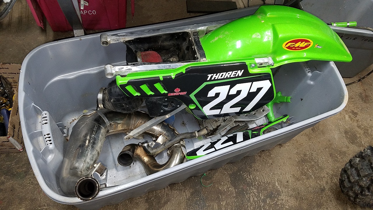

Jeff brought his entire bike down to the shop.
Jason made short work of the disassembly..
JT ENGINE WORKS KX GURU RACING ENGINE BUILD FOR JEFFS 93 101.jpg (445.08 KiB) Viewed 9467 times
JT ENGINE WORKS KX GURU RACING ENGINE BUILD FOR JEFFS 93 102.jpg (527.8 KiB) Viewed 9467 times

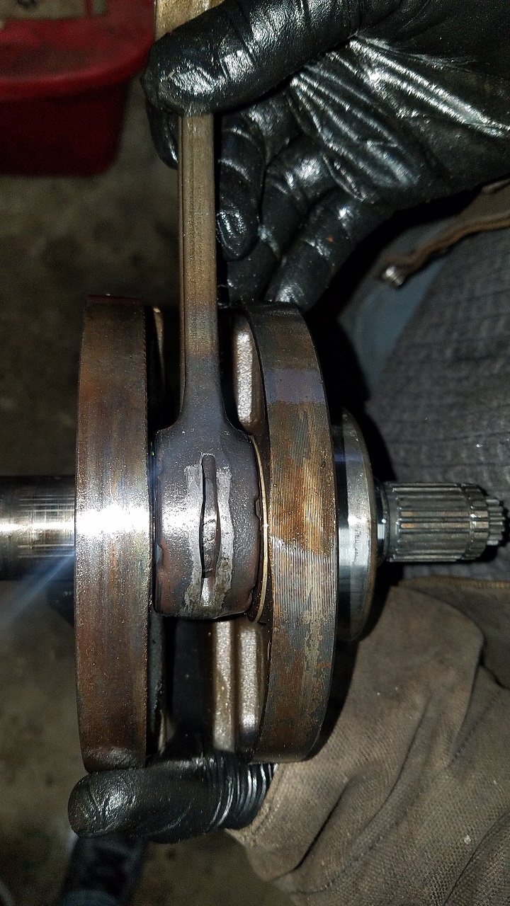

This crank is done but Jason will have it pristine before long..
JT ENGINE WORKS KX GURU RACING ENGINE BUILD FOR JEFFS 93 104.jpg (445.38 KiB) Viewed 9466 times

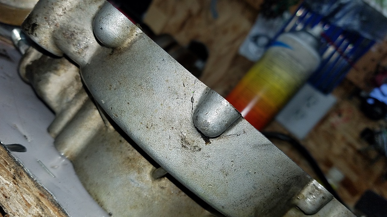

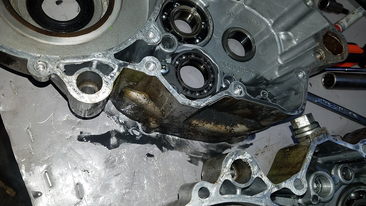

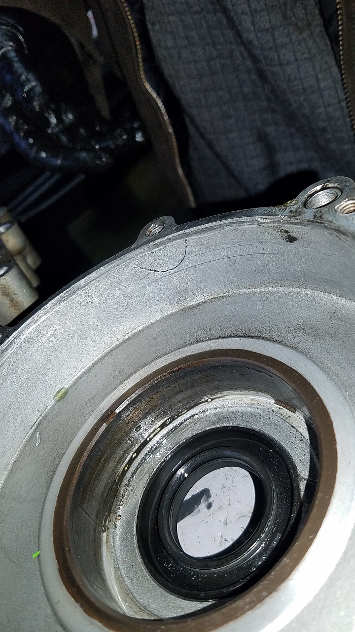

I hate case damage but Jason can get it in great working condition..

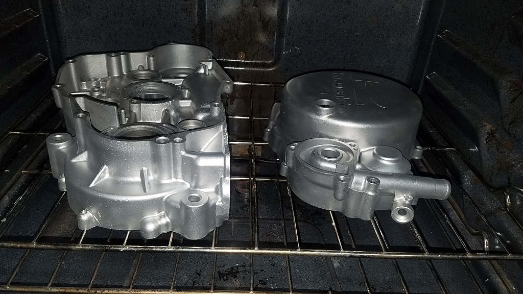

Like most builds this engine needs a good cleaning..
JT ENGINE WORKS KX GURU RACING ENGINE BUILD FOR JEFFS 93 107.jpg (522.4 KiB) Viewed 9464 times

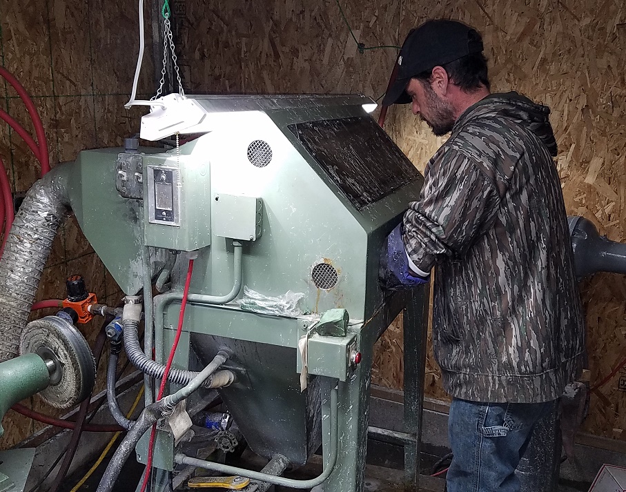

Here is the case and the clutch cover baking after vapor blasting.
Our welder loves how clean we get the parts 8-)

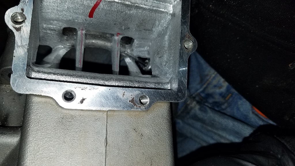

It was hard to see but the other case was cracked as well... No biggie... Jason will get it fixed up good as new..

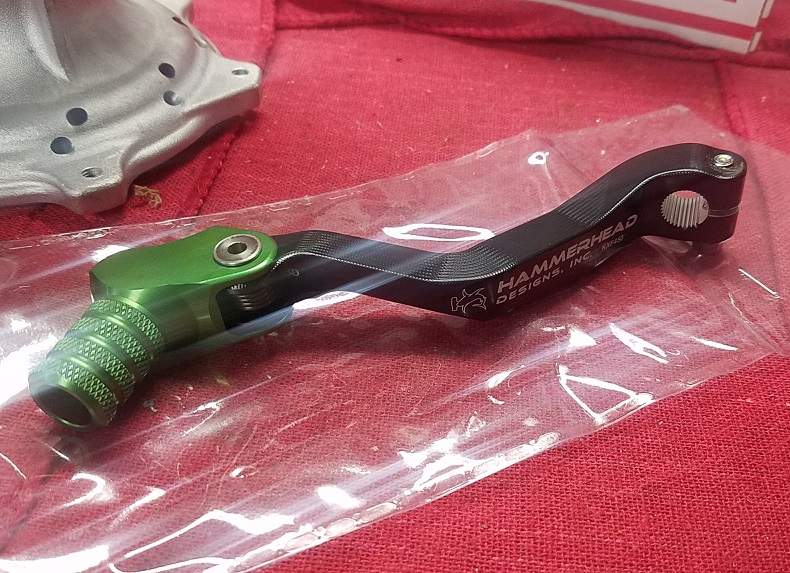

I know it's a minor part but the shift lever came in today... 20mm longer then stock...
Of course we had to change out the shift shaft to the 94-04 so that the splines would fit but I think it is well worth the upgrade.
I like mine..

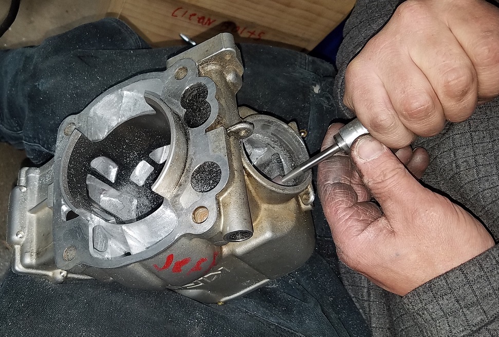

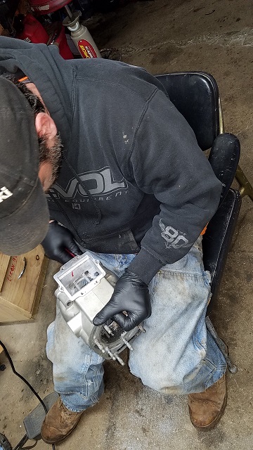

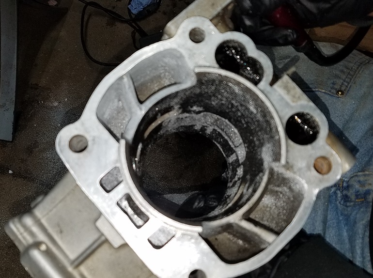

Jason is hard at it...
It's amazing how many hours it takes to do a nice porting job...
JT ENGINE WORKS KX GURU RACING ENGINE BUILD FOR JEFFS 93 112.jpg (181.41 KiB) Viewed 9438 times
JT ENGINE WORKS KX GURU RACING ENGINE BUILD FOR JEFFS 93 111.jpg (257.21 KiB) Viewed 9438 times
JT ENGINE WORKS KX GURU RACING ENGINE BUILD FOR JEFFS 93 110.jpg (123.62 KiB) Viewed 9438 times

Still hard at it... Same cylinder, different day...

After doing the base porting, Jason is Vapor Blasting the cylinder to clean it up.
Once it is done it will get all final port work then it will go off to plating.
Once it comes back, it will get the final Vapor Blasting and then polishing, clean up, then assembly..

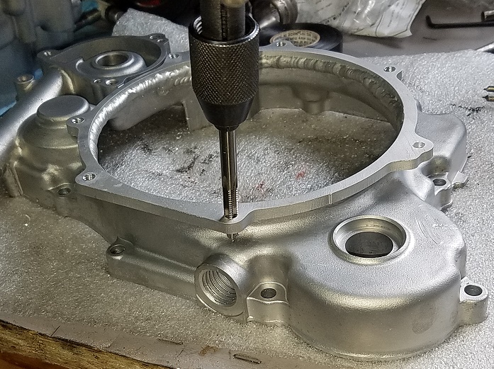

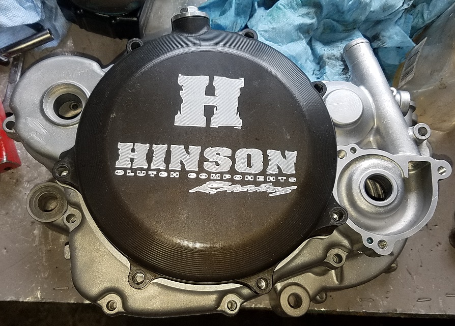

I finally tapped all the holes for the 2 piece clutch cover..
It's gonna look great.
