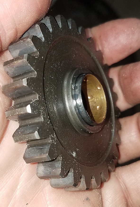

If your KX500 is 10-15 years old it's likely that the bronze bushing is worn out....
Almost every KX500 Jason and I have rebuilt over the last 5 years needed a new gear and we use to simply order a new one.
What to do....
kx guru racing kx500 86-04 kx500 kick idler gear 101.jpg (267.62 KiB) Viewed 12089 times
If you look closely you can see that this bushing is split.
So, I am looking for a trans gear of the same dimensions ID and OD... The width can be a little wider with no issues...
Just means a little grinding after the bushing is pressed in. :lol:

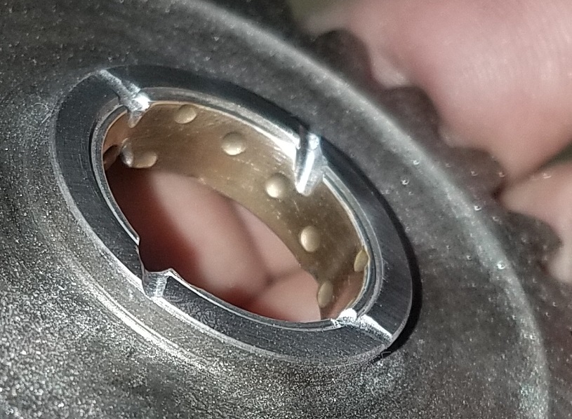

We are also working on a upgrade :o
kx guru racing kx500 86-04 kx500 kick idler gear 102.jpg (221.6 KiB) Viewed 12050 times

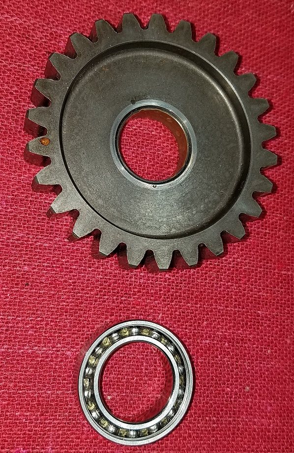

OK, we also found a needle bearing that may work but that is for a later project.
In the mean time Jason and I were talking about how to solve this issue and Jason said that he wondered if one of the trans gears had the same size bushing...
Turns out that yes, first gear has a bushing ID and OD that is exactly the same.
The bushing is a little wider but that is no big deal.

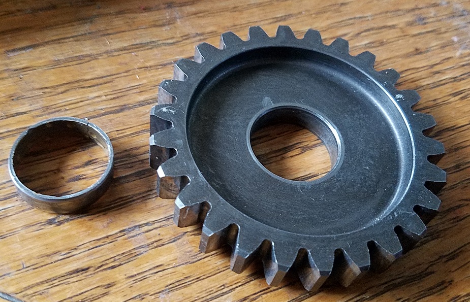

Since I have a bad first gear I measured the ID and guess what? It is right on spec for a new bushing for the Idler gear.
So, I pressed out the bushing.
86-04 KX500 KICK IDLER GEAR NO LONGER AVAILABLE 59051-1150 KX Guru Racing repair 101.jpg
86-04 KX500 KICK IDLER GEAR NO LONGER AVAILABLE 59051-1150 KX Guru Racing repair 101.jpg (243.8 KiB) Viewed 12014 times

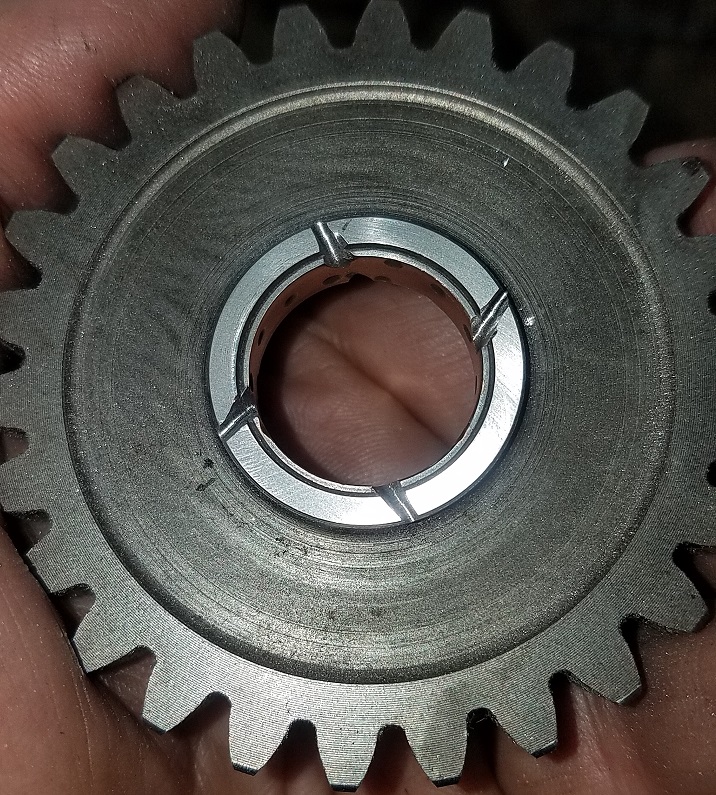

Next, I pressed in the new bushing from the trans into the idler gear.
86-04 KX500 KICK IDLER GEAR NO LONGER AVAILABLE 59051-1150 KX Guru Racing repair 102.jpg
86-04 KX500 KICK IDLER GEAR NO LONGER AVAILABLE 59051-1150 KX Guru Racing repair 102.jpg (207.63 KiB) Viewed 12012 times
As you can see, it's a bit wide but a quick trip to the grinder and sander fixes it up nice.
Also, the bushing is now just a little wider then the stock bushing.

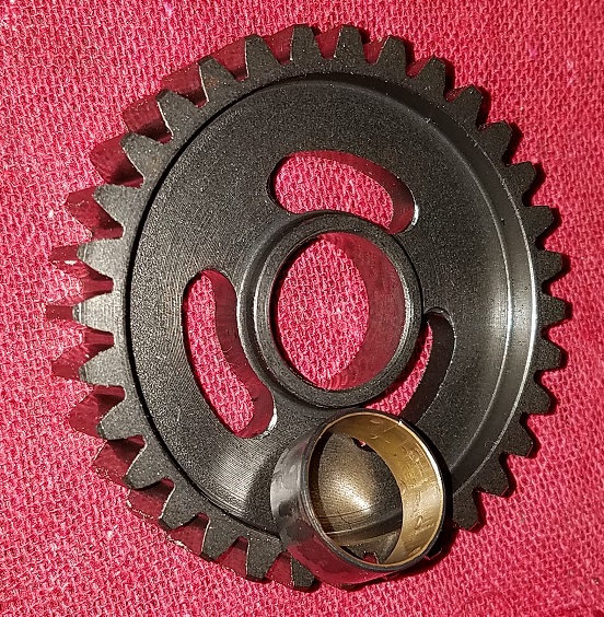

I wondered why the idler gear wears out so much faster then first gear.
Jason and I discussed it and figured there has to be three reasons.
1. The idler gear is narrower and has an even narrower bushing.
2. The idler gear has a lot of side load on it where the trans has a very even load on it.
3. Potentially there is a lack of oil getting to it.
So, I was thinking about this..
86-04 KX500 KICK IDLER GEAR NO LONGER AVAILABLE 59051-1150 KX Guru Racing repair 104.jpg
86-04 KX500 KICK IDLER GEAR NO LONGER AVAILABLE 59051-1150 KX Guru Racing repair 104.jpg (318.29 KiB) Viewed 12010 times
86-04 KX500 KICK IDLER GEAR NO LONGER AVAILABLE 59051-1150 KX Guru Racing repair 105.jpg
86-04 KX500 KICK IDLER GEAR NO LONGER AVAILABLE 59051-1150 KX Guru Racing repair 105.jpg (208.64 KiB) Viewed 12010 times
Maybe... Maybe not :lol:
