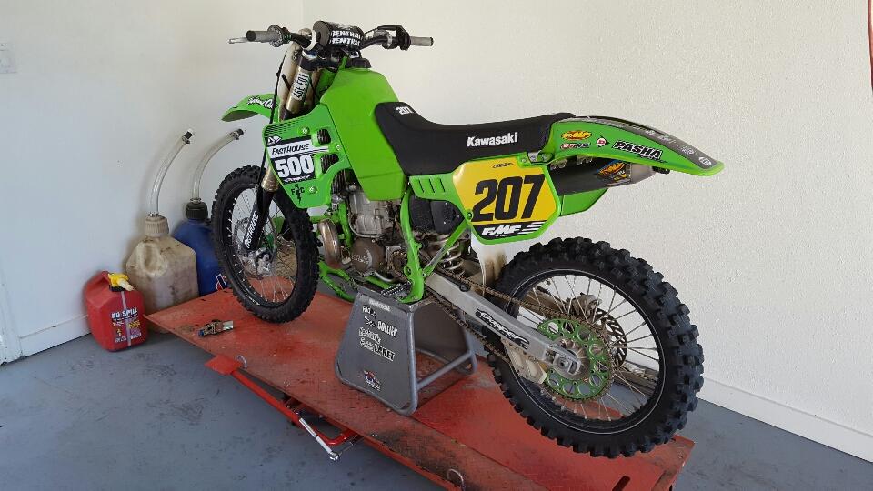

This is the bike that Sean won the Two Stroke National Championship on at Glen Helen in 2015 on.
The tear down is being handled by Oscar.
All the notes and pics provided below are his.
This build is not really a build as much as it is a quick freshen up of the chassis and motor to keep it alive until we get Sean's new bike built.
Here is the beast...

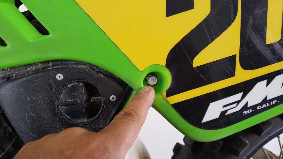

Don't you just love it when you go to take a bolt out and it spins round and round and never comes out?
SEAN COLLIERS KX500 TEAR DOWN 102.JPG (62.08 KiB) Viewed 16763 times

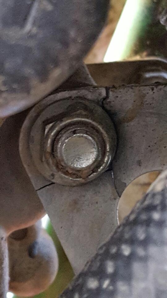

Broken motor mount?
No good, that will cause a lot of undue stress on the frame as well as a lot more chassis vibration.
SEAN COLLIERS KX500 TEAR DOWN 106.JPG (65.37 KiB) Viewed 16761 times

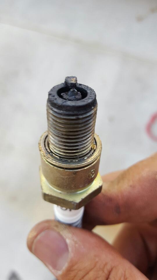

NGK B8EVX Gapped at .024"
SEAN COLLIERS KX500 TEAR DOWN 109.JPG (34.45 KiB) Viewed 16756 times

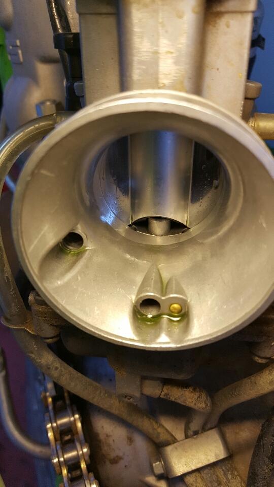

Bare bones stock 97-04 KX500 carburetor.
SEAN COLLIERS KX500 TEAR DOWN 110.JPG (58.45 KiB) Viewed 16752 times
SEAN COLLIERS KX500 TEAR DOWN 113.JPG (56.72 KiB) Viewed 16751 times

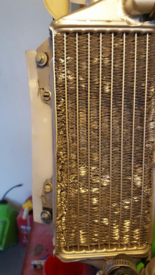

This rad stinks...
SEAN COLLIERS KX500 TEAR DOWN 111.JPG (126.52 KiB) Viewed 16752 times

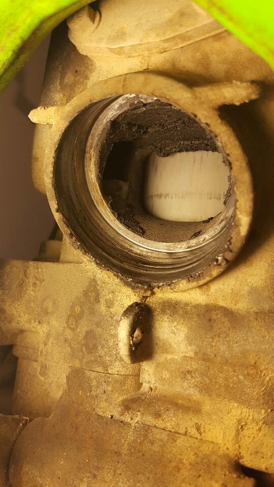

There is something very fishy about that center valve..
SEAN COLLIERS KX500 TEAR DOWN 114.JPG (85.92 KiB) Viewed 16746 times
Yep... It's busted..
SEAN COLLIERS KX500 TEAR DOWN 115.JPG (45.73 KiB) Viewed 16746 times
