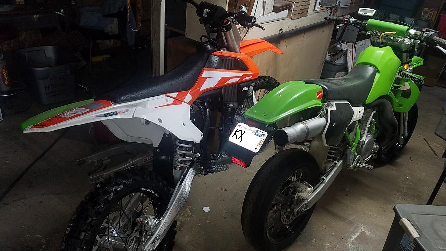

I'm waiting for the owner of this chassis to set up a time to meet.
It is a 2016 KTM 250 SX chassis.
They used the motor for a Kart.
My intention is beat the pumpkin seeds out of it and drop in a woods built KX500 engine :o

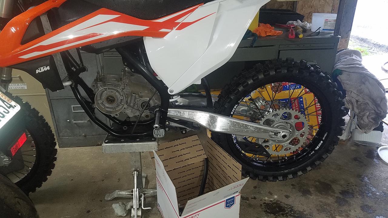

Drove down to Grants Pass and picked it up...
KX GURU RACING.COM 2016 KTX500 BUILD 101.JPG (339.72 KiB) Viewed 23406 times
Posted: Mon Oct 17, 2016 2:43 am
Home at last...

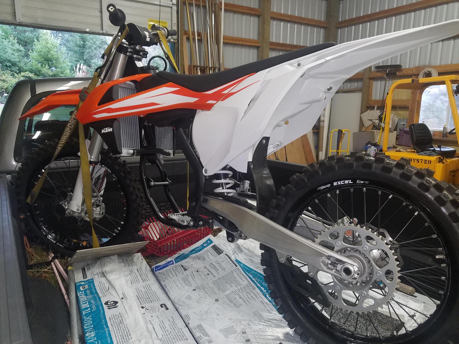

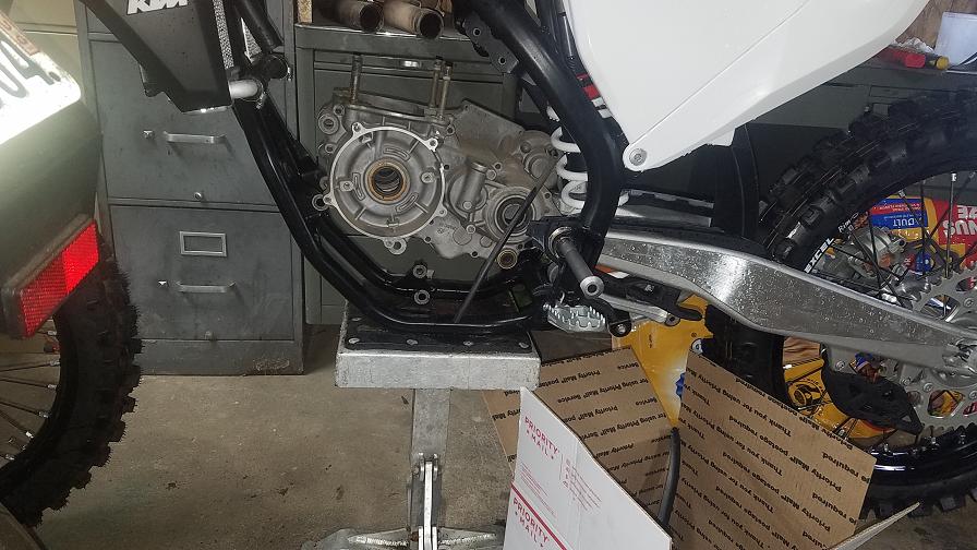

Posted: Mon Oct 17, 2016 2:44 am
It's gonna require a fair amount of cradle modifications to work.
KX GURU RACING.COM 2016 KTX500 BUILD 103.JPG (194.08 KiB) Viewed 23404 times
KX GURU RACING.COM 2016 KTX500 BUILD 104.JPG (107.21 KiB) Viewed 23404 times
Posted: Mon Oct 17, 2016 2:48 am
So what's it gonna take?
First off you need your swing arm pivot pin hole in your KX500 cases drilled to 17mm.
Check! I still have my mock up cases for a AF project..
Then the engine mounts on the KTM frame have to be removed just so I can tilt the engine forward enough to see what all I need to do to the cradle..
More to come..

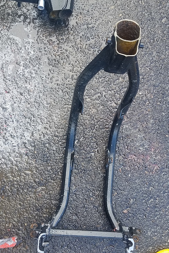

Here is a 2007 KTM 450F frame.
That would be a very easy conversion... But I'm not into easy... I guess :lol:
KX GURU RACING 2016 KTM 250SXF KX500 CONVERSION 101.jpg (212.23 KiB) Viewed 23154 times
KX GURU RACING 2016 KTM 250SXF KX500 CONVERSION 102.jpg (340.24 KiB) Viewed 23154 times
Since I have this frame I think I will cut it up and use the cradle :o :shock: 8-)

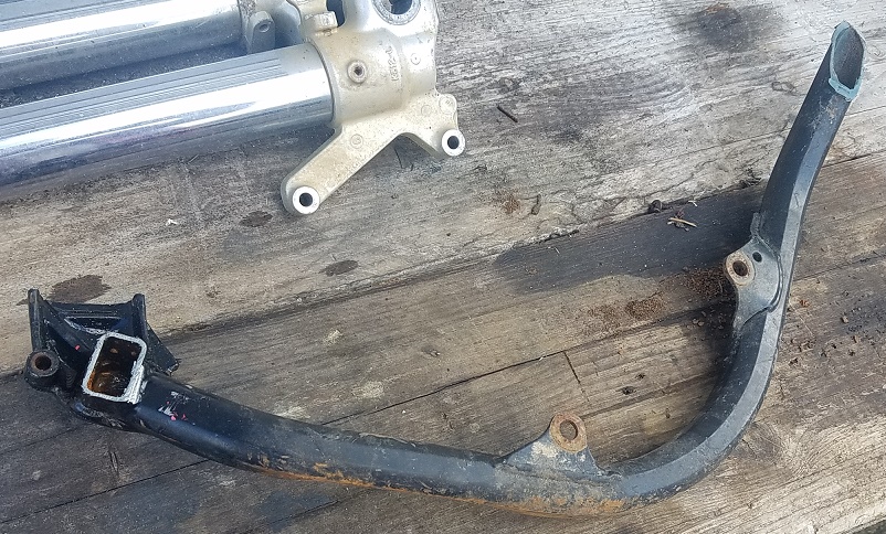

Posted: Thu Mar 23, 2017 3:12 am
I've got one side free'd up...
KX GURU RACING 2016 KTM 250SXF KX500 CONVERSION 104.jpg (254.62 KiB) Viewed 23142 times
Posted: Fri Mar 24, 2017 12:55 am

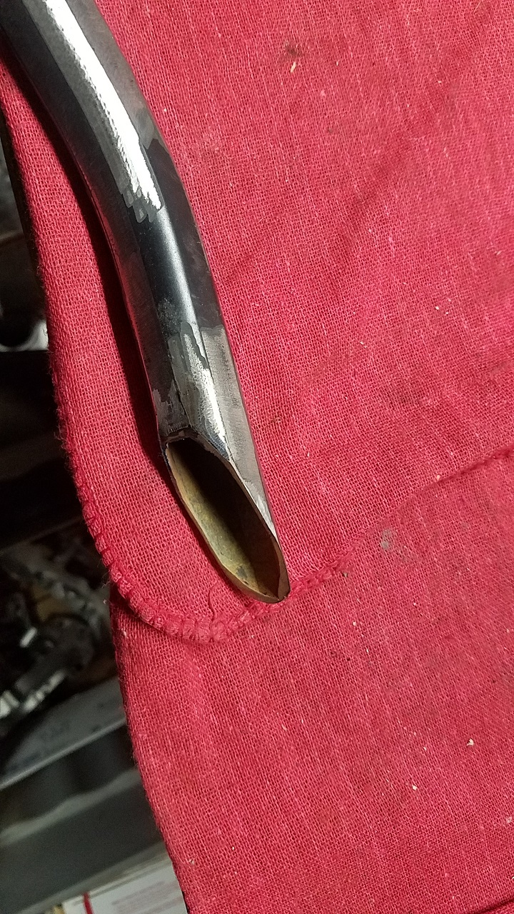

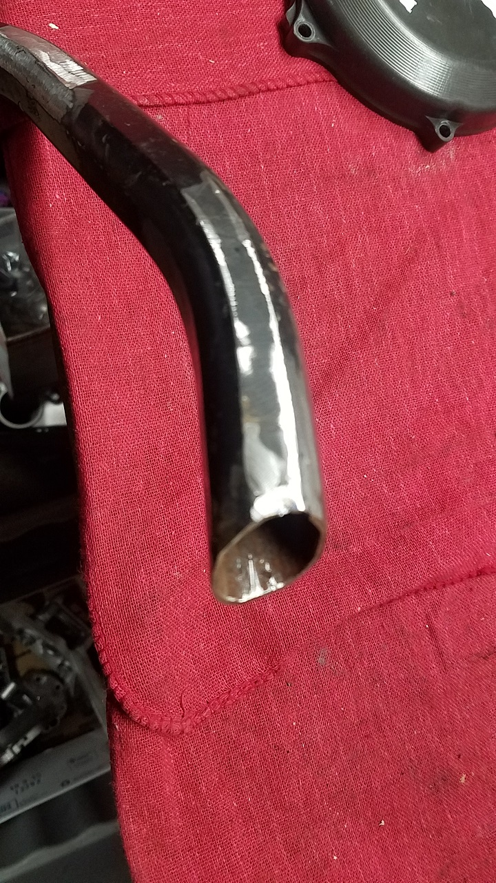

Ok... I did the rough work and Jason came in and did some more clean up.
We are being very careful to remove as little material as possible.
These tubes are thin and we don't want to weaken them and more then required..
