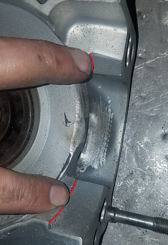

Here is where the piston will hit the cases.
kx500 92mm piston.jpg (274.52 KiB) Viewed 15629 times

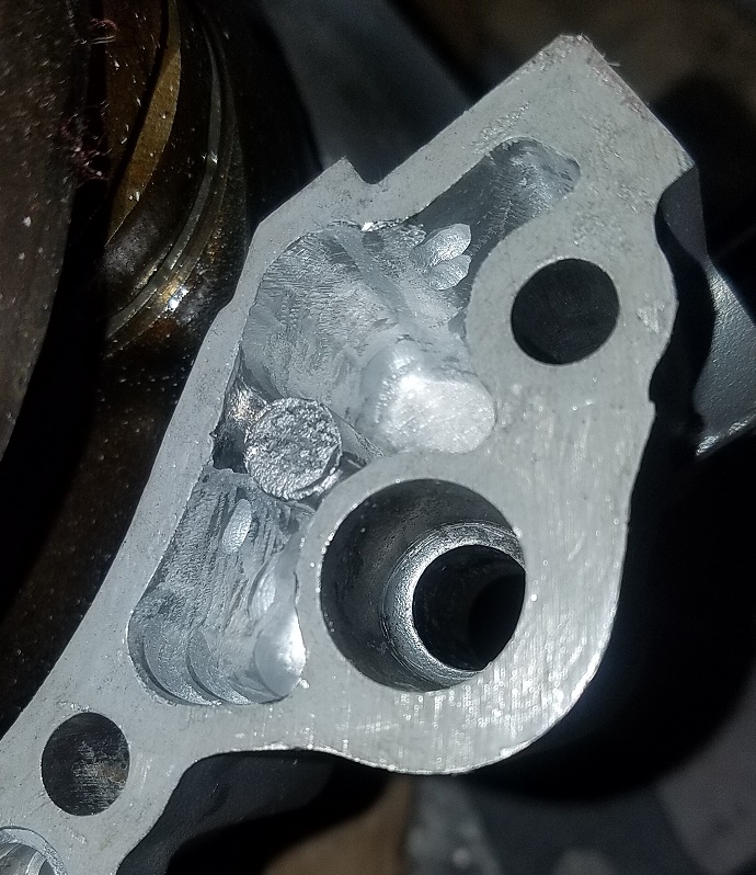

Another issue is this cavity...
Once you machine enough to clear the sleeve you will open your crank volume into this cavity..
KX Guru Racing 92mm kx500 piston mod 104.jpg (401.32 KiB) Viewed 15629 times
KX Guru Racing 92mm kx500 piston mod 106.jpg (215.39 KiB) Viewed 15629 times

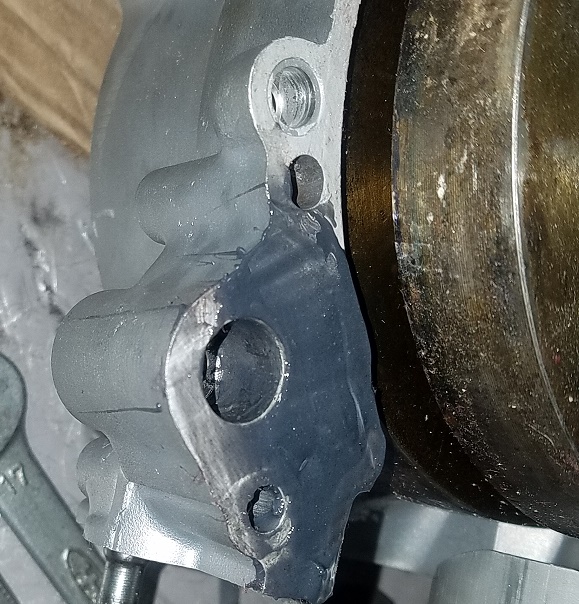

Some of you know how much I despise this stuff but the alternative is a lot of machining and then welding and this is so much easier.
And remember, it's just there to take up space... it does not have to handle any pressure...
Despite the fact that it is nothing more then a volume filler I want to be sure that it will stay put... Not that it could go anywhere... :lol:
I went ahead and cleaned the area very well then added some divots for the filler to cling to..
KX Guru Racing 92mm kx500 piston mod 105.jpg (232.81 KiB) Viewed 15628 times
You can't mess up the proportions of the hardener... you open the cap and squeeze the plunger... it comes out evenly..
Just be sure to mix it thoroughly.... Then apply...
KX Guru Racing 92mm kx500 piston mod 108.jpg (298.23 KiB) Viewed 15628 times
See that little space that did not get filled... uhoh....

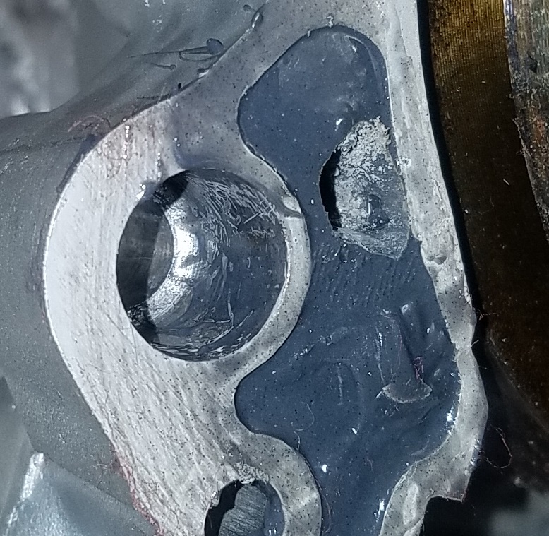

Re: 92mm KX500 piston right here :-)
Because I didn't get the filler in the cavity evenly I had a hole that was bigger down below then it was on the surface.
So out came the porting tool and I made sure I could get to the bottom of the cavity...
KX Guru Racing 92mm kx500 piston mod 110.jpg (275.91 KiB) Viewed 15627 times
More mixing and applying...
This time I used a zip tie to make sure the filler went clear to the bottom...
KX Guru Racing 92mm kx500 piston mod 111.jpg (271.88 KiB) Viewed 15627 times
I think it's better this time around... :D
