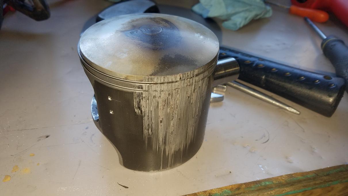

You don't want to run the carb low on fuel...
Here is what can happen faster then you will believe..
JT ENGINE WORKS 89 CR500 CART ENGINE BUILD 138.JPG (91.15 KiB) Viewed 13921 times
