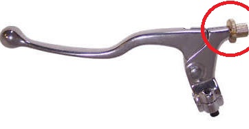

How is the adjustment on your clutch perch?
clutch perch.jpg (11.28 KiB) Viewed 11499 times
If it's all the way in as in this pic, try adjusting it out a bit.

There was no adjustment on the clutch perch. That solved the sloppiness in the cable. Just realized this afternoon that there was an adjustment underneath the rubber boot. ;)

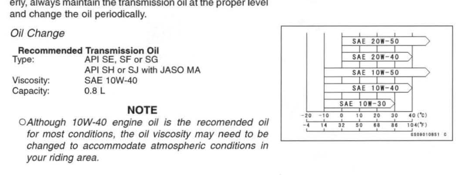

As far as the trans oil, it's running ATF right now. The previous owner stated that he was having some sort of issue with the kickstart "lever" returning to it's correct position. After changing the spring in the case with no change in behavior, he went out to some forums and found that people were suggesting ATF to remedy the problem. He said that since he began running ATF he hadn't had anymore problems with the kickstart "lever" returning to it's starting position.
After reading around on this forum some, I think I might switch to royal purple, but I'm not certain which viscosity to use. Based on the chart out of the repair manual it looks as if I could use 10-W30 or 10-W40 for my region - Central Texas - where ambient temperatures can be in the high 90s to low 100s for days.

Yes, 10-40 is what you need.
I will probably change to Royal Purple in the near future just to try it out.
I have ran ATF when I used to use a different oil.
I would run it every now and again to help with cleaning out the gear box.
And it does a great job of that.
But I would not recommend running it all the time.
One of the problems you described closely resembles what happens when you use straight ATF... Sticky plates... When cold...
