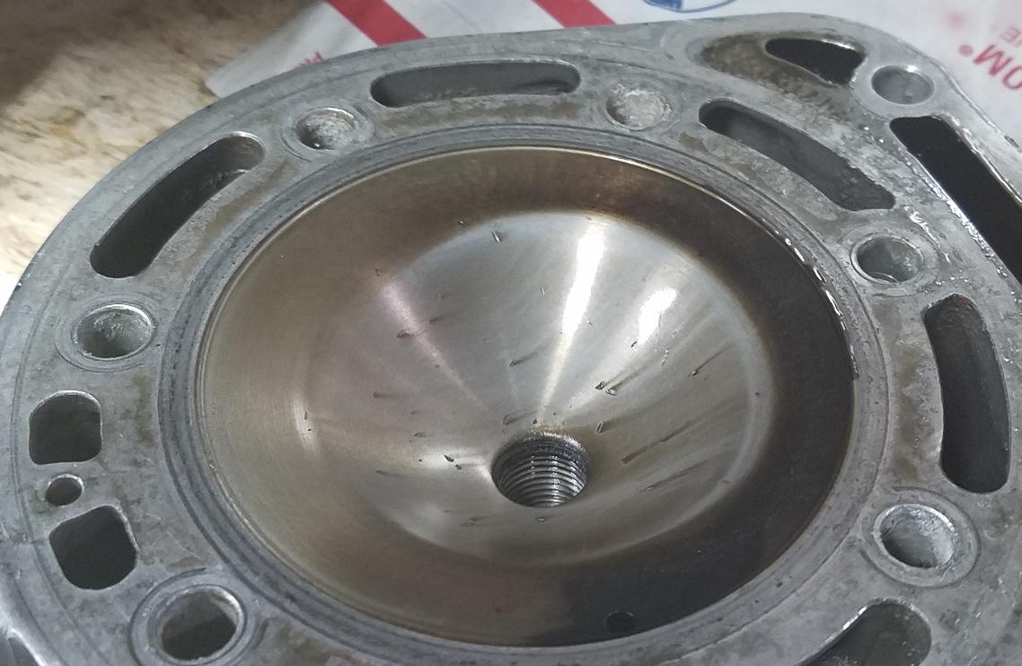

Recorded the head squish

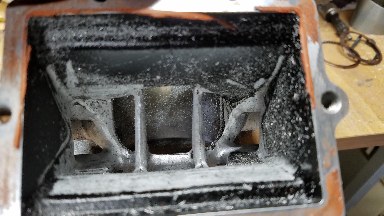

Gonna need some new reed pedals..

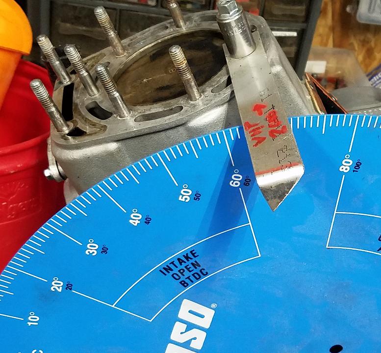

Measure and record the ports.... All stock.... Ignore the reading on the wheel :-)

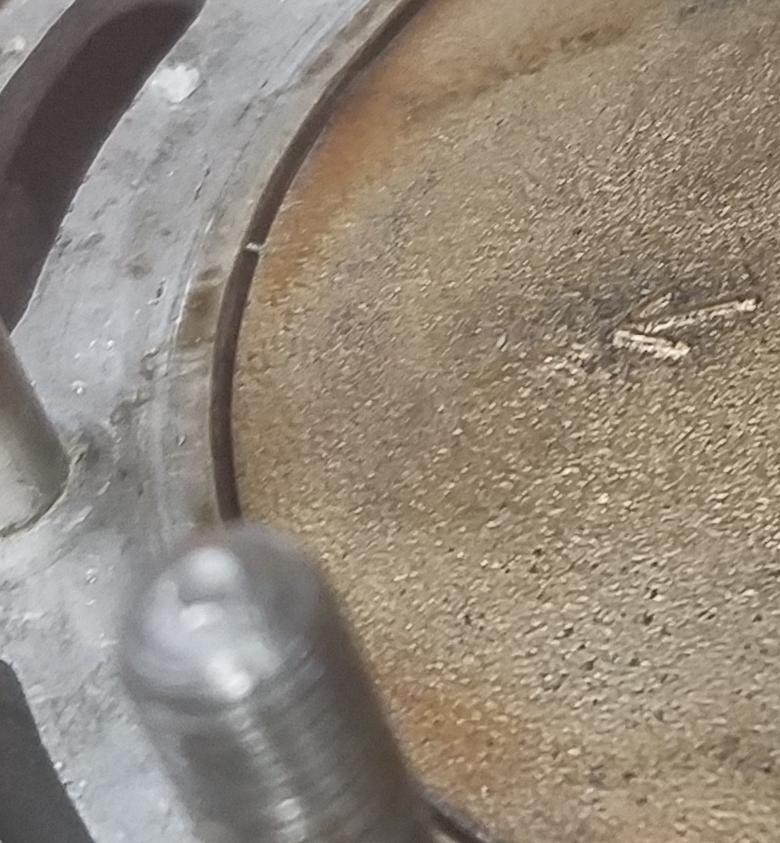

The piston is a bit buggered up...
Re: 2002 KX500 Kawasaki engine rebuild for Greg
Unfortunately the piston wall is getting thin and it's got a dink in it.....

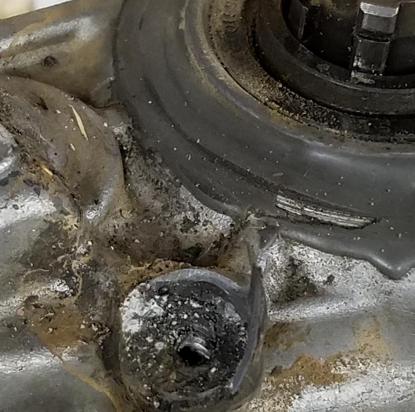

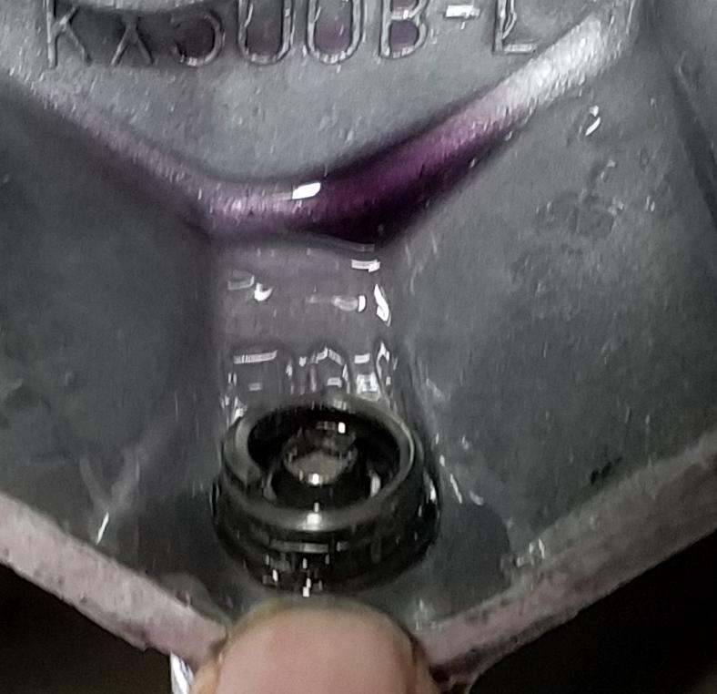

Helicoil drain plug... We may have to fix this..

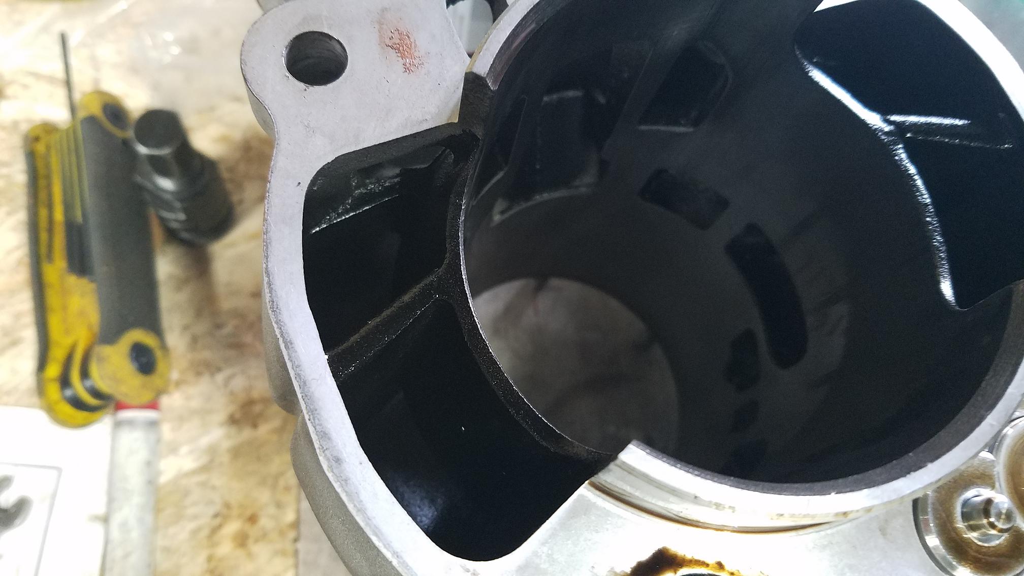

Hmmm, I'm not certain what balance factor they were shooting for but these holes are a no go..
JT Engine works kx500 rebuild 116.JPG (117.32 KiB) Viewed 12955 times
It's a shame that this top end has very little time on it and for some reason it has some issues..
JT Engine works kx500 rebuild 117.JPG (235.44 KiB) Viewed 12955 times

Nice, clean, stock cylinder
JT Engine works kx500 rebuild 118.JPG (151.25 KiB) Viewed 12955 times
I'll fix that :o Got some roughing work to do..
JT Engine works kx500 rebuild 119.JPG (204.8 KiB) Viewed 12955 times
JT Engine works kx500 rebuild 120.JPG (217.56 KiB) Viewed 12955 times
JT Engine works kx500 rebuild 121.JPG (289.74 KiB) Viewed 12955 times
I finished the porting at about 12:30 this afternoon and got it shipped to Millennium Tech for plating... Oh yeah! :D
No, these pics are of the roughing work, not the finished cylinder :geek:

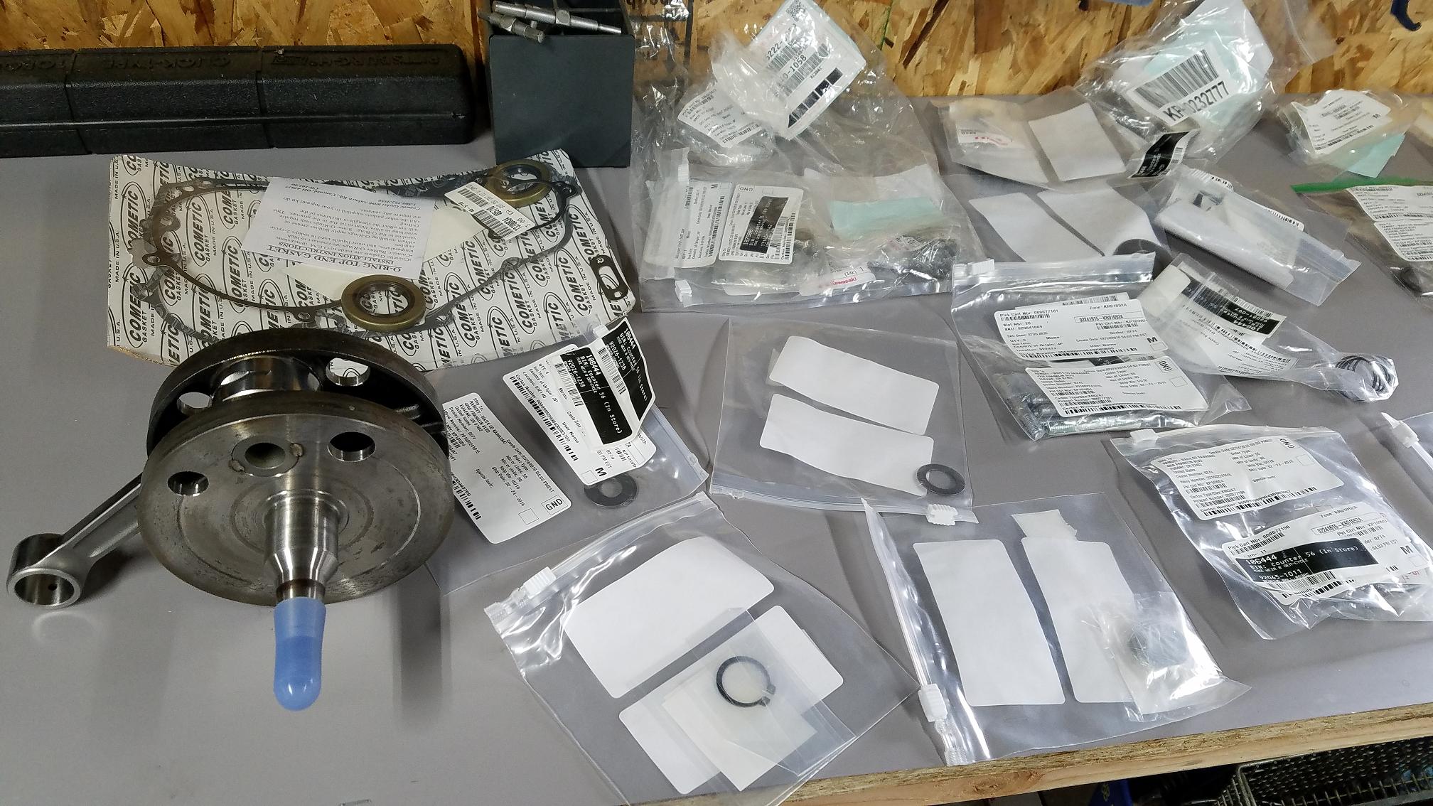

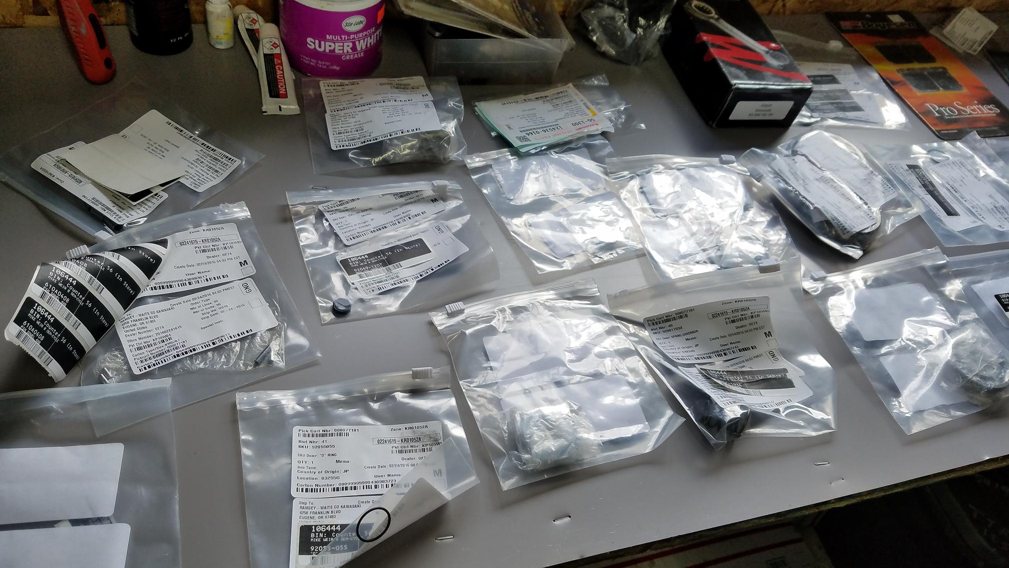

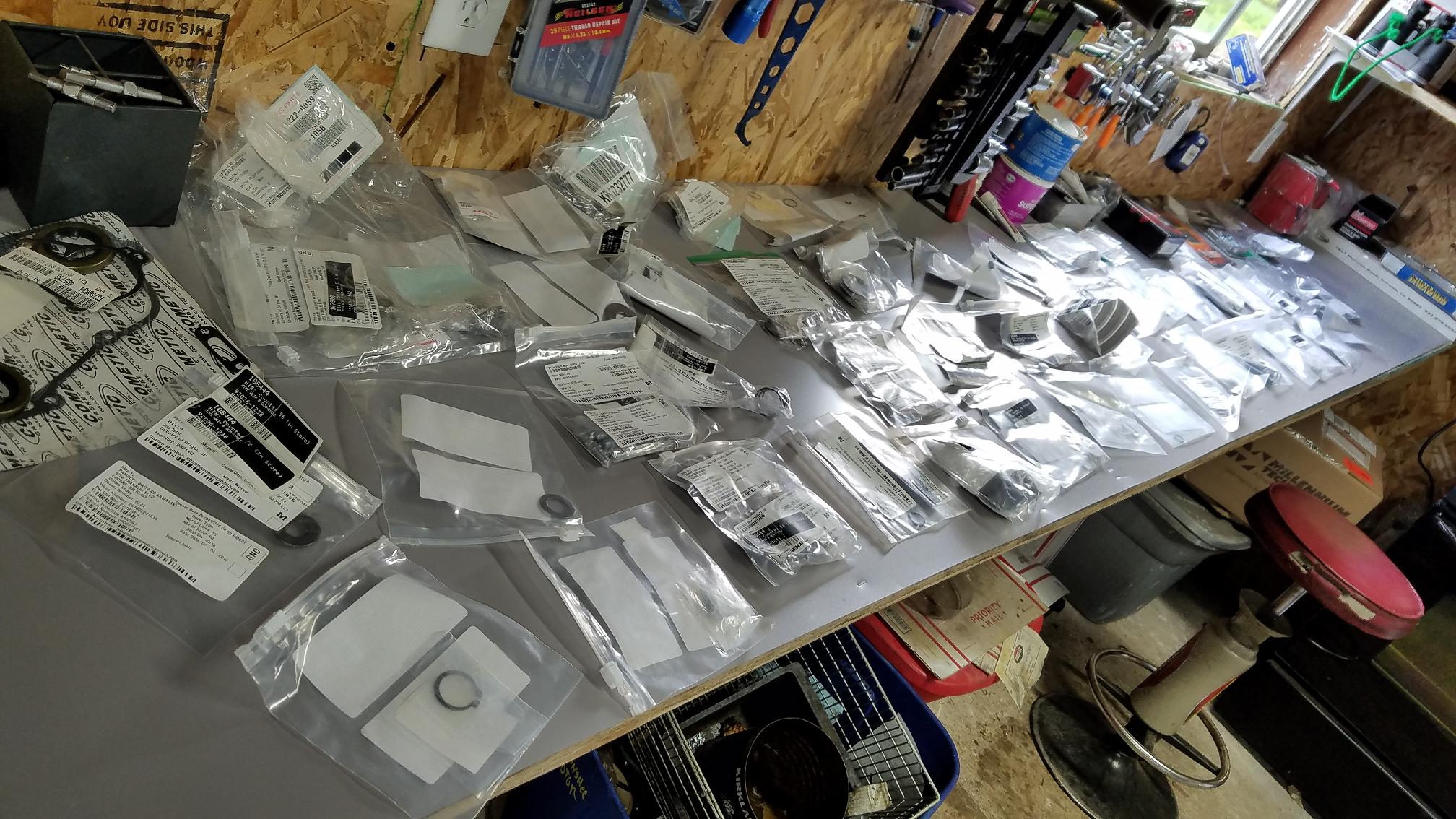

When a customer send Jason his engine for a rebuild, this gives you an idea of what all he orders before work even begins
JT ENGINE WORKS KX500 BUILD FOR GREG 101.JPG (410.38 KiB) Viewed 12899 times
JT ENGINE WORKS KX500 BUILD FOR GREG 102.JPG (384.64 KiB) Viewed 12899 times
JT ENGINE WORKS KX500 BUILD FOR GREG 103.JPG (288.51 KiB) Viewed 12899 times
JT ENGINE WORKS KX500 BUILD FOR GREG 104.JPG (326.11 KiB) Viewed 12899 times

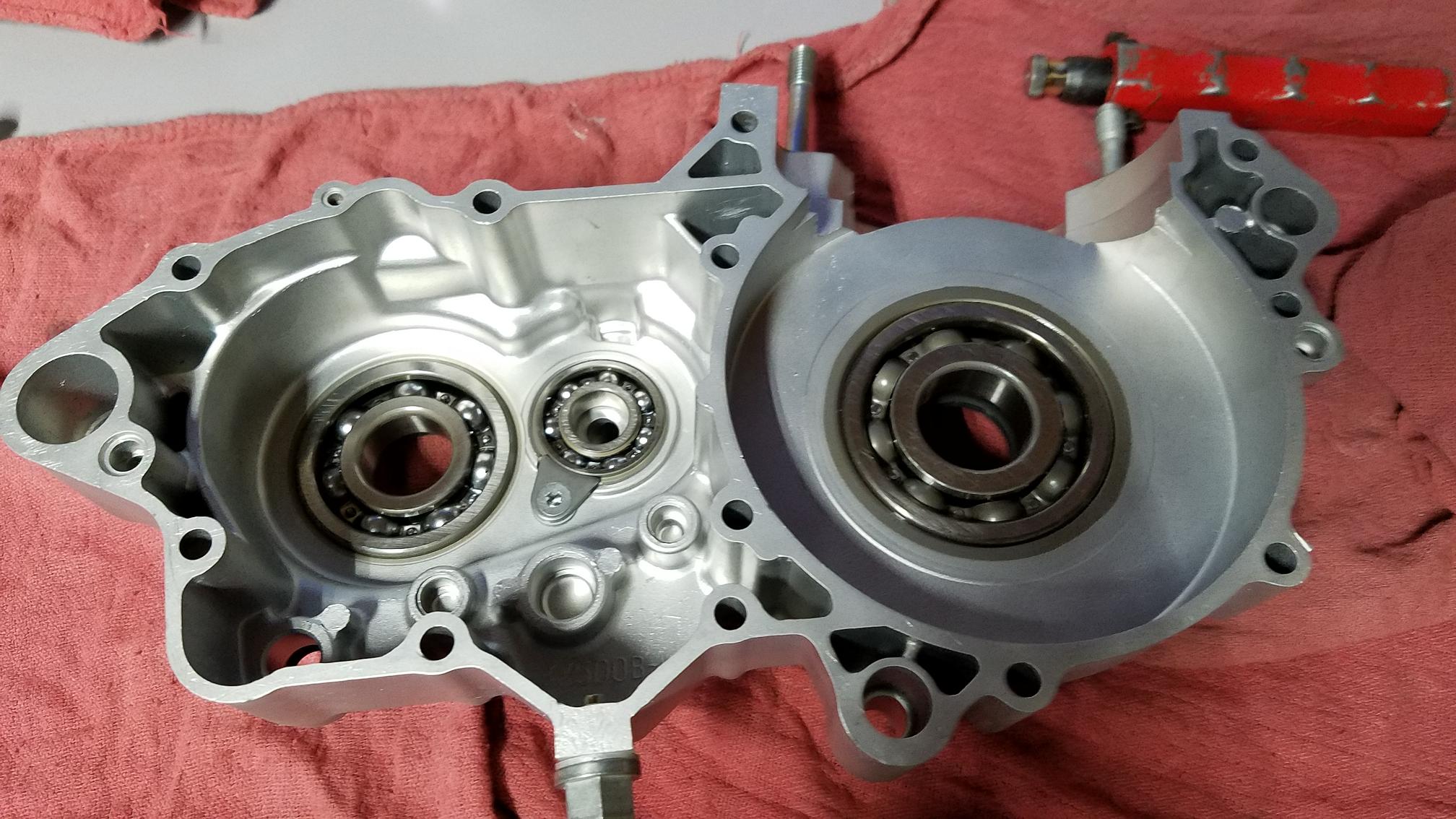

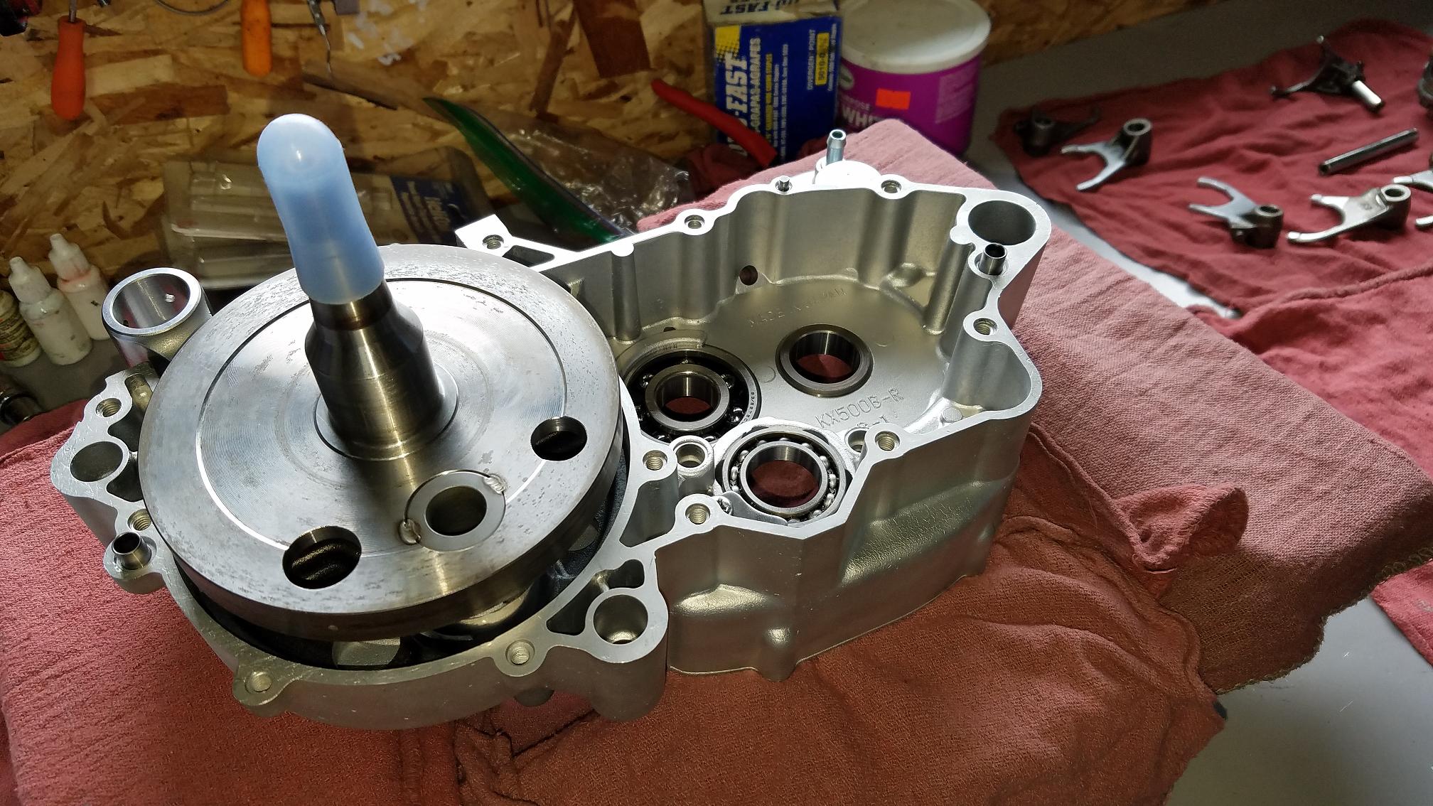

All the lapping, case matching, and case port mods are done and the engine is ready for assembly.
JT ENGINE WORKS KX500 BUILD FOR GREG 105.JPG (319.01 KiB) Viewed 12897 times
JT ENGINE WORKS KX500 BUILD FOR GREG 106.JPG (331.86 KiB) Viewed 12897 times
JT ENGINE WORKS KX500 BUILD FOR GREG 107.JPG (407.68 KiB) Viewed 12897 times
JT ENGINE WORKS KX500 BUILD FOR GREG 108.JPG (403.7 KiB) Viewed 12897 times
