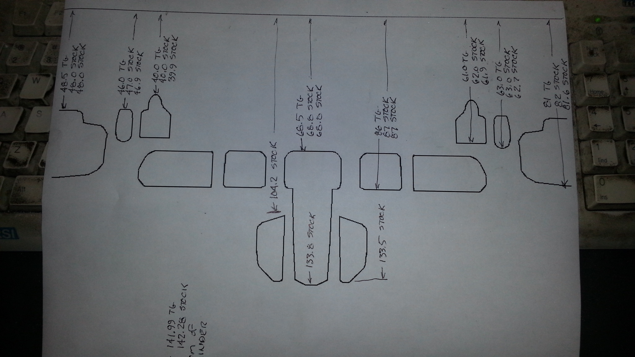

What I did was measure two stock cylinders and compared to a Team Green cylinder.
Basically there wasn't much special about the Team Green cylinder.
And the exhaust port was lowered from the stock specs :o
The clean up of the transfers, bridges, boost ports, and floor ports was crude and nothing special....
