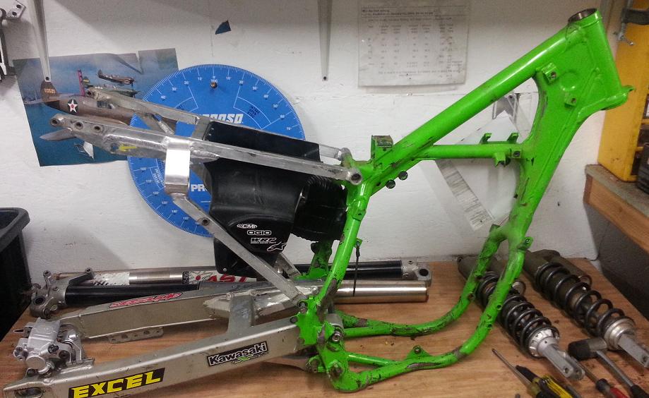

I caught that and replied the following:
It just so happens that I have a 88 frame and a newer swing arm with linkage that I could try it on.
I believe that you can use the 88 frame but you would need to use all the newer suspension from the 98, not just a shock.
IE swing arm, linkage, rear brake caliper and mount, shock, and possibly sub frame.
The 88 k5 shock has a single mounting post whereas the 89-04 k5 used the H shaped clevis.
More tomorrow.
In the pic I used a 96 frame.
I will pull the 88 and swap everything over.
Re: Difference in frame shock mounting
Posted: Fri Dec 11, 2015 8:57 pm
Ok, here is a 1988 KX500 frame, 96-02 swingarm, 91-02 sub frame, 96-03 rear caliper caliper, 96-04 Rear caliper mount, 90-04 shock brackets, 90-04 shock /swingarm linkage Uni trak... Whatever :lol:
1988 KX500 WITH 2004 SWINGARM SUB FRAME LINKAGE REAR BRAKE.JPG (86.75 KiB) Viewed 10756 times

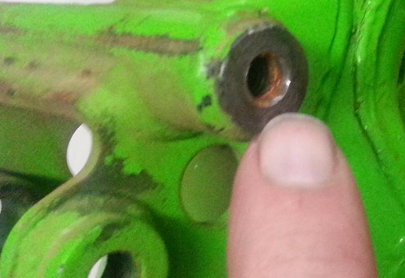

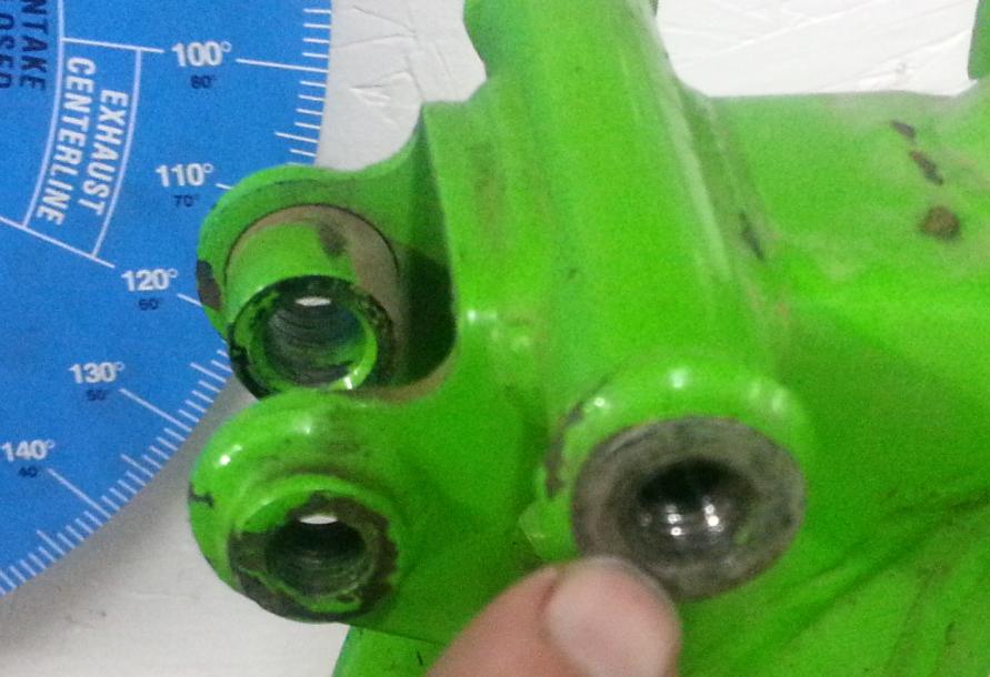

So far the only difference I have found it the upper sub frame bolt.
On the 1988 it is a lot smaller thread size then on the 96.
1988
1988 KX500 SUB FRAME UPPER BOLT.JPG (50.97 KiB) Viewed 10756 times
1996
1996 KX500 SUB FRAME UPPER BOLT.JPG (65.5 KiB) Viewed 10756 times

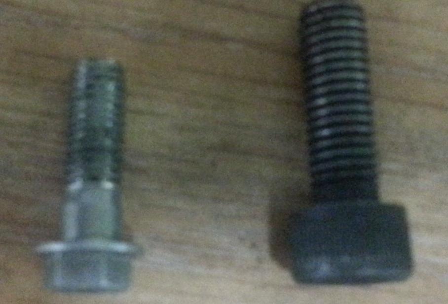

Bad pic but you can clearly see the thread size difference
1996 VS 1988 KX500 UPPER SUB FRAME BOLT.JPG (53.02 KiB) Viewed 10756 times
