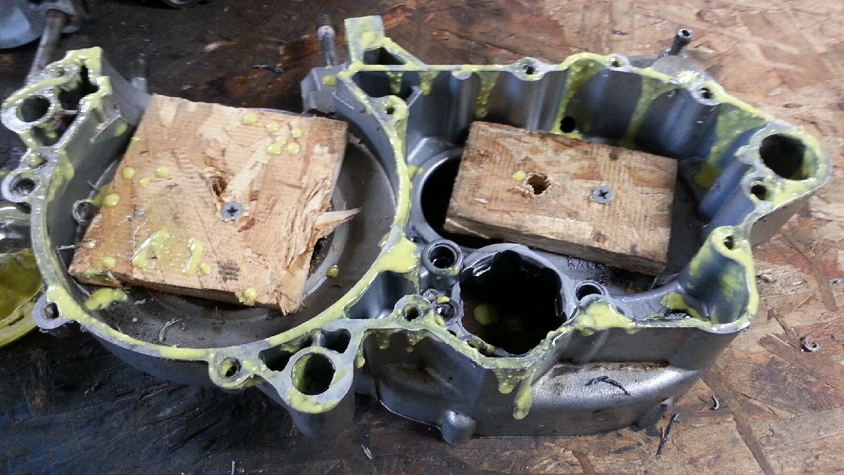

Ok.. prepping the cases for repair and case lapping..
Note the broken counter sprocket bolt tower :cry:
Here is what we are starting with
Re: 1999 KX500 KAWASAKI ENGINE BUILD FOR KEVIN

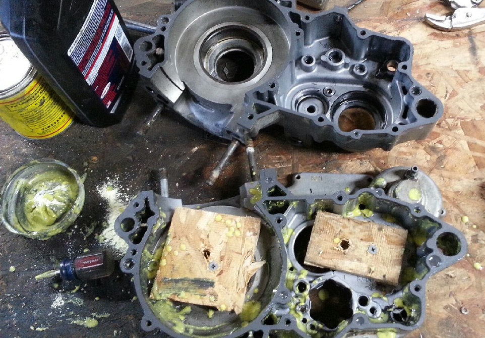

Dirt things first, gotta remove all the bearings, seals, and bearing retainers..
Shish Kebab!!!
When lapping you can have your buddy hold the cases for you or.....
Timesaver is the best stuff out there for lapping aluminum..

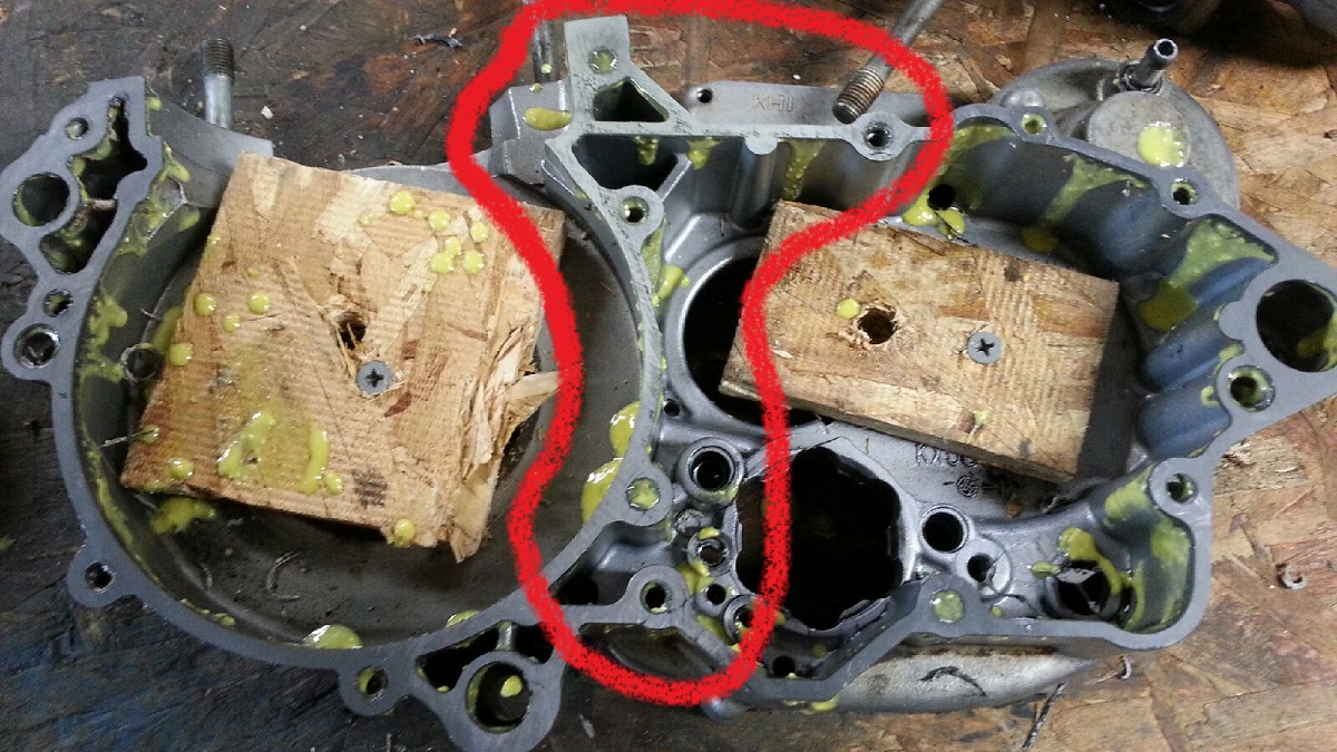

Gotta get the Timesaver on the entire surface
This is the typical trouble area for KX500's... Note where the dark grey is around the edges of the cases.
Then look at the yellow area.
The yellow area means that the cases have a gap there.
So rub rub rub... swirl swirl swirl... rub rub rub... swirl swirl swirl... rub rub rub... swirl swirl swirl... rub rub rub... swirl swirl swirl...
Now they are dark grey all around which means they are ready for clean up, porting, and repair,,
