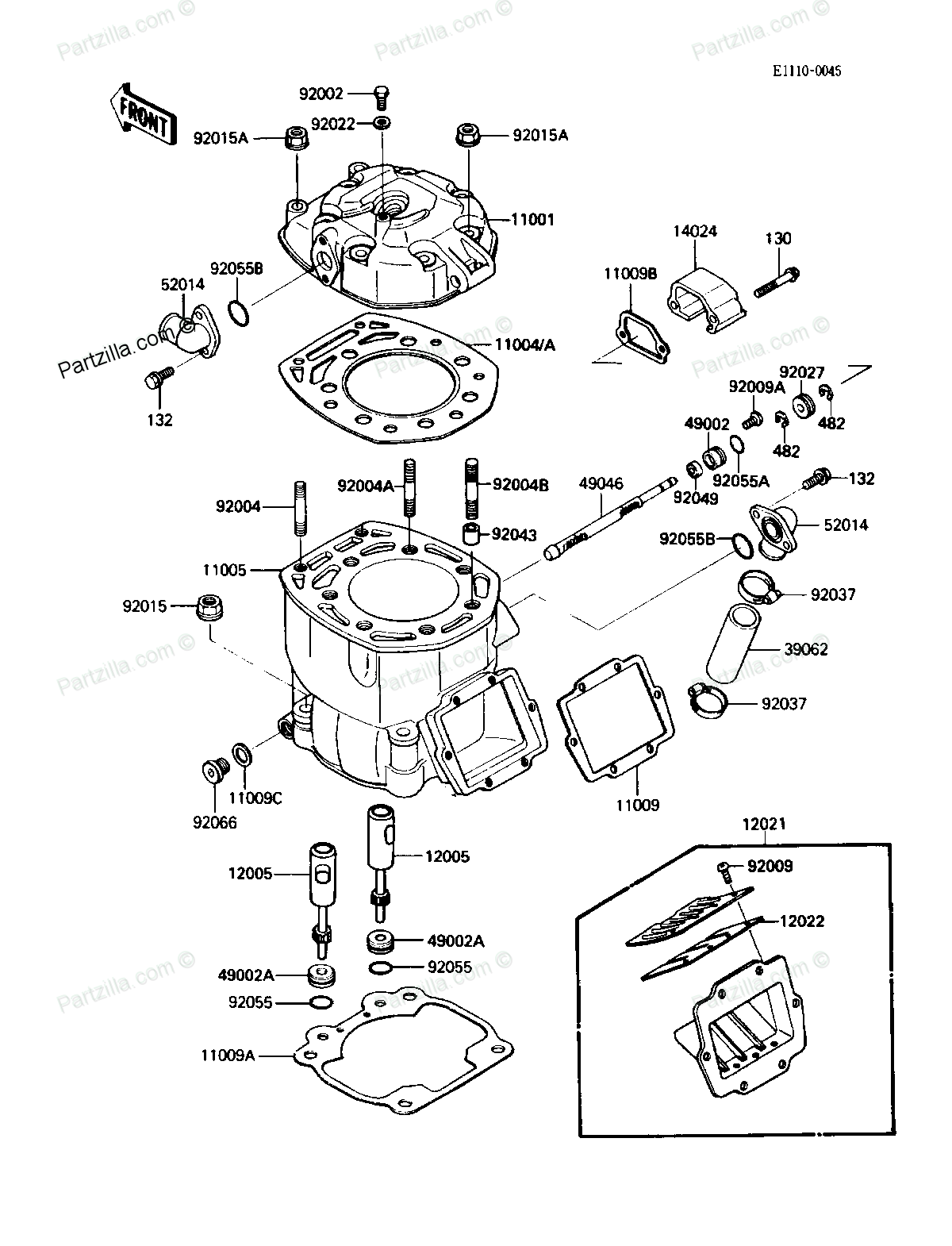

First, look at the diagram..
1988 kx500 cylinder.png (104.72 KiB) Viewed 14154 times
If you haven't already, remove the right governor cover 14024-1611
Then remove CIRCLIP-TYPE-E,4MM 482J4000
Next remove COLLAR,GOVERNOR ROD 92027-1834
Then remove the other CIRCLIP-TYPE-E,4MM 482J4000.

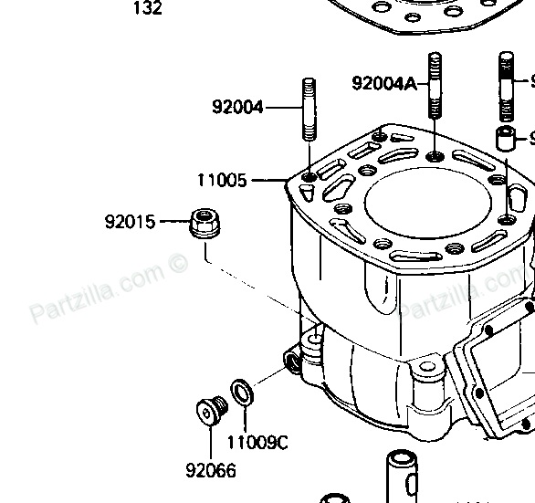

Now remove PLUG,12X10 92066-1222
Then remove GASKET,12.5X18X1,DRAIN PLUG 92065-073 or 11009C
The ROD-GOVERNOR 49046-1057 will not come out yet because it is still meshing with the exhaust valves 12005-1080.

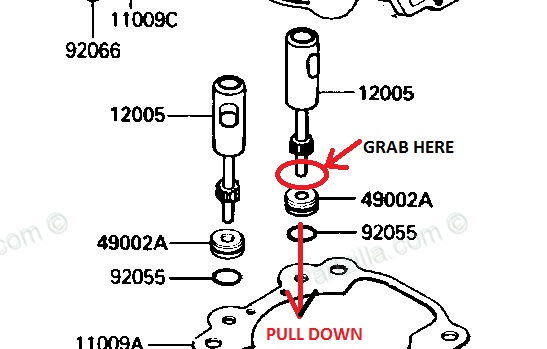

Grab on to the bottom of the exhaust valve and pull the valves down about 1/4"
If you have aluminum valves BE CAREFUL AS THEY WILL BREAK EASILY

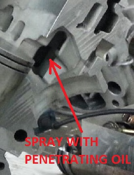

If they don't pull down easy, STOP, squirt the valve heavily with a good penetrating oil.
Be sure to squirt both valves not from the bottom but into the exhaust port as shown below

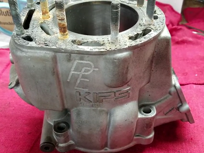

This was a impromptu example of how to remove your kx500 exhaust valves when they are stuck :o
kx500 valves.png (259.82 KiB) Viewed 13039 times
