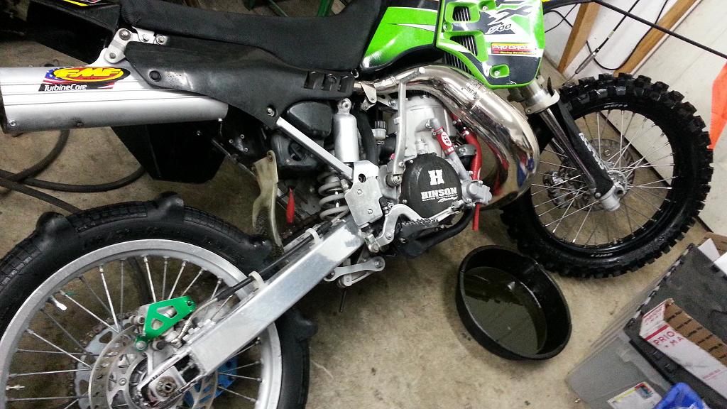

Next lay your bike on it's side... No... Don't drain the oil first..
You will be using your old oil to help flush the engine...
OEM-CYCLE.COM KX500 DRAIN PLUG REPAIR 101.JPG (160.64 KiB) Viewed 33702 times
Now remove the drain plug but be prepared for a little more oil to come out depending on how far the bike is laid over.

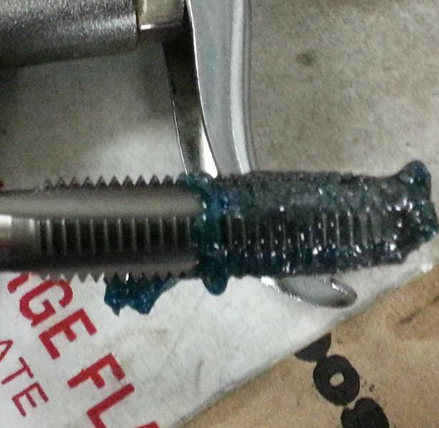

Did I mention you need one of these? Oops!
OEM-CYCLE.COM KX500 DRAIN PLUG REPAIR 102.JPG (58.4 KiB) Viewed 33701 times
This is for a KX500 and most of Kawasaki's Dirt bikes use the same thread size which is a M10 x 1.5
You will also need some grease, and a 13/32" drill bit or .406" or about a 10MM, and some thread locker.

You may want to double check your drill bit size to be sure it is accurate.
This one is close enough:

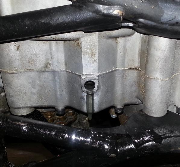

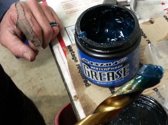

So now all the oil is drained out that is going to come out.
Wipe it off and get your drill ready.
Take the drill bit and apply a liberal amount of grease to the end of it.
This will help prevent or greatly reduce any aluminum chips from getting into your engine case.
OEM-CYCLE.COM KX500 DRAIN PLUG REPAIR 106.JPG (41.23 KiB) Viewed 33701 times

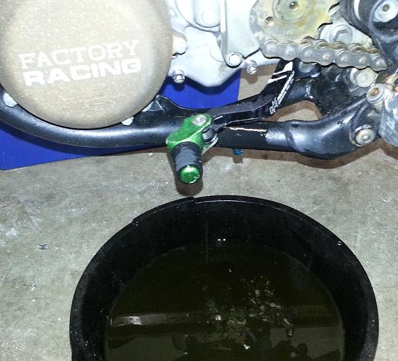

Next, holding one finger over the drain hole, have a buddy lift the bike back straight up.
Have the oil pan under the bike and release your finger.
Your old oil will now come out helping to clear out any debris that may have been left inside.
I actually had some partial bottles of ATF that I dumped into the cases and let that drain through as well.

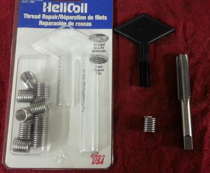

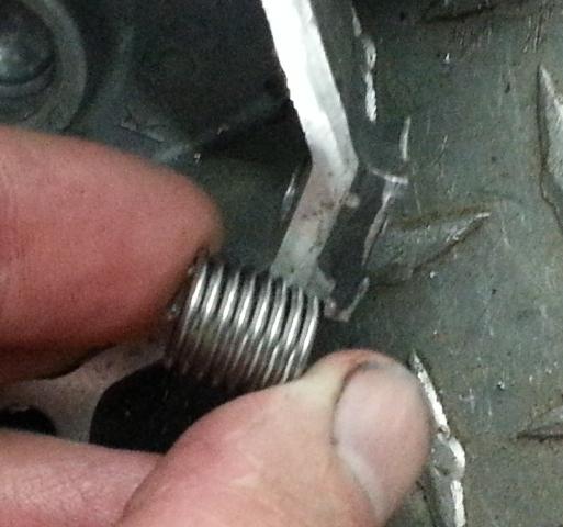

Pre test the length of your Helicoil.
They are a bit longer then required on the KX500..
OEM-CYCLE.COM KX500 DRAIN PLUG REPAIR 110.JPG (33.11 KiB) Viewed 33701 times

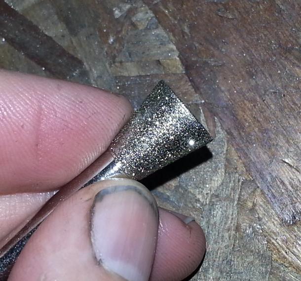

I like to pre cut mine to size but you can screw the Helicoil in and then gring it to size or use a pair of dikes to cut it.
I happen to have a diamond cutting tool for my porting tool so it works very nicely.. 8-)
OEM-CYCLE.COM KX500 DRAIN PLUG REPAIR 111.JPG (63.11 KiB) Viewed 33701 times

I know this is an old thread, but dude, your hand!! :o
That looks like stitches were in order...(I was looking for a "passing out" emoji :lol:
Re: How to fix your drain plug without splitting your cases
Posted: Sun Mar 12, 2023 2:21 am
Lol...
Yeah, stitches should have been done but... I was busy so, tape it up and call it good.... :lol:
