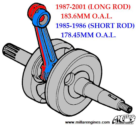

1985-1986 CR500 short rod 178.45mm Over all length
1987-2001 CR500 long rod 183.6mm Over all length
Thanks Adam!
Adam Millar's CR500 Connecting Rod Length Comparison
