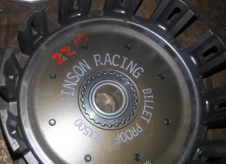

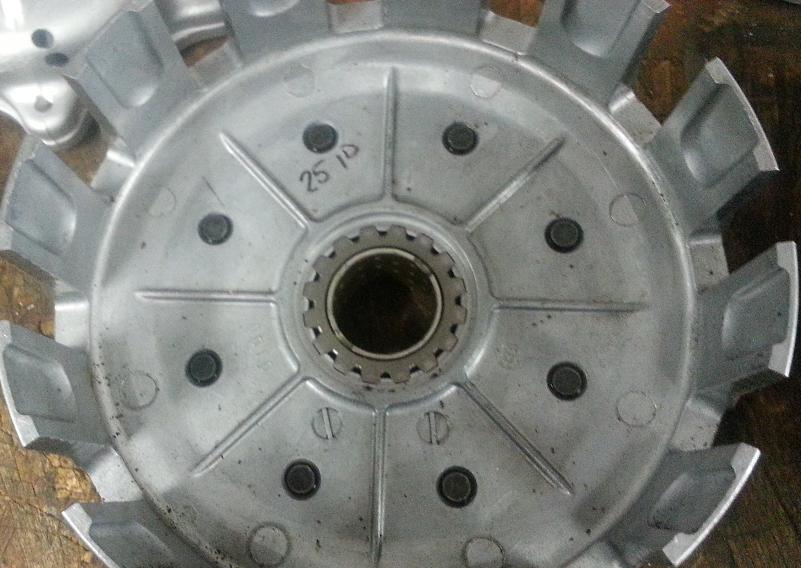

Right off the bat, the KX450F basket which is on the left has a much smaller bearing hole then the KX500 Hinson basket on the right.
However, when you drop the bearing and the collar into the center bearing hole of the KX500 basket, the KX500 Basket has a smaller hole size.
The KX450F ID measures 25mm

The KX500 ID measures 22MM

Here is a pic of the KX450F basket.
The mounting bolt hole circle is 8 bolts on a 93MM bolt circle.
Also, the basket diameter is 157mm.

The KX500 mounting bolt hole circle is 8 bolts on a 96MM bolt circle.
Also, the basket diameter is 153mm.
