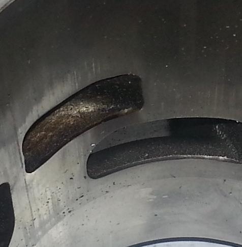

I always wanted to try this but never had the correct tools to try it.
Now that I dumped a wad of cash at CC Specialties I'm ready to give it a go.
While this is a practice cylinder I don't want to ruin it as there is some interesting plans for it... :shock:
Test subject
KX500 AUXILLARY EXHAUST PORT WALL REMOVAL WWW.OEM-CYCLE.COM 101.JPG (29.17 KiB) Viewed 7121 times

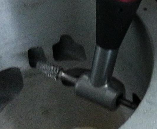

Here's goes nothing...
KX500 AUXILLARY EXHAUST PORT WALL REMOVAL WWW.OEM-CYCLE.COM 102.JPG (26.35 KiB) Viewed 7121 times

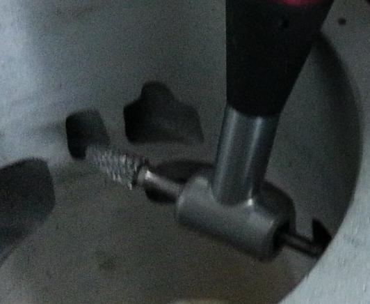

Making progress
KX500 AUXILLARY EXHAUST PORT WALL REMOVAL WWW.OEM-CYCLE.COM 103.JPG (13.57 KiB) Viewed 7121 times
