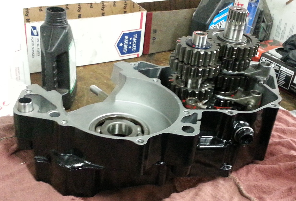

The list of parts replaced is more then I want to type out :shock:
I'll just say that this is more then piston and crank kit rebuild ...
First off many of the trans gears were so worn it was amazing that they worked at all.
The first big hurdle was finding another trans as most of the gears are not available new from Honda.
One was purchased off of eBay and it was junk so it went back to the seller for a full refund.
So Jason (The engine builder) and I sat down and figured out what all gears to to be replaced to upgrade to the 97 transmission.
Yes, the shafts are the same....
So, a bunch of gears were ordered from Honda.
Before anything was done we cleaned the cases in the extreme, painted them with VHT engine paint and baked the cases.
Then assembly was started..

All new bearings, seals, bushings, spacers, snap rings, ect.

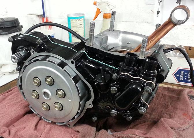

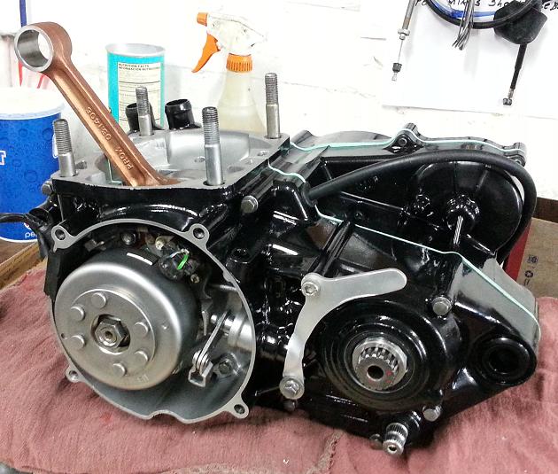

More assembly..
CR500 ENGINE ASSEMBLY WWW.OEM-CYCLE.COM 101.JPG (69.54 KiB) Viewed 10110 times
CR500 ENGINE ASSEMBLY WWW.OEM-CYCLE.COM 102.JPG (69.26 KiB) Viewed 10110 times

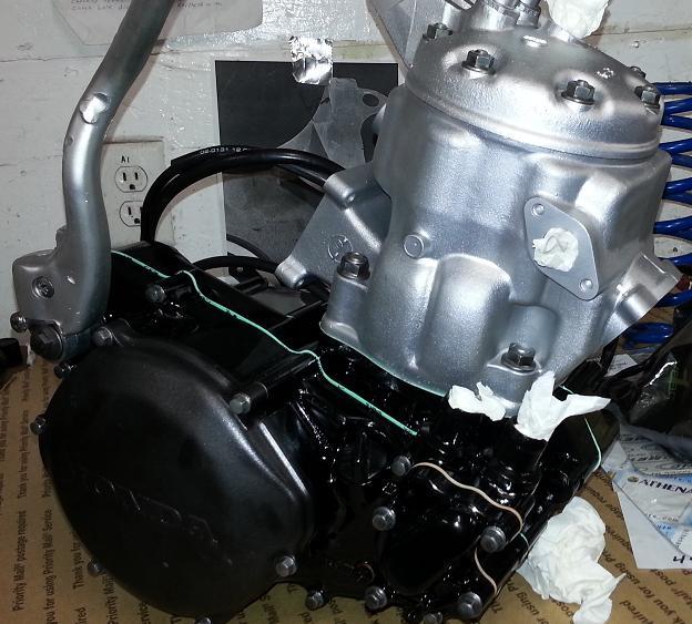

Well... here is the finished engine.
Sure it's clean and purdy, most everything inside has been replaced including upgrading the transmission with newer gears so that it is now at 97-01 specs, but what really makes this engine nice is the Adam Millar ported cylinder along with his special head mods and decomp.
Yeah, this one is gonna be a real runner...
OEM-CYCLE.COM CR500 FULL REBUILD 103.JPG (62.77 KiB) Viewed 10097 times
OEM-CYCLE.COM CR500 FULL REBUILD 104.JPG (57.66 KiB) Viewed 10097 times
