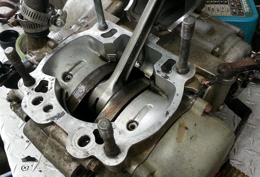

First off roll the crank around in neutral.
Do you hear any rough sounding bearings?
Are there any rough spots?
If so something is not right... The crankshaft should roll smooth with a very light resistance.

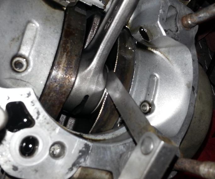

Take your feeler gauge and put it between the crank half and the connecting rod as shown below:
measuring your crank while it is still in the engine 102.JPG (48.32 KiB) Viewed 6827 times
Keep putting the gauge in there and changing the thickness until you can just barely slip the gauge in there.
Any bigger won't go in and any smaller is too loose.
Ours measured .024"

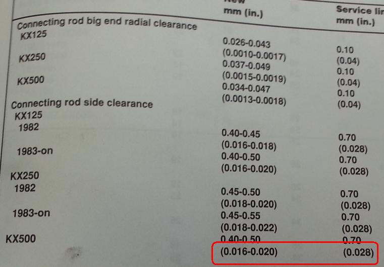

Ah,,, found the section on Connecting rod side clearance.
Your manual may call it something more technical like connecting rod lateral play or big end connecting rod to crankshaft clearance but it all means the same thing.
Here's what our Manual shows..
measuring your crank while it is still in the engine 104.JPG (40.27 KiB) Viewed 6827 times
So .016-.020" is factory new specs.
And we can run the crankshaft all the way to .028" before it's reached it's service limit.
Our crankshaft is in usable spec but not new spec.
Depending on how worn your crankshaft is you have a choice to make...
If you want the utmost in reliability, rebuild it...
If your going to ride it for a summer and then rebuild it, cool, put it back together and go for it.
