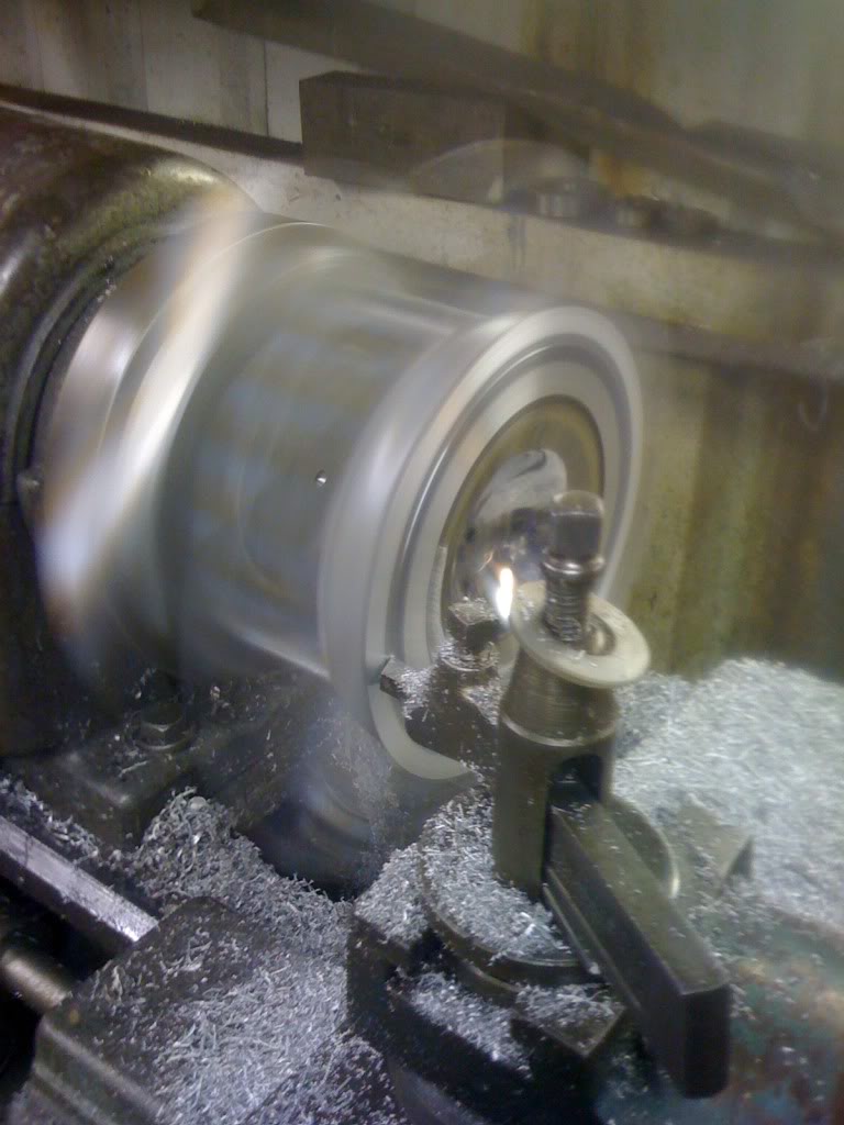

At the risk of sounding dumb tongue, is that a tool to chuck the k5 head in a lathe? I've cut removable domes but I havent seen the fixturing to cut a k5 head. Or am I clear off?HuhHuh second guess would be a cc'ing stand
Motorrad

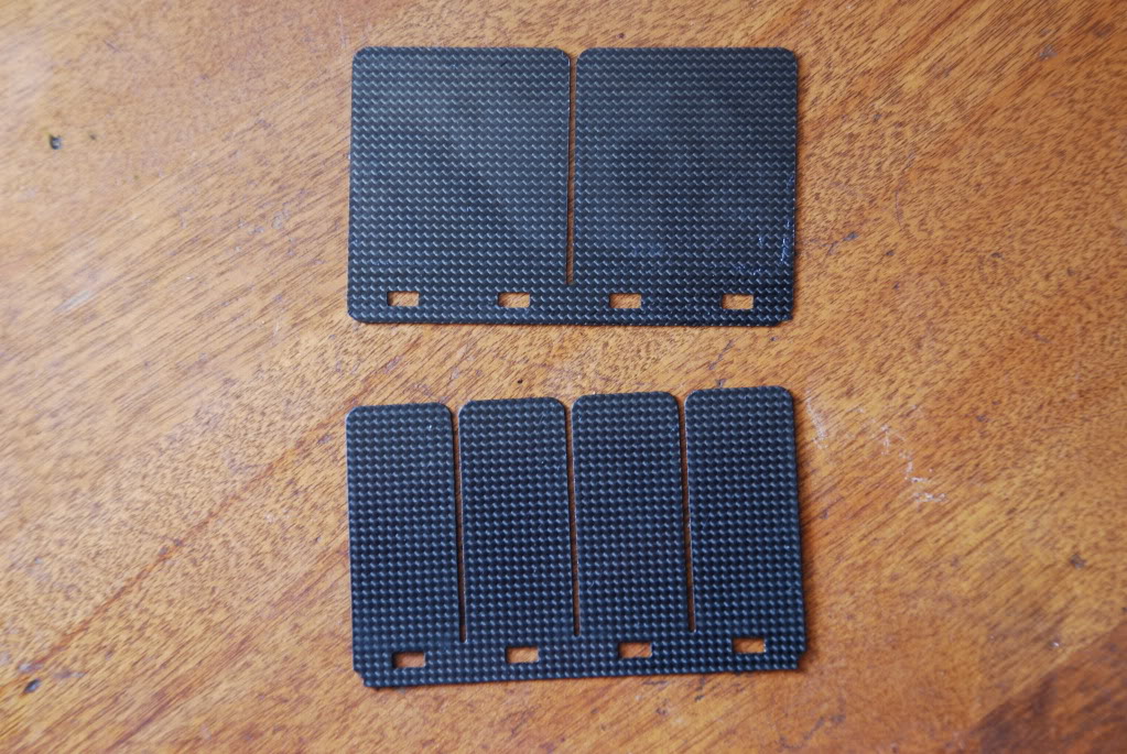

So you now have different petals than the vforce 3 comes with? I just got some 3s but haven't messed with them yet. Good to see the bike runs good. Awesome work!
Motorrad
Yep.. The Petals the V3 comes with are WAY SOFT... My intake was WET WET WET from blow by....
Stock on bottom.....
