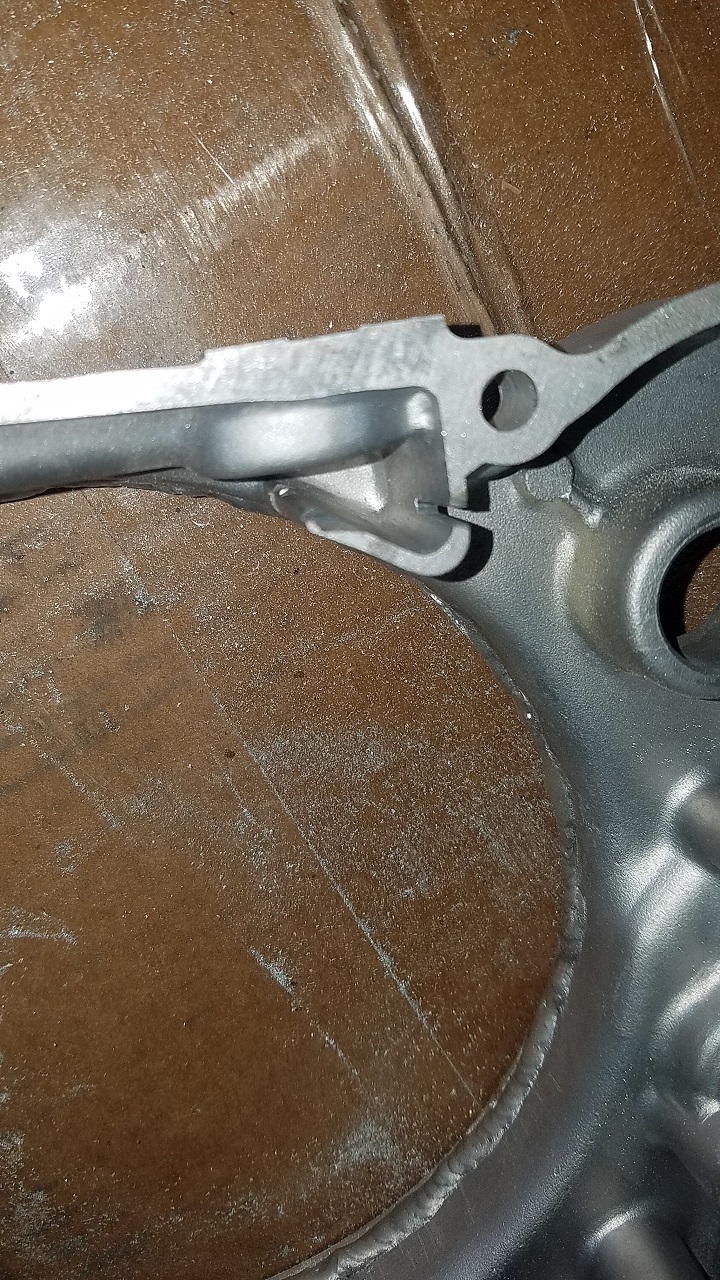

In this pic you can see the area of the Engine cases that is interfering with the starter housing.
KX GURU RACING TSR BUILT BILLET KX500 ENGINE CASES AND PANTHERA STARTER ISSUES 113.jpg
KX GURU RACING TSR BUILT BILLET KX500 ENGINE CASES AND PANTHERA STARTER ISSUES 113.jpg (347.7 KiB) Viewed 11462 times
Here is what a stock case looks like in the same area.
As you can see it has much more recess in it then does the TSR cases do.

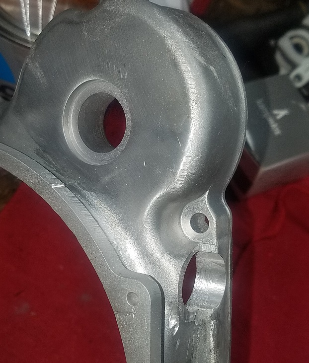

Posted: Tue Nov 14, 2017 11:22 pm
It's time for some changes...
First step... Get rid of the ridge around the kick lever shaft output area.

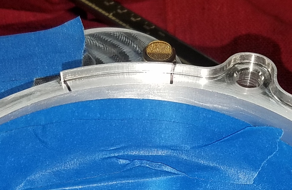

KX GURU RACING TSR BUILT BILLET KX500 ENGINE CASE with a 2 piece clutch cover 124.jpg
KX GURU RACING TSR BUILT BILLET KX500 ENGINE CASE with a 2 piece clutch cover 124.jpg (385.47 KiB) Viewed 11420 times
Next thing is to get rid of the splash guard for the filler plug.. :o
Cut number 1.
KX GURU RACING TSR BUILT BILLET KX500 ENGINE CASE with a 2 piece clutch cover 125.jpg
KX GURU RACING TSR BUILT BILLET KX500 ENGINE CASE with a 2 piece clutch cover 125.jpg (516.78 KiB) Viewed 11420 times
Cut number 2
KX GURU RACING TSR BUILT BILLET KX500 ENGINE CASE with a 2 piece clutch cover 126.jpg
KX GURU RACING TSR BUILT BILLET KX500 ENGINE CASE with a 2 piece clutch cover 126.jpg (404.21 KiB) Viewed 11419 times

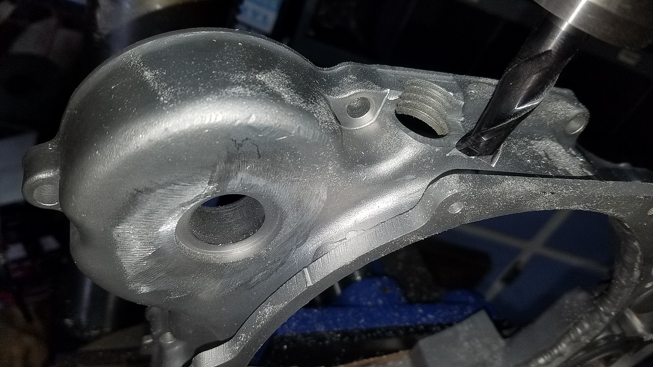

A little mill/drill work..
KX GURU RACING TSR BUILT BILLET KX500 ENGINE CASE with a 2 piece clutch cover 128.jpg
KX GURU RACING TSR BUILT BILLET KX500 ENGINE CASE with a 2 piece clutch cover 128.jpg (366.51 KiB) Viewed 11420 times

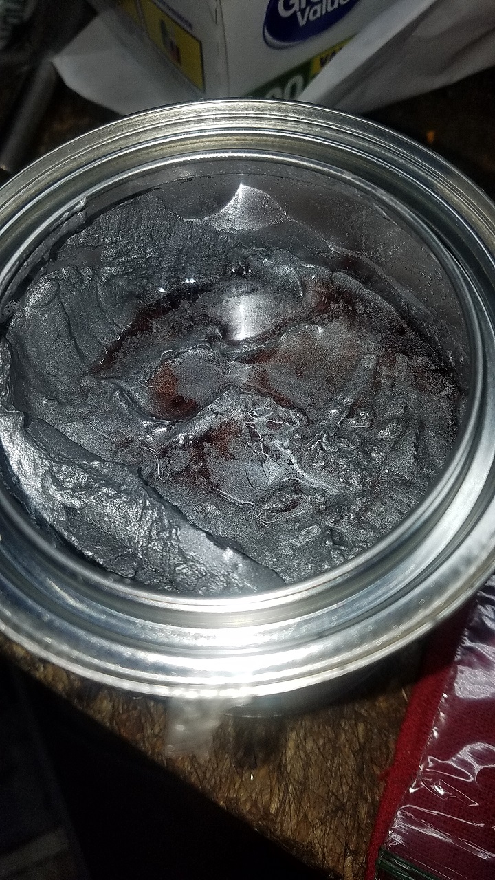

Posted: Thu Nov 16, 2017 3:43 pm
(In your best Arnold Schwarzenegger voice) unprogrammed mimetic polyalloy... liquid metal... :lol:
KX GURU RACING TSR BUILT BILLET KX500 ENGINE CASE with a 2 piece clutch cover 130.jpg
KX GURU RACING TSR BUILT BILLET KX500 ENGINE CASE with a 2 piece clutch cover 130.jpg (454.49 KiB) Viewed 11413 times
I have never tried this product... We'll see how it works..

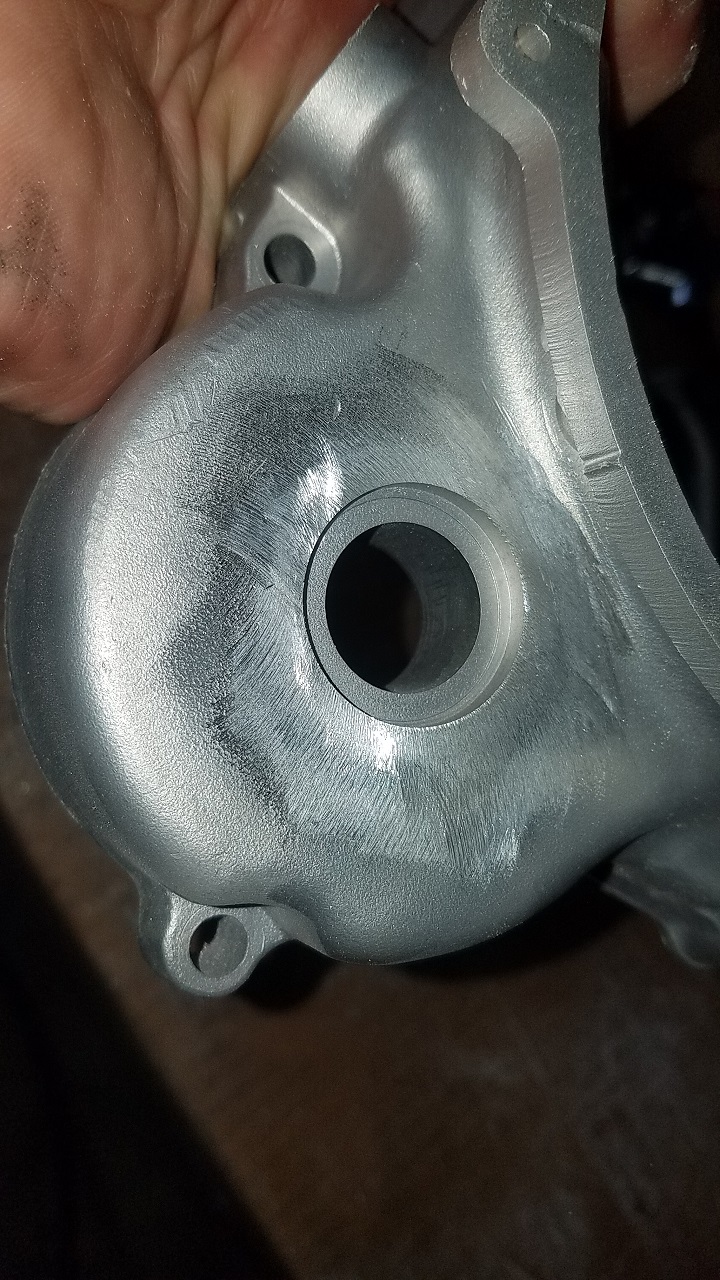

Posted: Thu Nov 16, 2017 3:47 pm
After prepping the cover I taped the back side to keep the material in place..
KX GURU RACING TSR BUILT BILLET KX500 ENGINE CASE with a 2 piece clutch cover 131.jpg
KX GURU RACING TSR BUILT BILLET KX500 ENGINE CASE with a 2 piece clutch cover 131.jpg (180.25 KiB) Viewed 11471 times

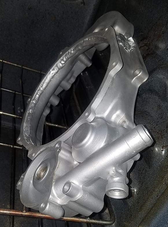

Because it Oregon... and it's cold and raining outside, I used the over to keep the temps up...
After applying the filler I let it sit for about 5 minutes then pulled the tape off...
Then I put it in the oven but left the door wide open to keep from over heating it.
My oven only goes down to 170f and that may be a bit warm :lol:
KX GURU RACING TSR BUILT BILLET KX500 ENGINE CASE with a 2 piece clutch cover 132.jpg
KX GURU RACING TSR BUILT BILLET KX500 ENGINE CASE with a 2 piece clutch cover 132.jpg (204.46 KiB) Viewed 11471 times
