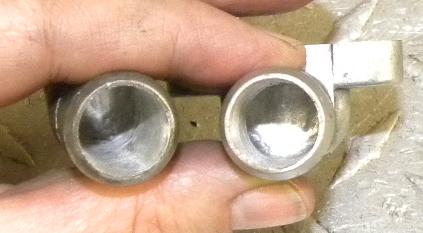

I know, you were all hoping this would go away but..... There is some restrictions that can be reduced.
Not as much as the cover but every little bit can help... Maybe...
Believe it or not, the round end has the most restriction

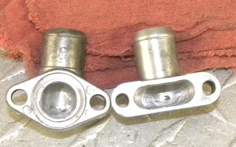

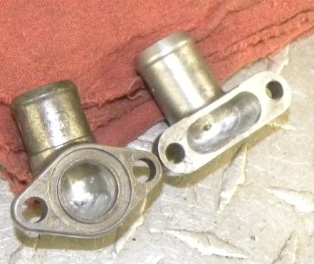

Without making your own elbows I'm not sure there is much else you can do to make the flow better in these pieces...
