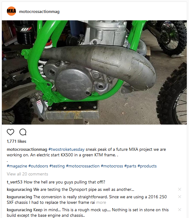

BAM!!!
motocrossactionmag#twostroketuesday sneak peak of a future MXA project we are working on. An electric start KX500 in a green KTM frame. .
#magazine #outdoors #testing #motocrossaction #motocross #parts #products

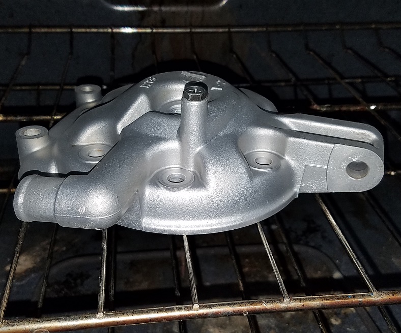

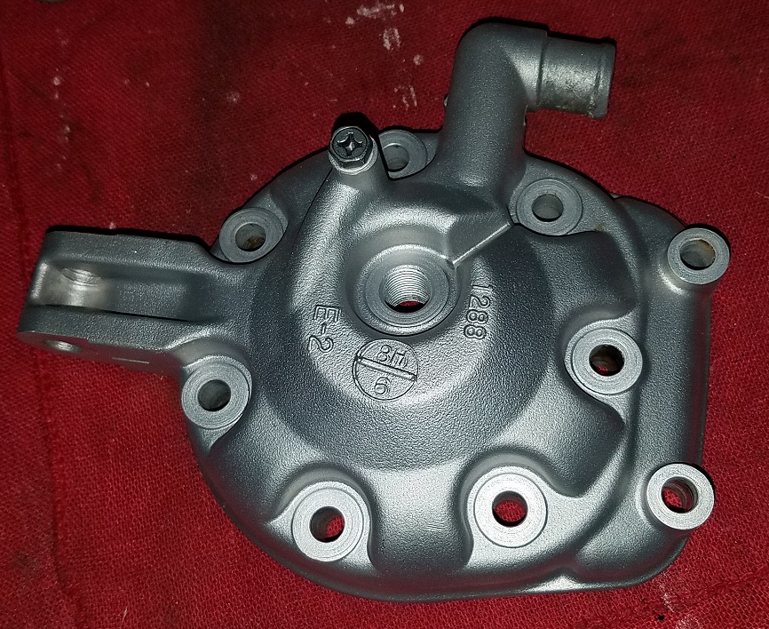

I received this head from Motorrad..
Fresh out of the oven...
KX GURU RACING KTX500E BUILD HEAD WORK 103.jpg (213.33 KiB) Viewed 10928 times
I'm getting it ready to go to Adam Millar from MRE.
Adam is going to cut it for a big bore, add a parallel cooling outlet, add a decomp, and re-cut the combustion chamber after I figure out what I need lol...

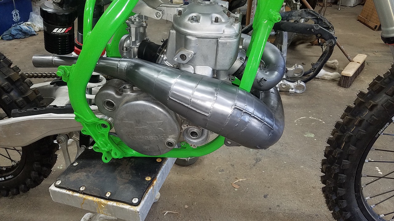

Posted: Sat Sep 16, 2017 5:40 am
Spent a bit of time cleaning up that ugly pipe...
KX GURU RACING 2016 KTM 250SXF KX500 CONVERSION PIPE 164.jpg (496.34 KiB) Viewed 10927 times
I have more work to do but at least there is some progress...

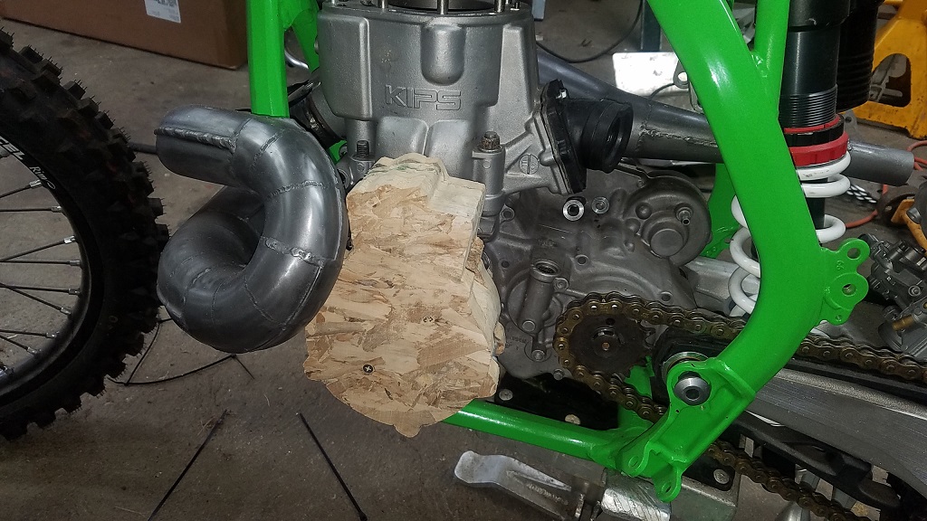

Posted: Thu Oct 26, 2017 8:27 pm

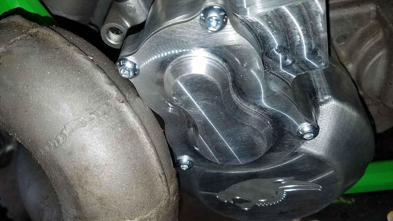

Since I am using an electric starter the pipe needs to stick out just a bit further then any pipe I have :(
You can see here where they all hit.
KX GURU RACING KX500 KTM CONVERSION ELECTRIC STARTER 101.jpg (445.73 KiB) Viewed 10801 times
My solution is to get a new cone pipe made 8-)
But I don't want them to use my fancy pants electric starter for a template to work around.
When all else fails I turn back to wood working :lol:
KX GURU RACING KX500 KTM CONVERSION ELECTRIC STARTER 125.jpg (240.67 KiB) Viewed 10801 times
It bolts right up and simulates the Electric starter perfectly.
KX GURU RACING KX500 KTM CONVERSION ELECTRIC STARTER 126.jpg (246.82 KiB) Viewed 10801 times
It's crude but effective :mrgreen:

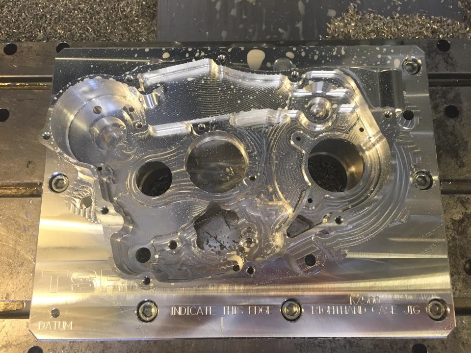

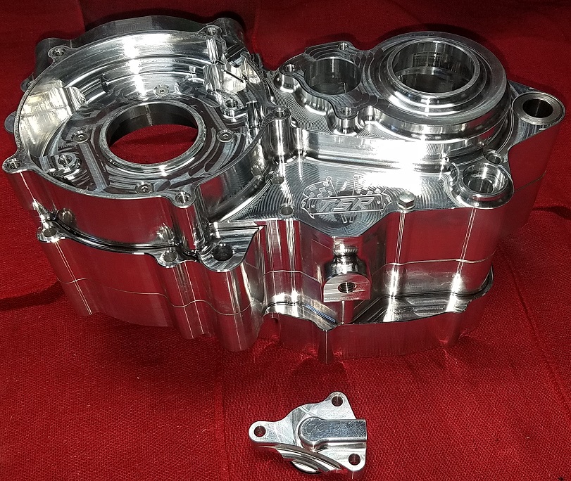

Posted: Fri Nov 03, 2017 9:34 pm
KX GURU RACING TSR BUILT BILLET KX500 ENGINE CASES 102.jpg (413.79 KiB) Viewed 10758 times
KX GURU RACING TSR BUILT BILLET KX500 ENGINE CASES 103.jpg (316.89 KiB) Viewed 10758 times
KX GURU RACING TSR BUILT BILLET KX500 ENGINE CASES 104.jpg (353.07 KiB) Viewed 10758 times

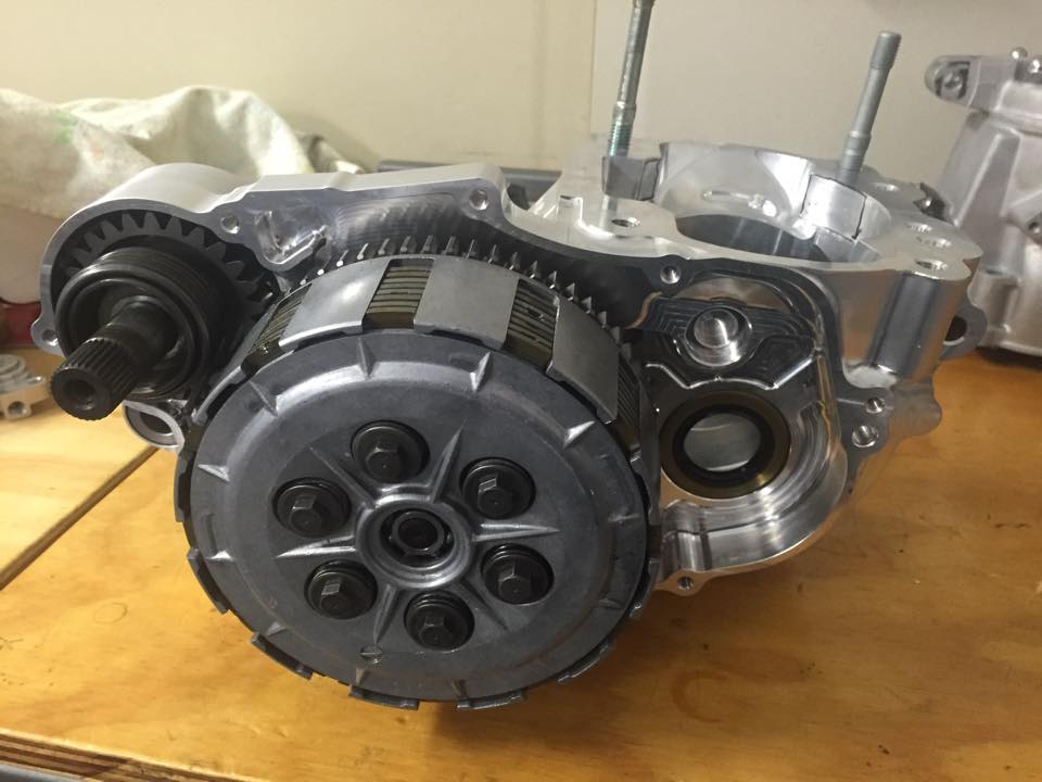

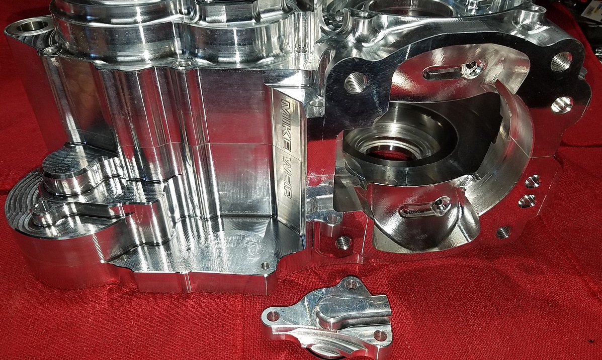

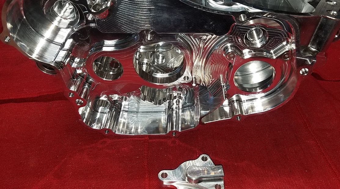

Posted: Fri Nov 03, 2017 9:35 pm
KX GURU RACING TSR BUILT BILLET KX500 ENGINE CASES 106.jpg (406 KiB) Viewed 10762 times
KX GURU RACING TSR BUILT BILLET KX500 ENGINE CASES 107.jpg (432.94 KiB) Viewed 10762 times
KX GURU RACING TSR BUILT BILLET KX500 ENGINE CASES 108.jpg (483.97 KiB) Viewed 10762 times
