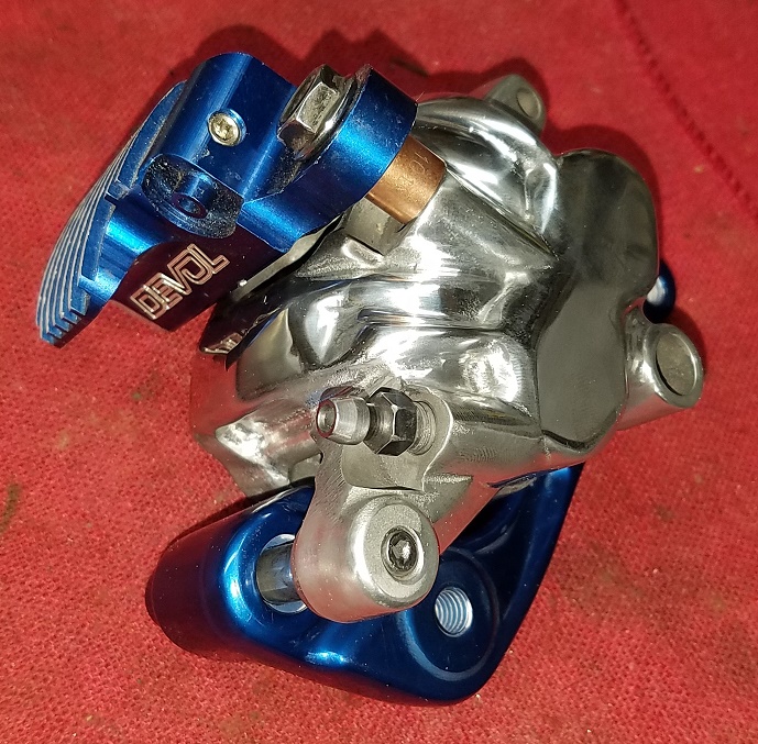

I have more work to do but at least there is some progress...
Not done yet, but you get the idea 8-)
2016 KTM 250SXF KX500 Conversion front brake 101.jpg (233.53 KiB) Viewed 10875 times
Looks like something cool might happen :o :shock: :lol:

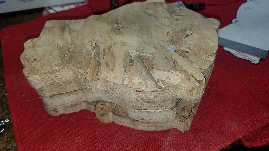

Since I am using an electric starter the pipe needs to stick out just a bit further then any pipe I have :(
You can see here where they all hit.
KX GURU RACING KX500 KTM CONVERSION ELECTRIC STARTER 101.jpg (445.73 KiB) Viewed 10794 times
My solution is to get a new cone pipe made 8-)
But I don't want them to use my fancy pants electric starter for a template to work around.
When all else fails I turn back to wood working :lol:
KX GURU RACING KX500 KTM CONVERSION ELECTRIC STARTER 125.jpg (240.67 KiB) Viewed 10794 times
It bolts right up and simulates the Electric starter perfectly.
KX GURU RACING KX500 KTM CONVERSION ELECTRIC STARTER 126.jpg (246.82 KiB) Viewed 10794 times
It's crude but effective :mrgreen:

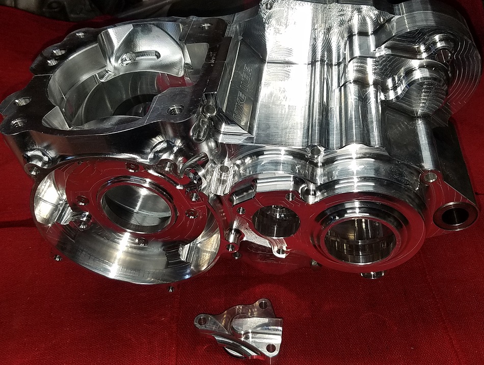

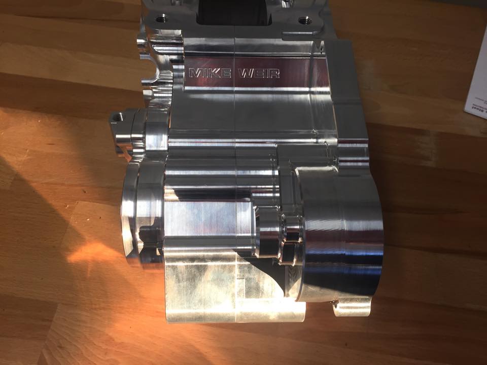

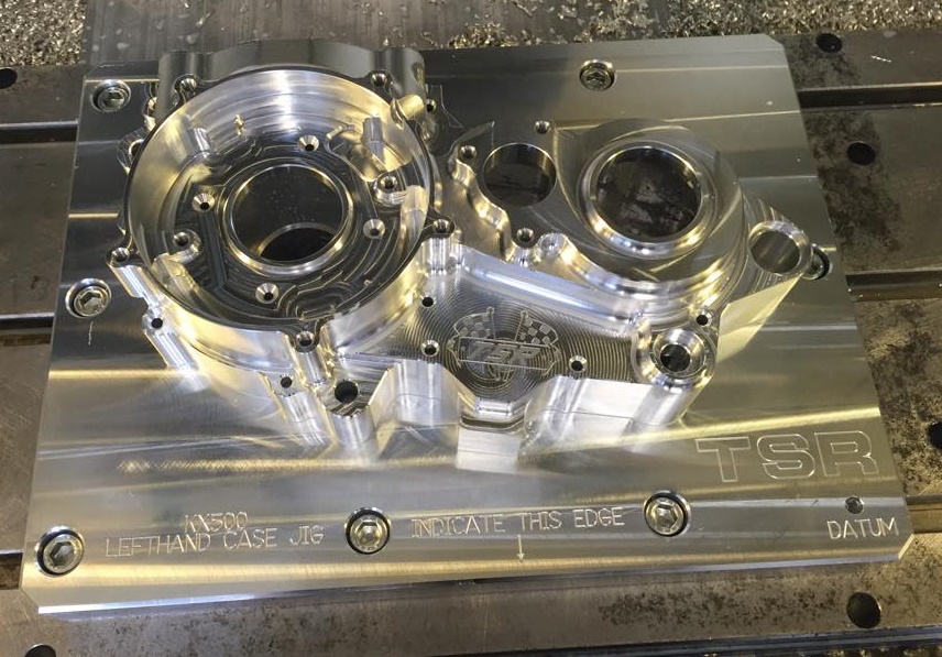

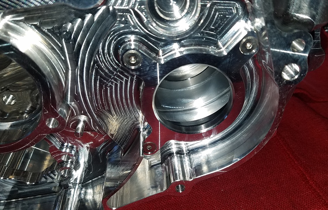

KX GURU RACING TSR BUILT BILLET KX500 ENGINE CASES 102.jpg (413.79 KiB) Viewed 10751 times
KX GURU RACING TSR BUILT BILLET KX500 ENGINE CASES 103.jpg (316.89 KiB) Viewed 10751 times
KX GURU RACING TSR BUILT BILLET KX500 ENGINE CASES 104.jpg (353.07 KiB) Viewed 10751 times
KX GURU RACING TSR BUILT BILLET KX500 ENGINE CASES 106.jpg (406 KiB) Viewed 10755 times
KX GURU RACING TSR BUILT BILLET KX500 ENGINE CASES 107.jpg (432.94 KiB) Viewed 10755 times
KX GURU RACING TSR BUILT BILLET KX500 ENGINE CASES 108.jpg (483.97 KiB) Viewed 10755 times
