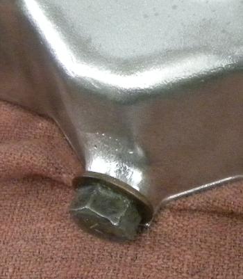

I took my engine cases out, pressed out the bearings and seals, did a degreasing wash on them and started checking them for imperfections.
Wouldn't you know it, drain hole damage :x
DRAIN HOLE DAMAGE.JPG (30.64 KiB) Viewed 13081 times
And I already knew about this damage.
More damage.JPG (6.58 KiB) Viewed 13081 times
So off to tig weld they go...
Back from tig and sandblasting..
It helps when your buddy runs the weld shop right next door :D
after weld and sandblast.JPG (97.9 KiB) Viewed 13079 times
The drain hole fix turned out better then I expected.
after weld and sandblast 2.JPG (21.28 KiB) Viewed 13079 times
Now I need to make a decision.
Should I semi polish the cases, Paint them, or leave them raw?
I did some quick semi polish just to get an idea of what it would look like as you can see in the right side of the pic above as well as the drain hole.
What do you guys think?

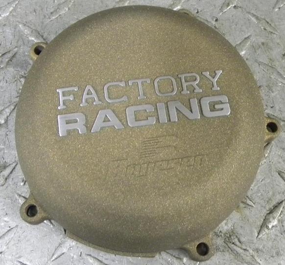

I had an emergency order to make but didn't have enough of an order to qualify for free shipping...
So.....
Stator cover.JPG (57.41 KiB) Viewed 13021 times
