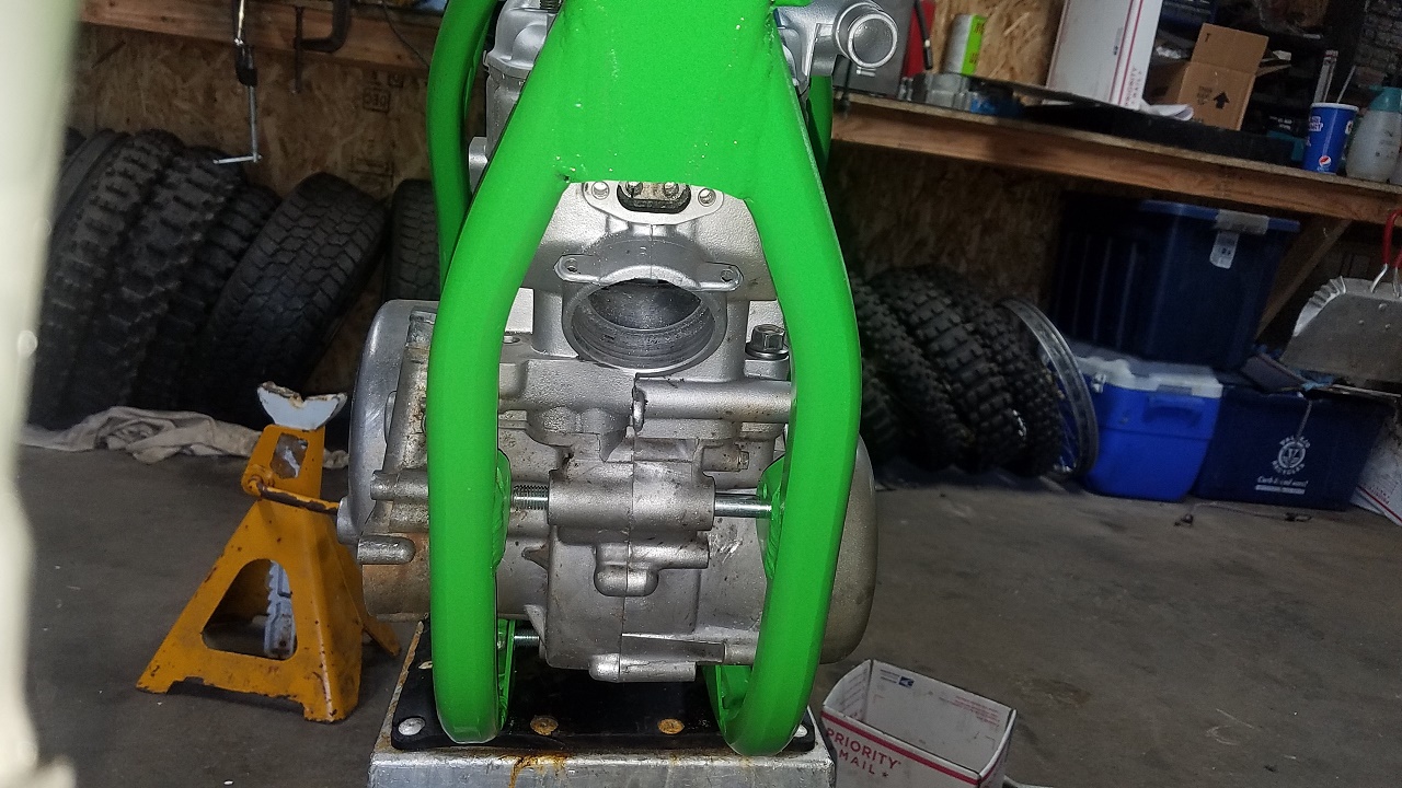

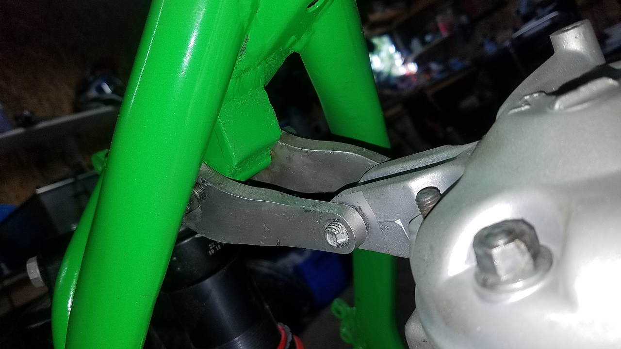

Remember, the engine is trying to rotate with the Swingarm pivot pin being the centerline of the axis.
Something as demonstrated below.
Keeping the Head stay brackets in line with the greatest force is really important.

Posted: Sat Aug 05, 2017 5:14 pm

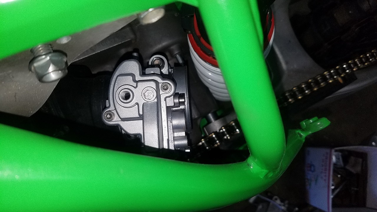

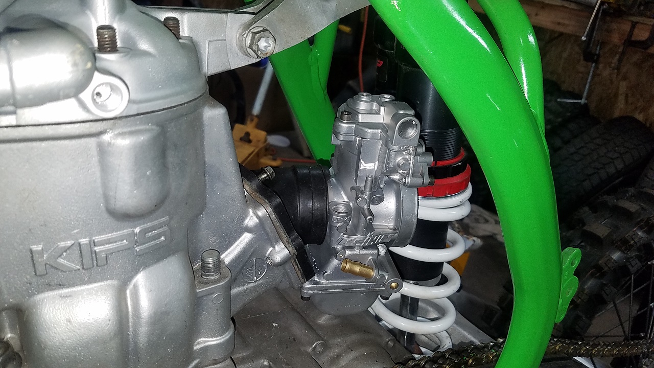

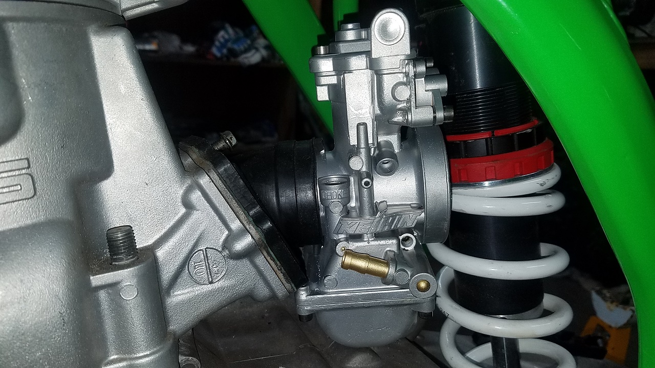

Next, I'm checking carb clearance.
This is a 38mm Airstriker short bodied version.
I'm also testing a Standard body Airstriker as well as a Lektron.
KX GURU RACING KTX500E BUILD 132.jpg (416.53 KiB) Viewed 10277 times
KX GURU RACING KTX500E BUILD 133.jpg (340.06 KiB) Viewed 10277 times
KX GURU RACING KTX500E BUILD 134.jpg (385.59 KiB) Viewed 10277 times
KX GURU RACING KTX500E BUILD 135.jpg (376.9 KiB) Viewed 10277 times
As you can see, there is plenty of room :-)
I will also be running a reed spacer so that will improve the already ample clearance.

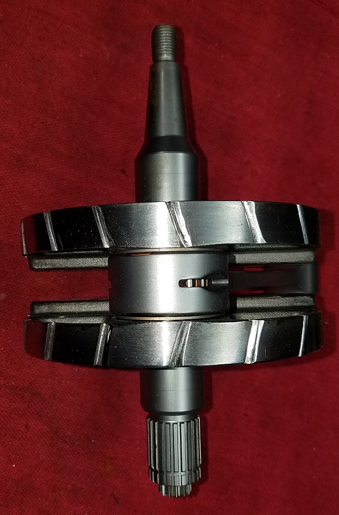

Posted: Sun Aug 13, 2017 3:40 pm

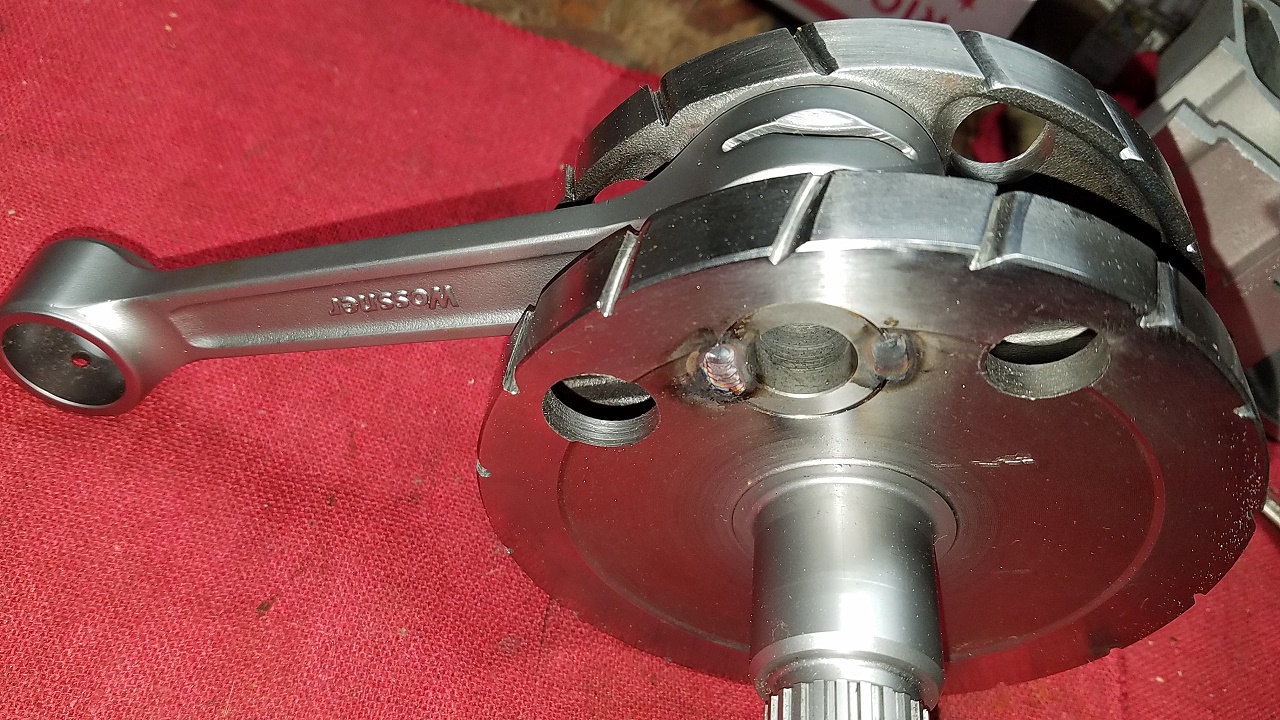

Here is some other goodies I'm playing with for this build...
KX GURU RACING KX500 TURBO CRANK 101.jpg (262.17 KiB) Viewed 10239 times
KX GURU RACING KX500 TURBO CRANK 102.jpg (444.18 KiB) Viewed 10239 times
KX Guru Racing is testing this mod for Steve Parris at Parris Racing Concepts
His Facebook page is here:
https://www.facebook.com/steve.parris.399
Others have tried this mod before with varying degrees of success.
Dirt Bike magazine ran some tests on Steve's crank and they reported a nice increase in power on a smaller engine.
We are testing and tuning for a KX500 so it may or may not work.
I'm betting that it will, especially in view of the case mods that MUST be made to make this modification work.

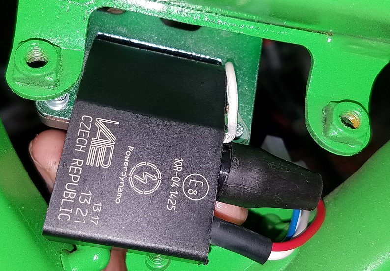

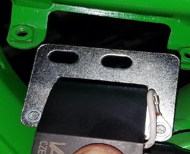

Posted: Wed Sep 06, 2017 1:48 am
Wow... Using a Power Dynamo Ignition on this conversion will only require a new mounting bracket and a bit of trimming..
Easy money... 8-)

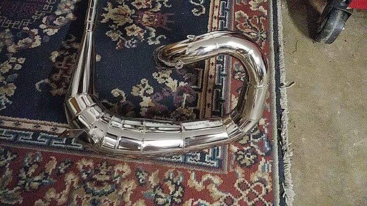

Ben Brown had his pipe nickle plated..
Als Plating in Ft. Worth Tx, did it in 1 day $85
It certainly an option...
