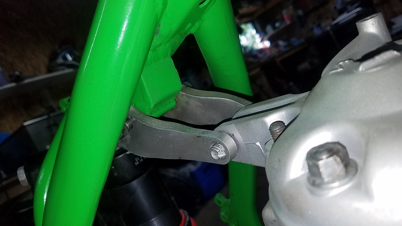

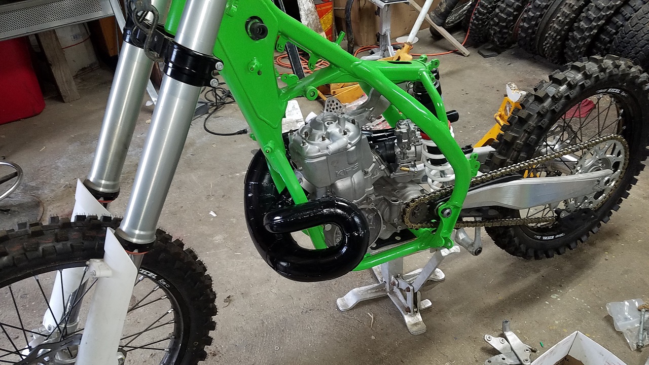

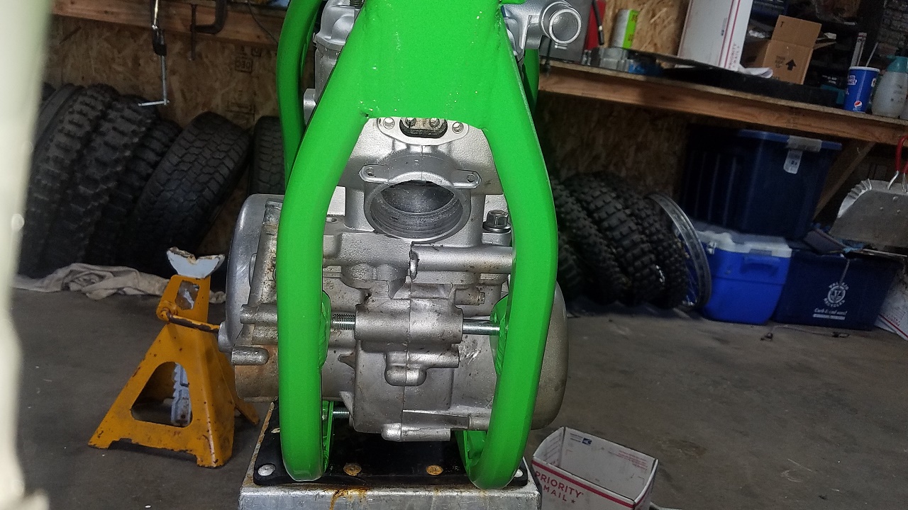

Remember, the engine is trying to rotate with the Swingarm pivot pin being the centerline of the axis.
Something as demonstrated below.
Keeping the Head stay brackets in line with the greatest force is really important.
KX GURU RACING KTX500E BUILD 129.jpg (303.65 KiB) Viewed 10268 times

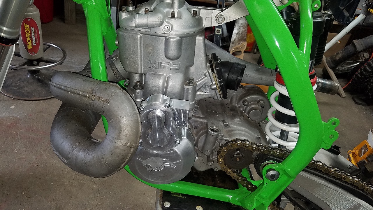

As you can see in this pic, there is plenty of room for pipe clearance.

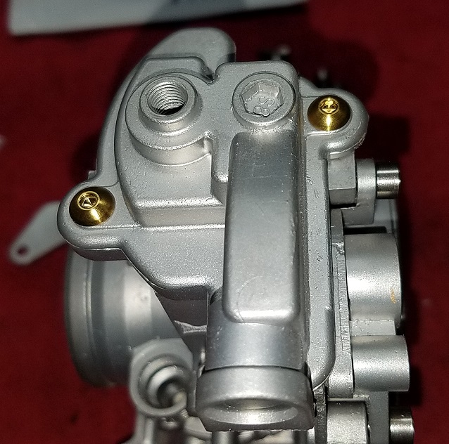

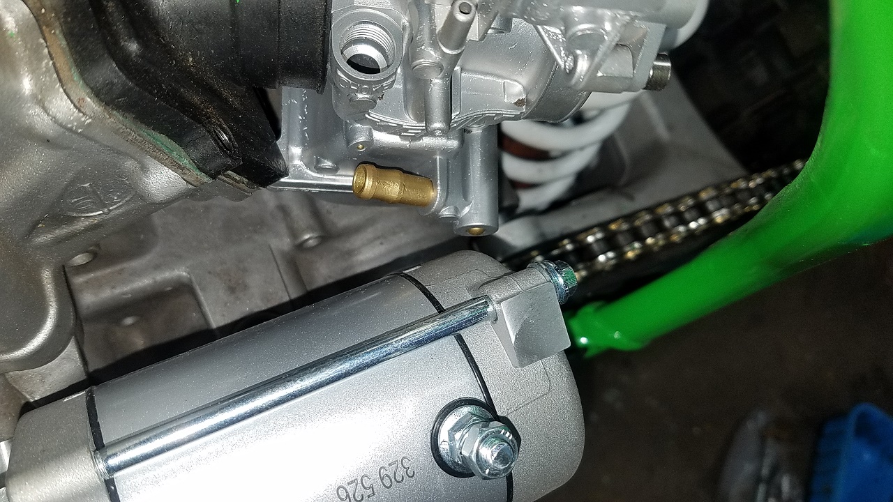

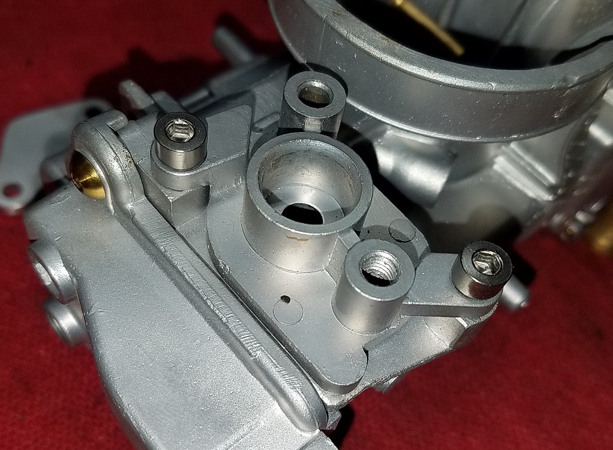

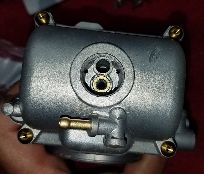

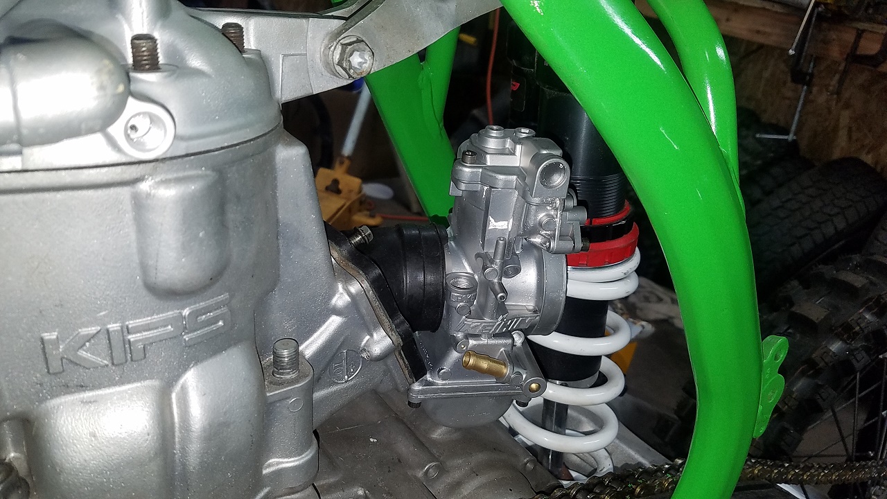

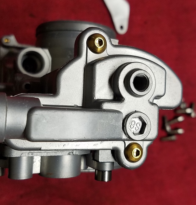

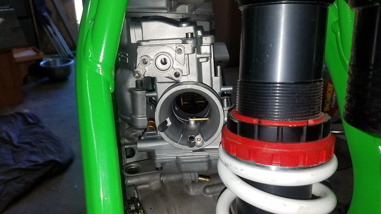

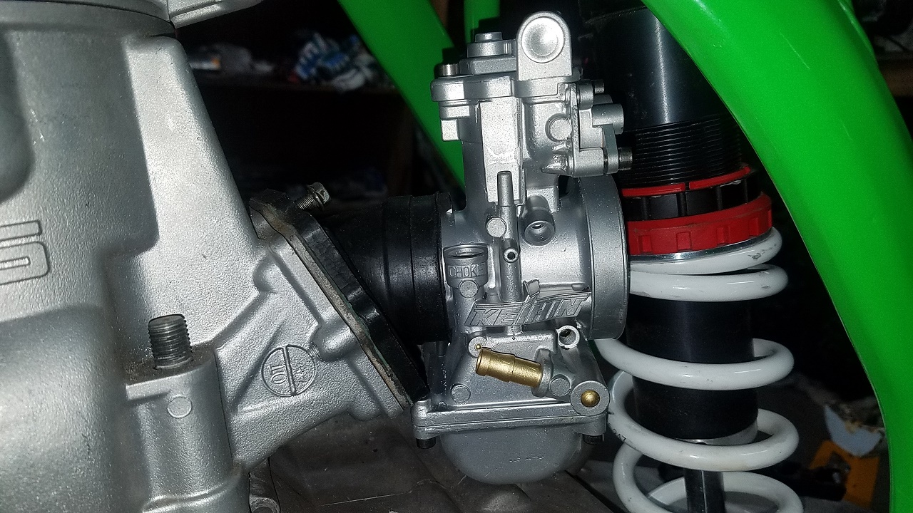

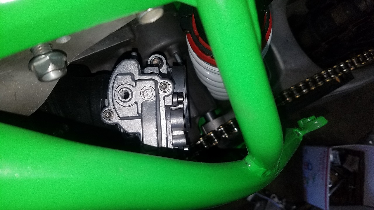

Next, I'm checking carb clearance.
This is a 38mm Airstriker short bodied version.
I'm also testing a Standard body Airstriker as well as a Lektron.
KX GURU RACING KTX500E BUILD 132.jpg (416.53 KiB) Viewed 10267 times
KX GURU RACING KTX500E BUILD 133.jpg (340.06 KiB) Viewed 10267 times
KX GURU RACING KTX500E BUILD 134.jpg (385.59 KiB) Viewed 10267 times
KX GURU RACING KTX500E BUILD 135.jpg (376.9 KiB) Viewed 10267 times
As you can see, there is plenty of room :-)
I will also be running a reed spacer so that will improve the already ample clearance.

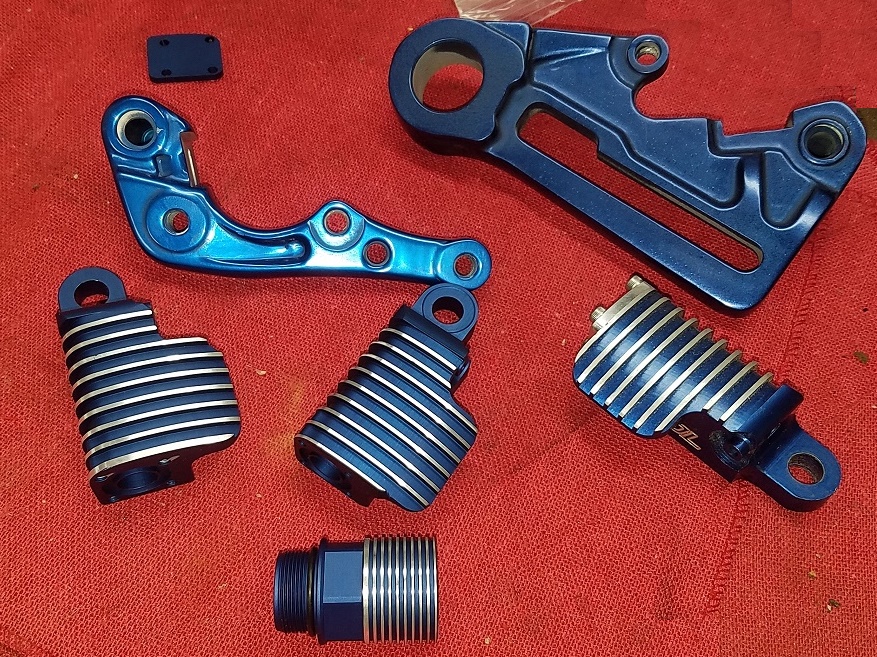

Oh yeah... Look what showed up from the Anodizer today 8-)
KX GURU RACING KTX500E BUILD ANNODIZE 101.jpg (414.06 KiB) Viewed 10246 times
Blasted all that nasty orange pumpkin rine right off the parts and then sent them to Scot Schneider.
He took them to his good buddy Kenny at Precision Anodizing in Oklahoma City.
Here is a link to his Facebook page
https://www.facebook.com/Precision-Anod ... 585119272/
I had him try and match the color of a cooler I already had.
As you can see the parts turned out great!
Thanks Scot and Kenny.
I really appreciate it!

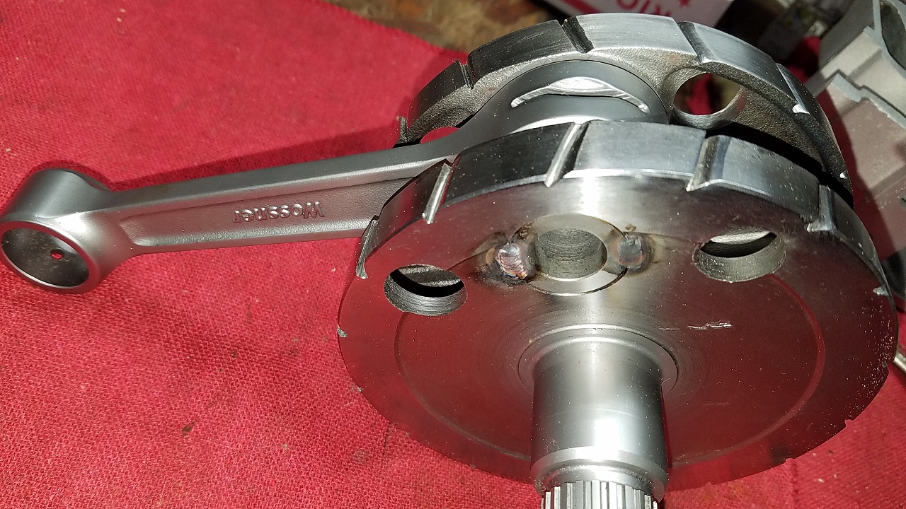

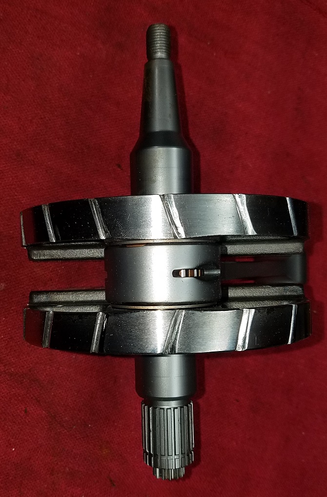

KX GURU RACING KX500 TURBO CRANK 101.jpg (262.17 KiB) Viewed 10229 times
KX GURU RACING KX500 TURBO CRANK 102.jpg (444.18 KiB) Viewed 10229 times
KX Guru Racing is testing this mod for Steve Parris at Parris Racing Concepts
His Facebook page is here:
https://www.facebook.com/steve.parris.399
Others have tried this mod before with varying degrees of success.
Dirt Bike magazine ran some tests on Steve's crank and they reported a nice increase in power on a smaller engine.
We are testing and tuning for a KX500 so it may or may not work.
I'm betting that it will, especially in view of the case mods that MUST be made to make this modification work.

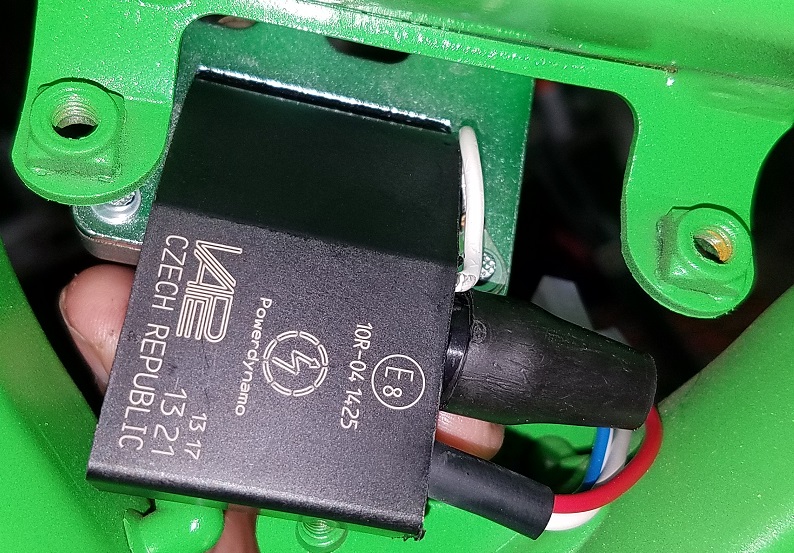

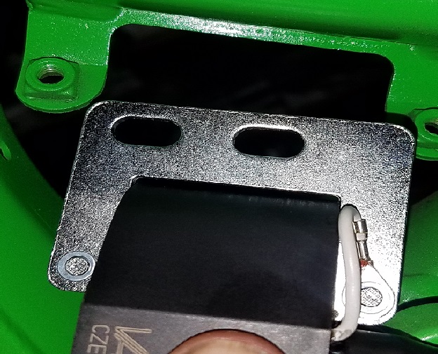

Wow... Using a Power Dynamo Ignition on this conversion will only require a new mounting bracket and a bit of trimming..
Easy money... 8-)

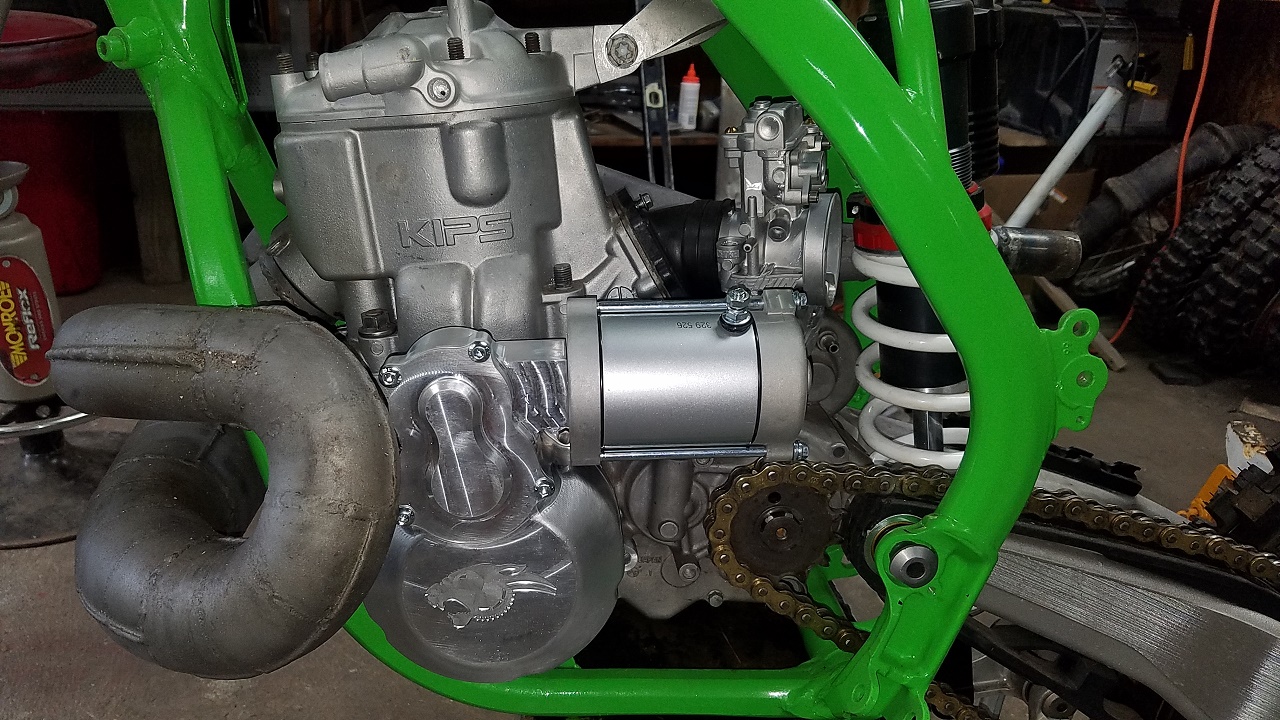

AND THE MOMENT YOU HAVE ALL BEEN WAITING FOR... :lol:
KX GURU RACING KX500 KTM CONVERSION ELECTRIC STARTER 102.jpg (461.63 KiB) Viewed 10150 times
KX GURU RACING KX500 KTM CONVERSION ELECTRIC STARTER 103.jpg (439.67 KiB) Viewed 10150 times
KX GURU RACING KX500 KTM CONVERSION ELECTRIC STARTER 104.jpg (413.89 KiB) Viewed 10150 times

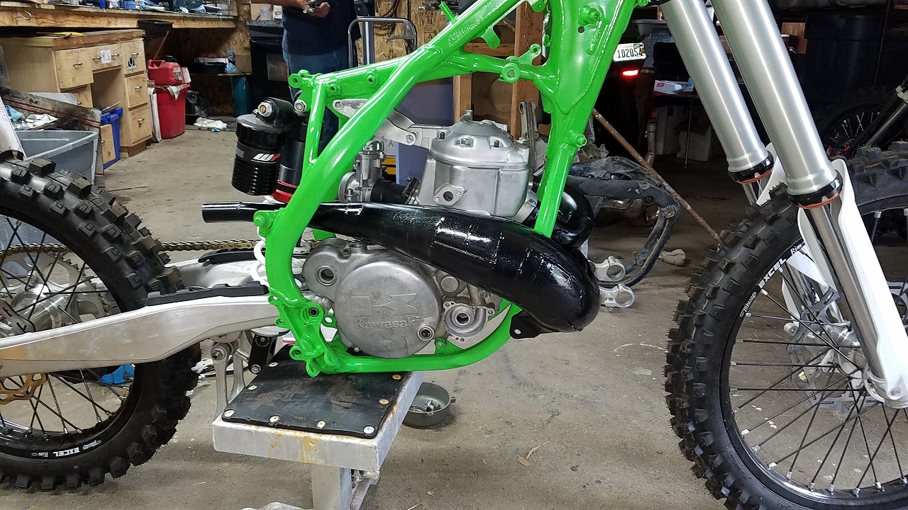

Since I have to do something with the pipe color I decided to try a few colors out..
Gloss black???
KX GURU RACING 2016 KTM 250SXF KX500 CONVERSION 162.jpg (511.16 KiB) Viewed 10144 times
KX GURU RACING 2016 KTM 250SXF KX500 CONVERSION 163.jpg (492.22 KiB) Viewed 10144 times
I'm thinking NO WAY!!!!! :o :shock: :lol:

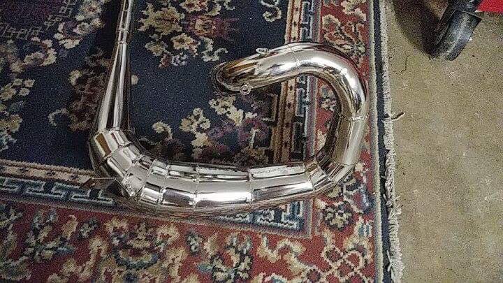

Ben Brown had his pipe nickle plated..
Als Plating in Ft. Worth Tx, did it in 1 day $85
It certainly an option...
