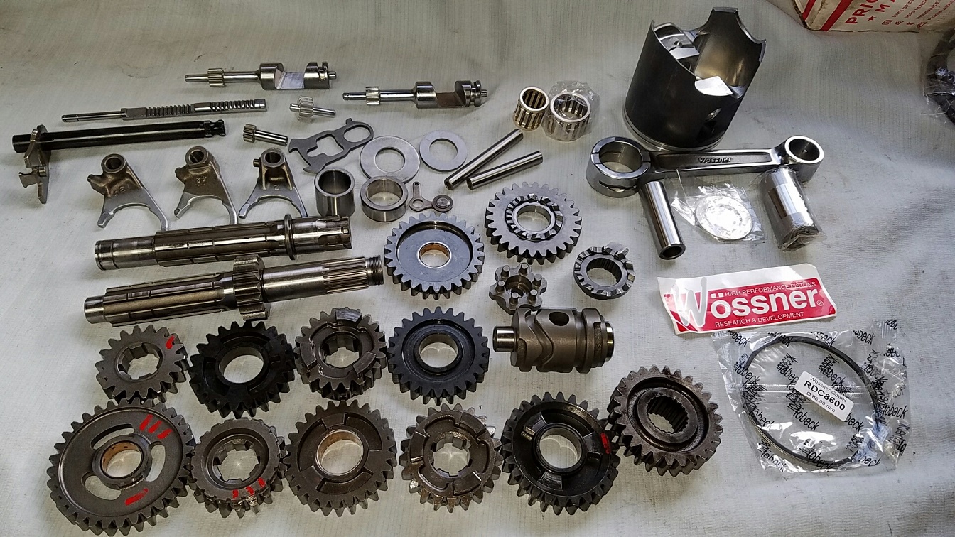

Making sure everything is here that we need...
KX GURU RACING SEAN COLLIER KX500 305.JPG (475.06 KiB) Viewed 10314 times
Going to WPC to get treated.. 8-)

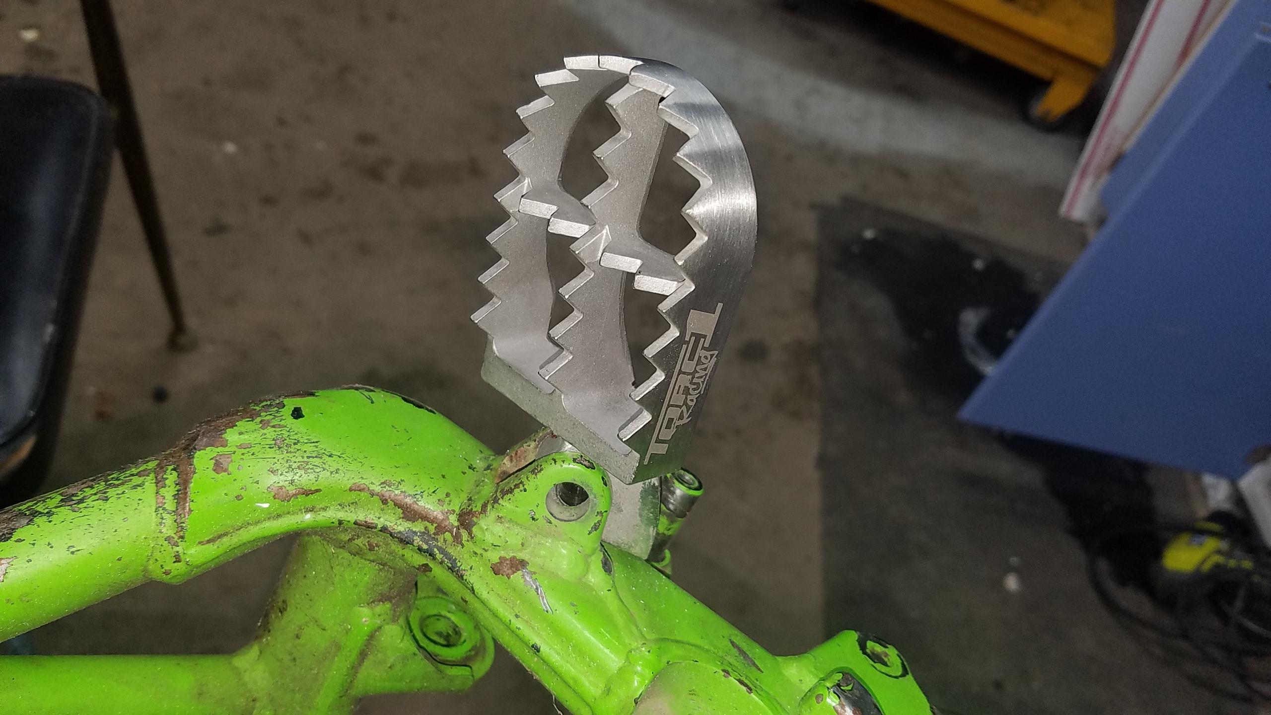

Torque one sent us some killer foot pegs for a YZ450F.
But they won't fit on a KX500.
KX GURU RACING SEAN COLLIER KX500 315.JPG (198.8 KiB) Viewed 10278 times
So, the first thing we gotta do is remove these tubes..
KX GURU RACING SEAN COLLIER KX500 316.JPG (181.29 KiB) Viewed 10278 times
Calling Mr. Sawsall... :lol:
KX GURU RACING SEAN COLLIER KX500 317.JPG (209.43 KiB) Viewed 10278 times
That's better..

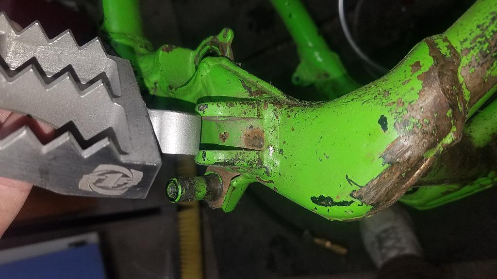

Re: Sean Colliers KX500 build
But they still won't fit...
KX GURU RACING SEAN COLLIER KX500 318.JPG (99.08 KiB) Viewed 10277 times

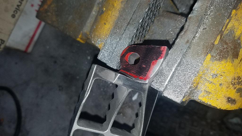

The web is just too thick...
So into the vice for a little hand work..
KX GURU RACING SEAN COLLIER KX500 319.JPG (131.11 KiB) Viewed 10277 times
Grind, grind, grind, file, file, file...
Check it often... Unless you have a mill, then just mill it to the correct thickness..
KX GURU RACING SEAN COLLIER KX500 320.JPG (368.89 KiB) Viewed 10277 times
Make sure it rotates freely with no obstructions..

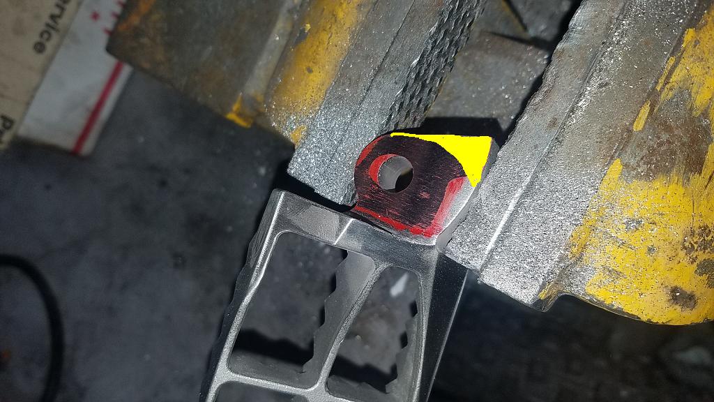

But, your still not done...
You will need to remove some more material as shown in yellow.
Go slow and do a ton of test fitting..

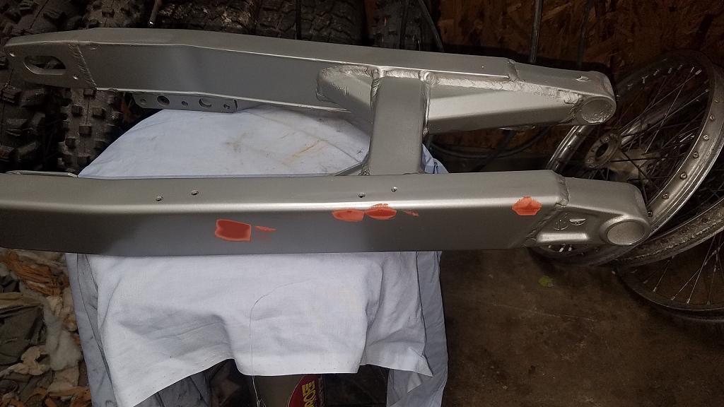

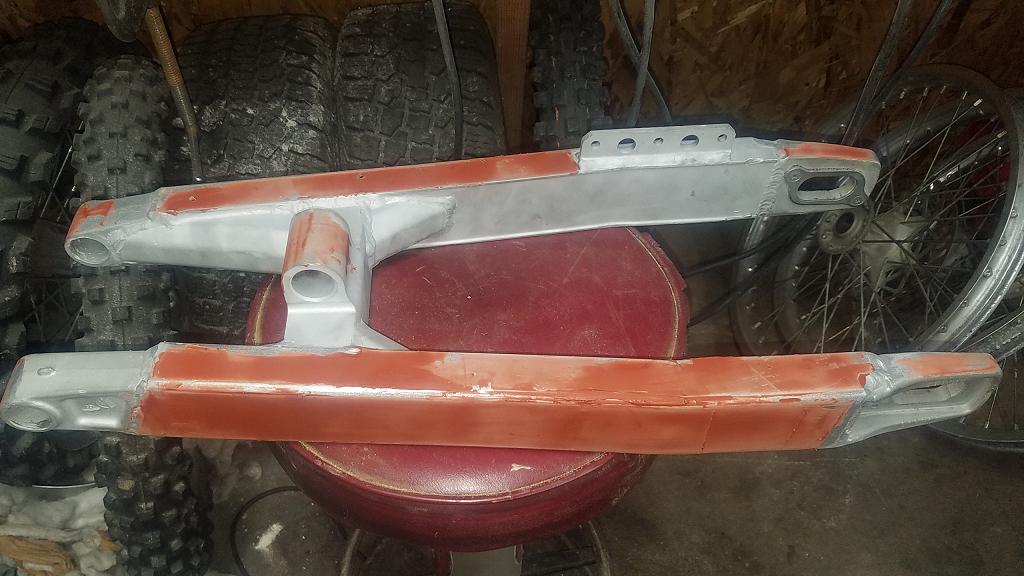

Our donor swing arm was a bit beat up so a little sanding, a little putty, a little more sanding..
KX GURU RACING SEAN COLLIER KX500 322.JPG (91.07 KiB) Viewed 10270 times

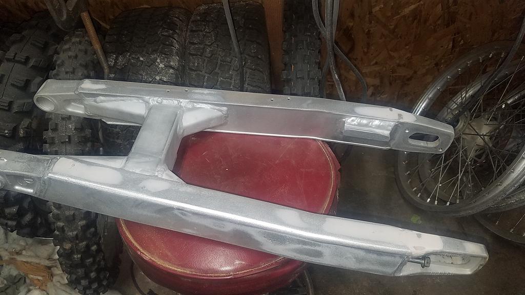

More putty, more sanding...
KX GURU RACING SEAN COLLIER KX500 323.JPG (104.72 KiB) Viewed 10261 times

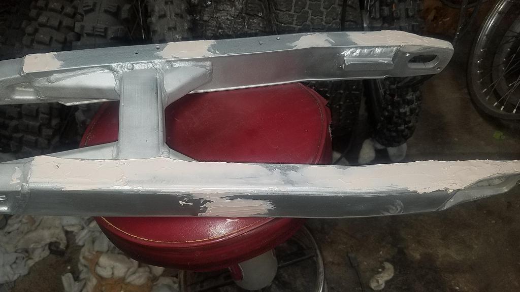

KX GURU RACING SEAN COLLIER KX500 324.JPG (106.88 KiB) Viewed 10261 times
