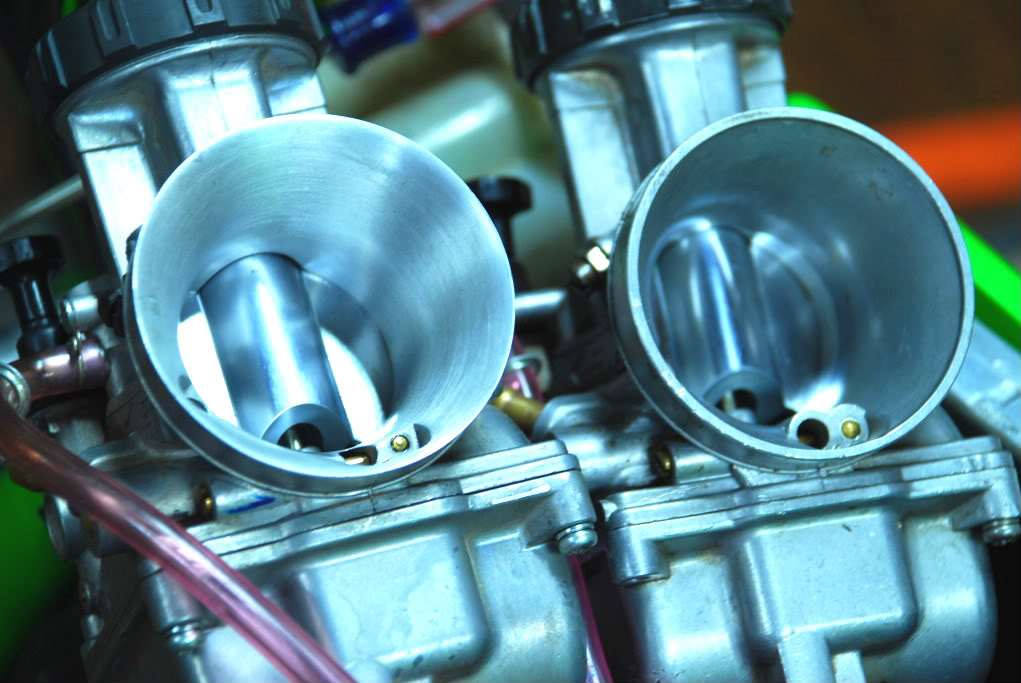

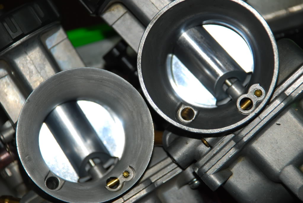

After alot of beer tonight, I remembered you asking me for pictures of a standard PWK vs the taper bore Sudco... sorry I forgot (takes beer to Jog my memory sometimes)...
But here ya go..

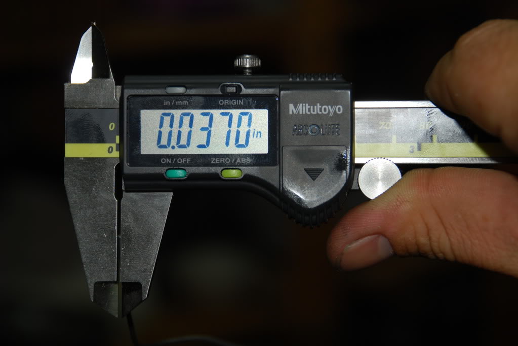

Okay. got my wrist pin clips.. Working on final assembly and GUESS WHAT!
I find a machining flaw with my Wiseco piston.. (shock)
the Wrist pin clip spacing is TOO close together..
the 2nd wrist pin clip wont even go half way into the slot... NICE...
SO..
I check the "free play" in the other 3 pistons I have here.. just to see how much Im going to have to grind down the wrist pin to get proper clearance...
1. New style Wiseco (wrist pin bore is too small, have to put wrist pin in with LARGE HAMMER) speced at .025"
2. Old Style Wiseco Speced at .0285"
3. 1987 OEM single ring piston. Speced at .0965"
WOW......
With Kaw Rider finding pieces of metal in the wrist pins, bad machine work, etc etc.. I have to say.
WHAT THE F IS UP WITH WISECO LATLEY?!
To run the same backspacing my other two pistons have (.026)
My PISTON was cut exactly .0425 too close...
Id say its time to look elseware for pistons...
