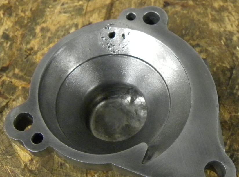

Here is where I am currently...
kx500 water pump cover modification 1.JPG (56.72 KiB) Viewed 12637 times

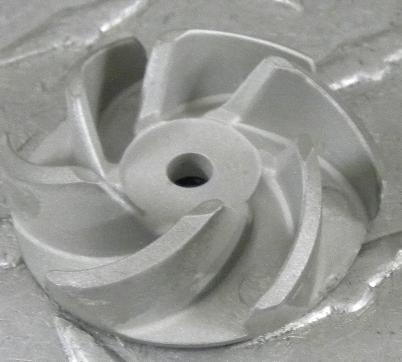

KX500 WATER PUMP IMPELLER CLEAnup.JPG (17.89 KiB) Viewed 12637 times
I took the high edges off the impeller... No biggie.

First trip to MR. Tig didn't work out so good :(
That's ok, he works right next door... :D
In all fairness he told me that he had trouble with it and this might be the result after I cleaned it up.

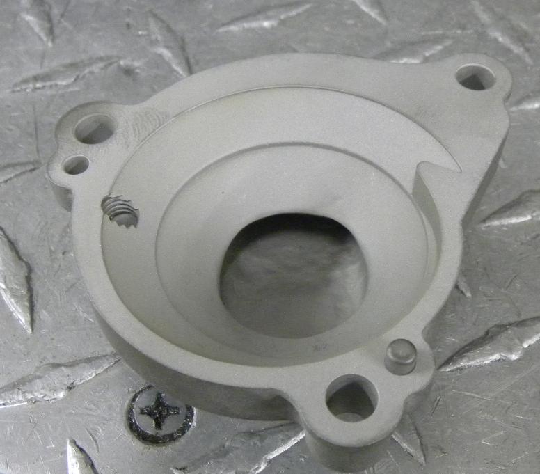

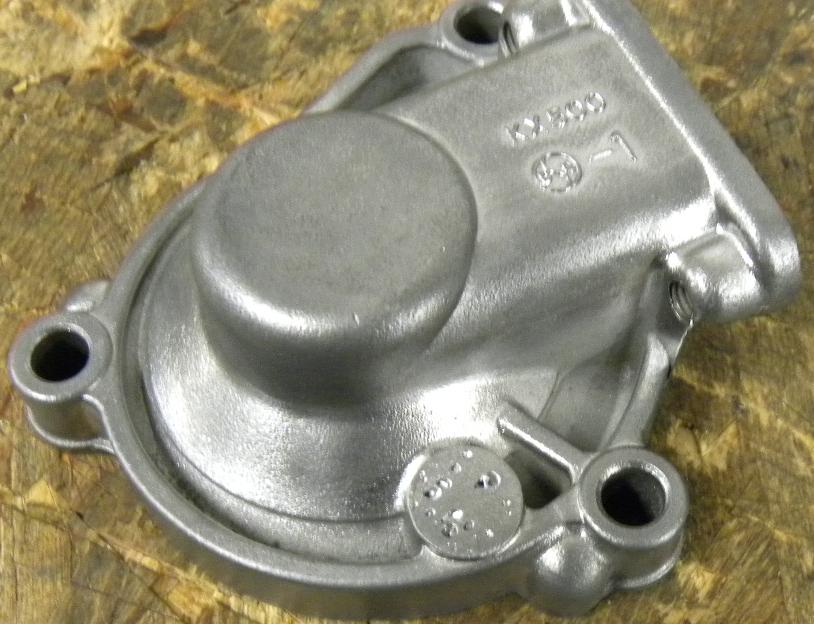

tig 1.JPG (62.28 KiB) Viewed 12618 times
tig 2.JPG (74.62 KiB) Viewed 12618 times

Looks like a nice drinkin fountain :D
