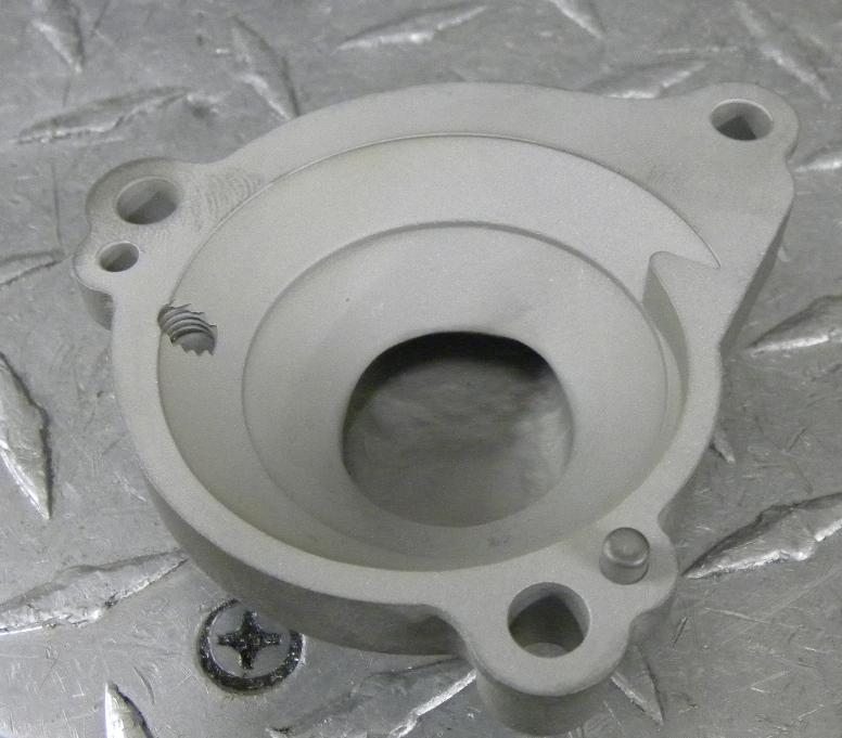

have you considered what this big ass hole does to the flow?
If I were on this mission of counting my pennys. Id tig it up, and smooth it out to match .. then if you want to drain the system, either pull the cover, or pull the lower hose...

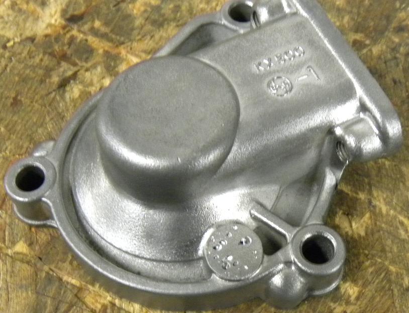

Here is where I am currently...
kx500 water pump cover modification 1.JPG (56.72 KiB) Viewed 12633 times

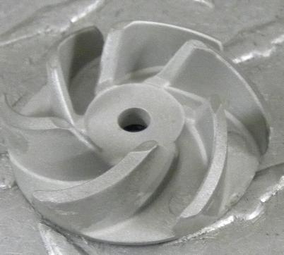

KX500 WATER PUMP IMPELLER CLEAnup.JPG (17.89 KiB) Viewed 12633 times
I took the high edges off the impeller... No biggie.

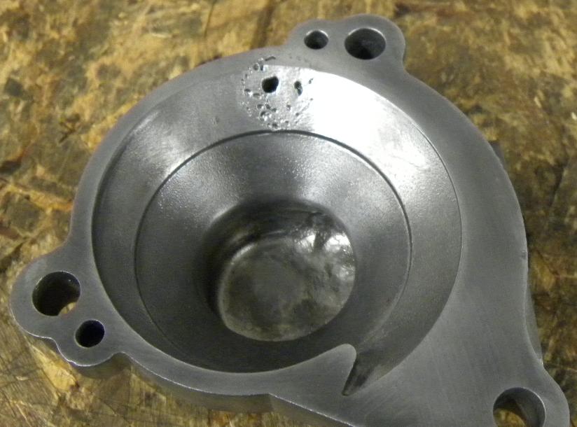

First trip to MR. Tig didn't work out so good :(
That's ok, he works right next door... :D
In all fairness he told me that he had trouble with it and this might be the result after I cleaned it up.
tig 1.JPG (62.28 KiB) Viewed 12614 times
tig 2.JPG (74.62 KiB) Viewed 12614 times
Frank The Tank
Post by Frank The Tank »
Looks like a nice drinkin fountain :D
