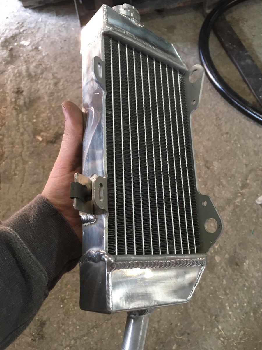

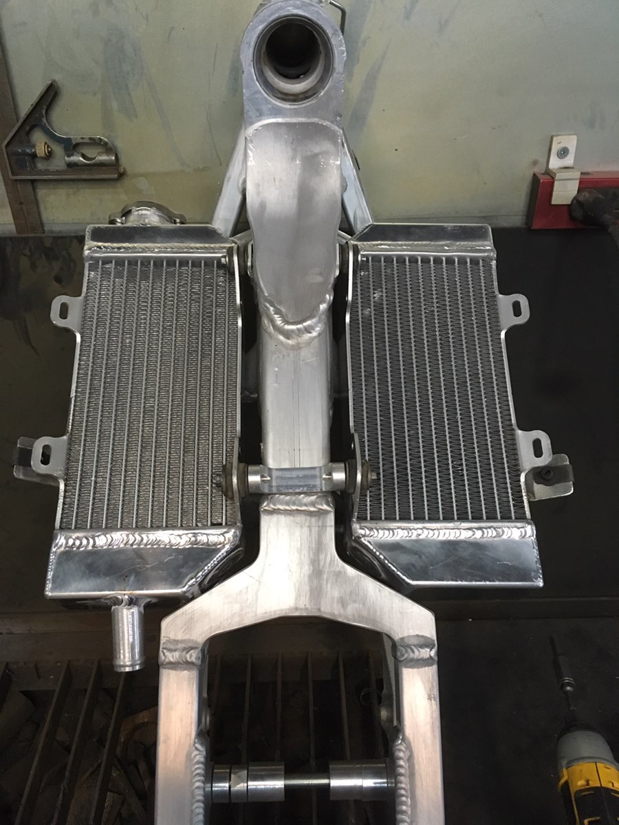

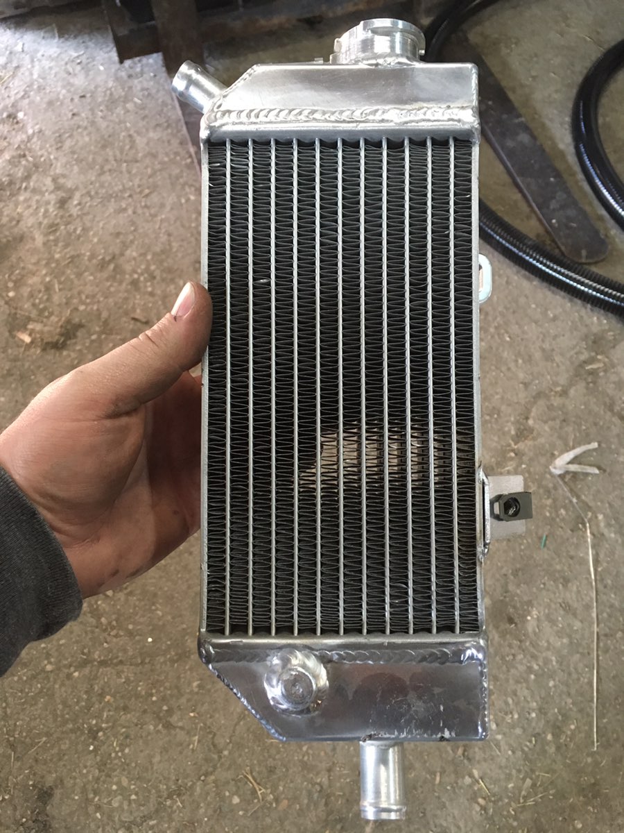

Ok, the following is not my info.
2009 KX250F chassis.
It was provided by Adam Millar as he is doing some 250f conversions..
He used CRF250R rads as the top mounting hole is in the stock position.
And all the hose outlets had plenty of clearance.
Adding the extra tab to the rads allows you to use the stock rad screens with no other mods and no zip ties :shock:
Once mounted you will not be able to see the double mounting bracket.
The flow is in lower left of the head, crosses the top, goes to the water pump
