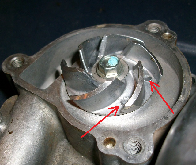

I'm also wondering if we shouldn't clean up the casting imperfections on the impeller..
cleaning up the slag...png (711.96 KiB) Viewed 12602 times
I know it's a small thing but I bet they all add up..

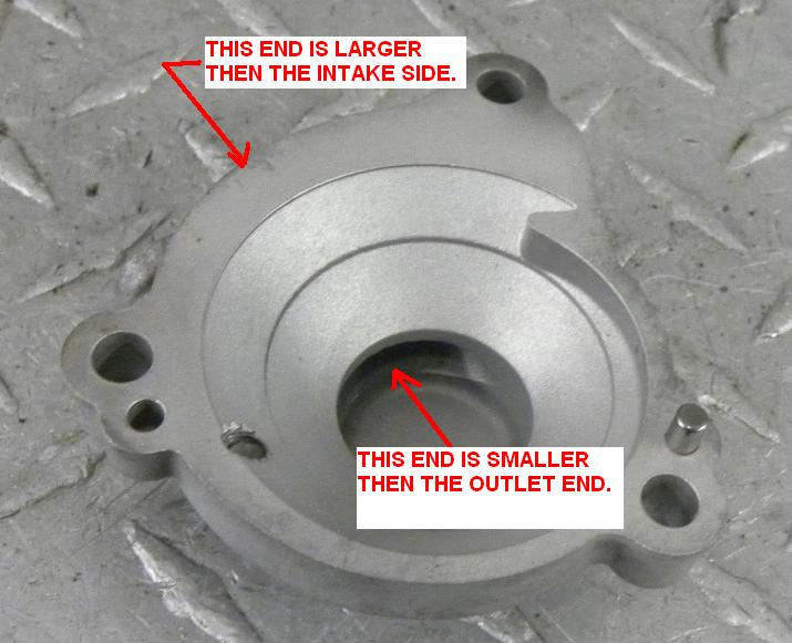

Didn't know this till a few minutes ago but regarding the water pump cover, the area just past the impeller is smaller then the outlet side.
WATER PUMP.JPG (56.67 KiB) Viewed 12575 times
I know I'm throwing more pennies at a million dollar problem but sooner or later the pennies should equal a buck or so :D
