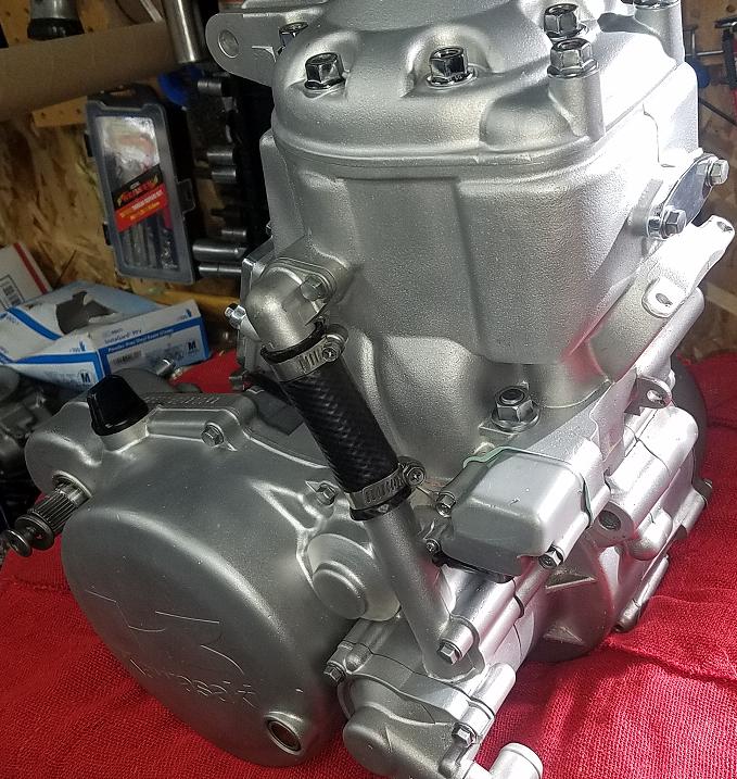

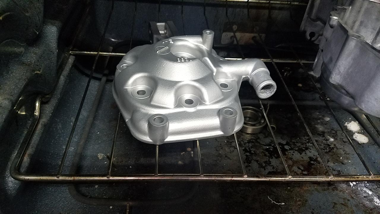

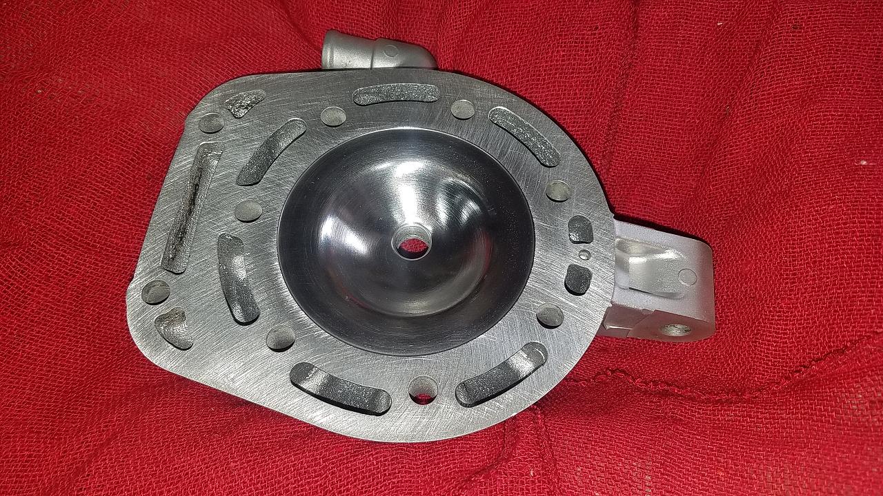

The next item was the head.
After Vapor Blasting the head we baked it for about 30 minutes at 200F to be sure all the water that gets pushed into the pours of the surface metal was completely gone.
KX GURU RACING SEAN COLLIER KX500 231.JPG (147.65 KiB) Viewed 16073 times
After baking I went ahead and semi polished the combustion chamber.
I didn't put a high polish on it because we will be completely rebuilding this engine in a few months and make it something to be respected on the MX track.
KX GURU RACING SEAN COLLIER KX500 232.JPG (313.42 KiB) Viewed 16073 times

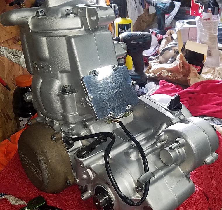

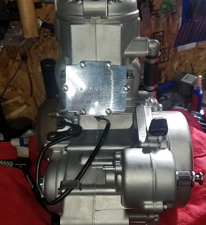

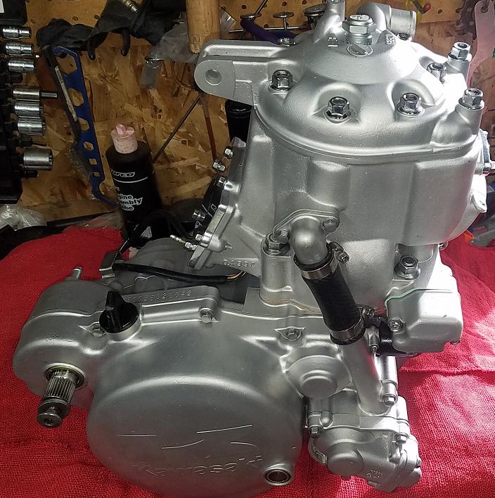

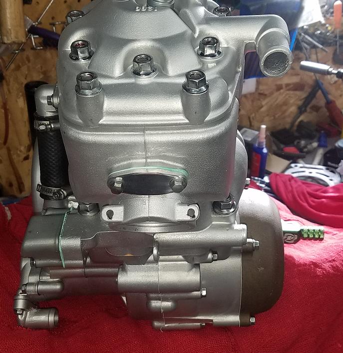

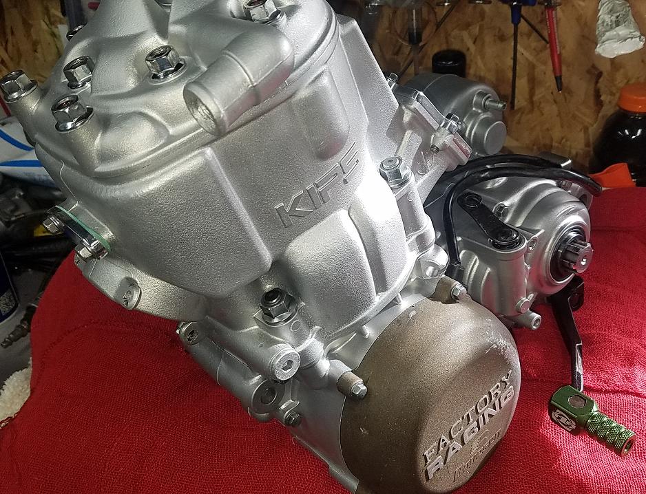

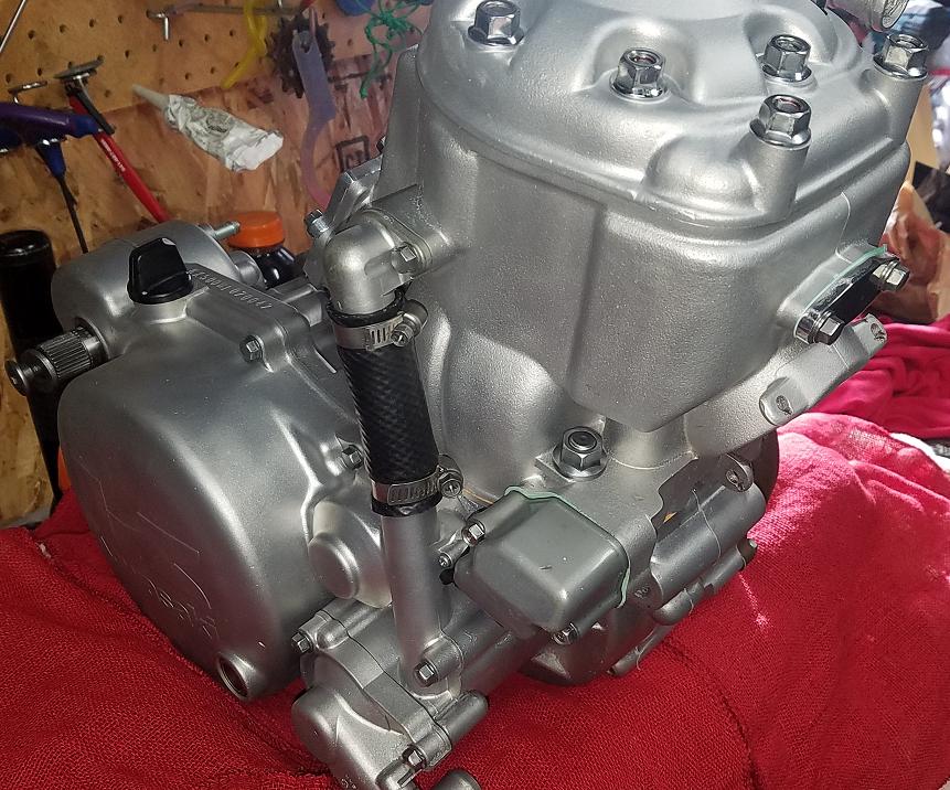

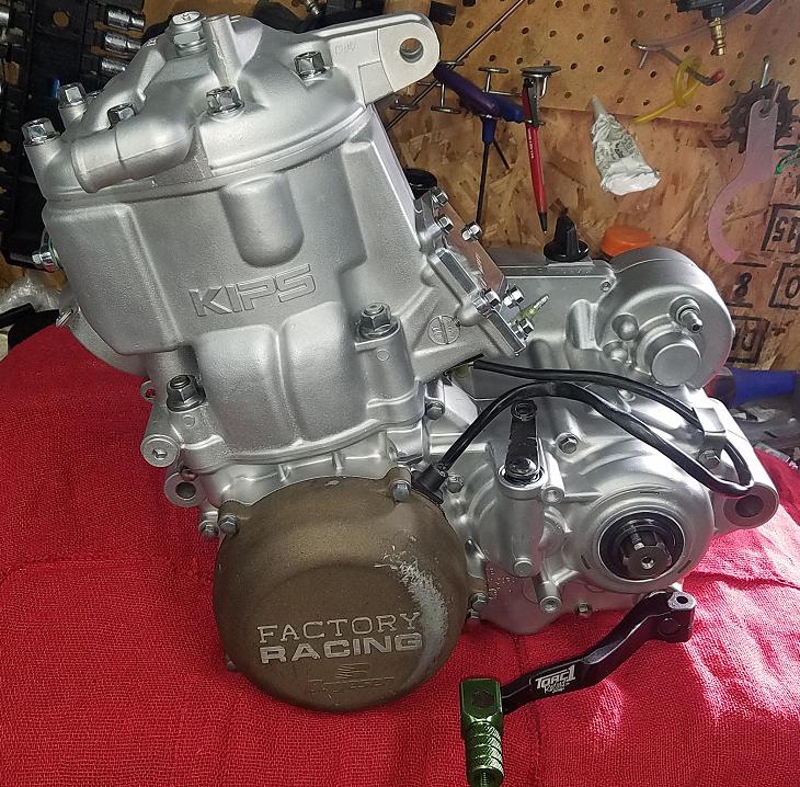

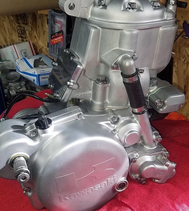

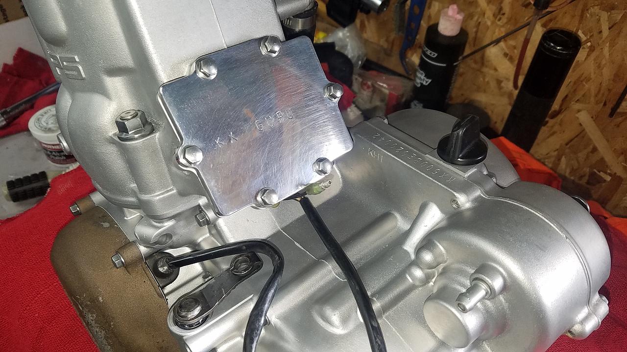

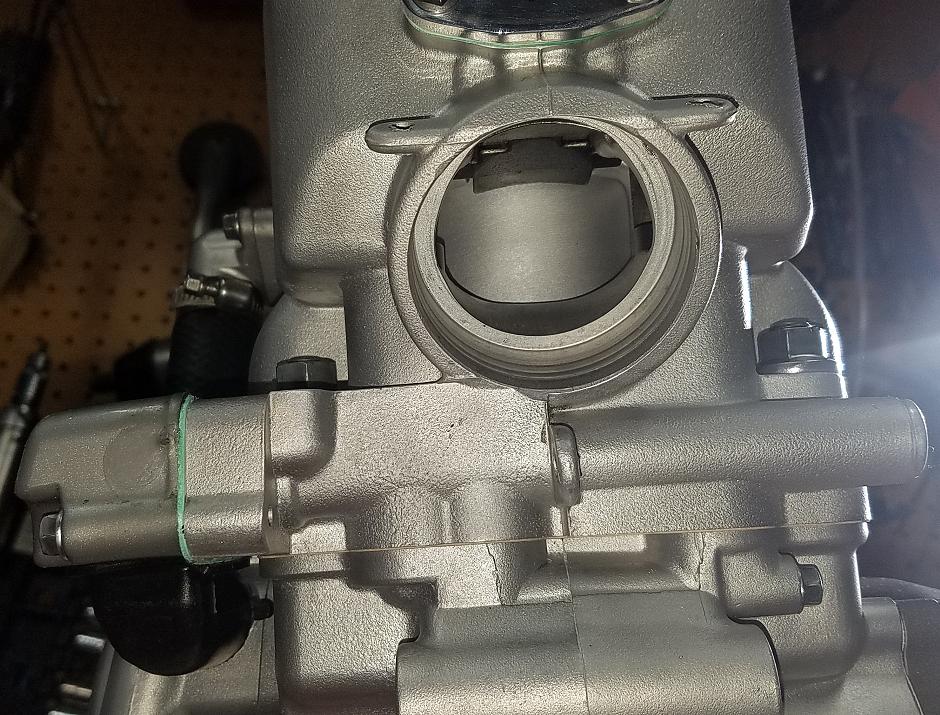

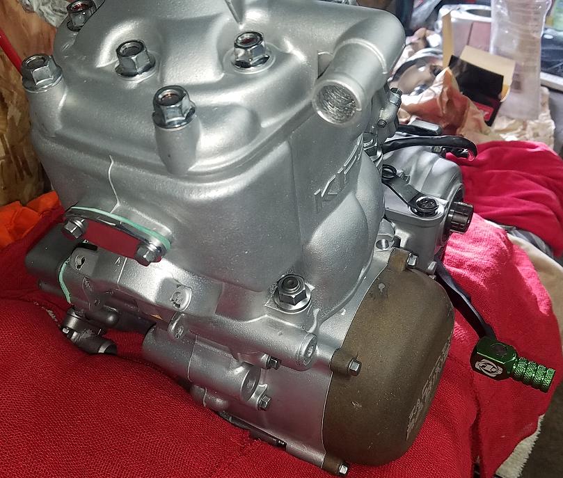

Here is several shots of the engine...
KX GURU RACING SEAN COLLIER KX500 234.JPG (131.57 KiB) Viewed 16072 times
KX GURU RACING SEAN COLLIER KX500 235.JPG (129.01 KiB) Viewed 16072 times
KX GURU RACING SEAN COLLIER KX500 236.JPG (188.84 KiB) Viewed 16072 times

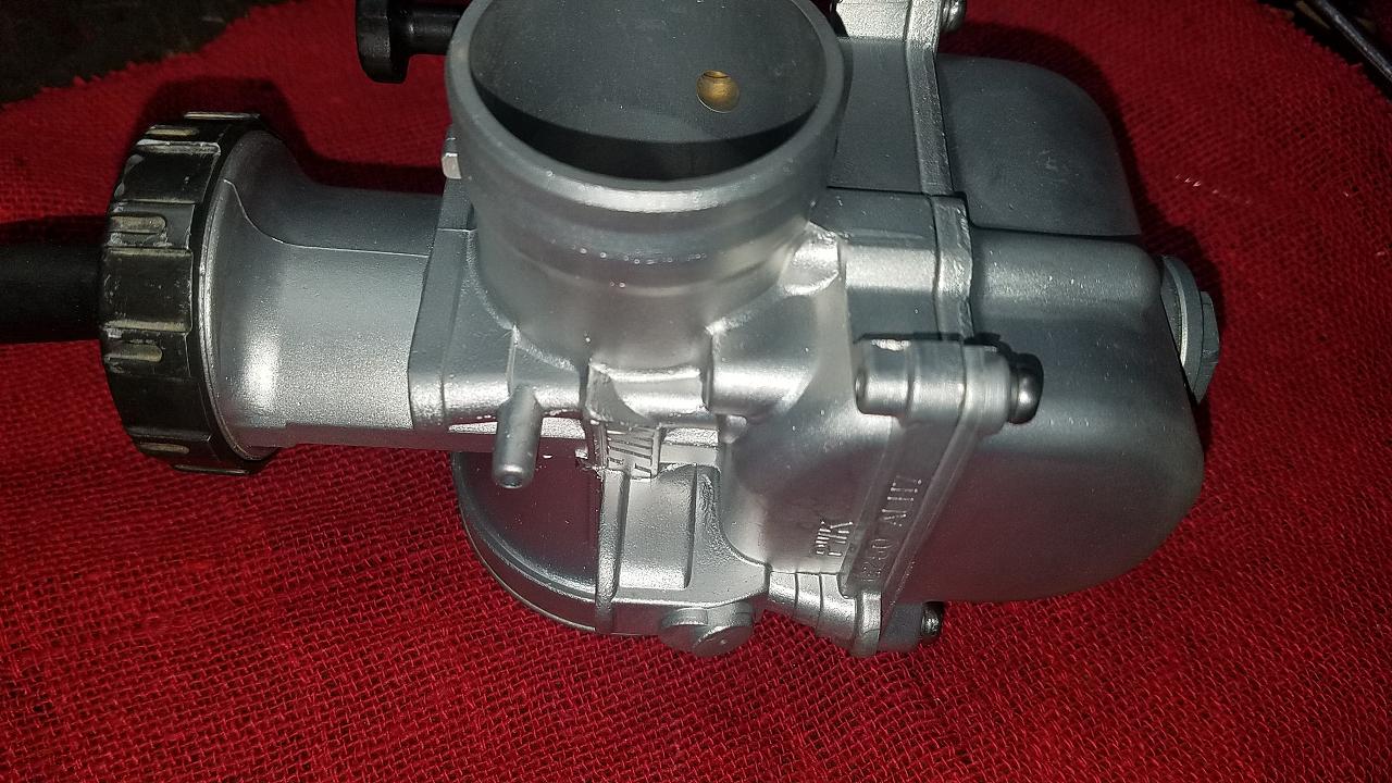

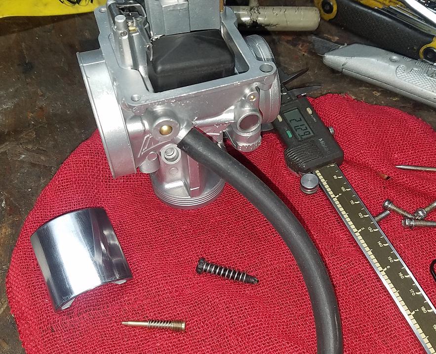

Carburetion....
It was dirty and the floats were too low causing a lean condition.
It is a very common problem.
But after a bit of time we were able to make it ready to go again..
We disassembled, Vapor blasted, Cleaned everything spotless, polished the slide, set the float height and reassembled using the same settings the carb had to begin with.
Yes, we actually record before disassembly :o
kx guru racing sean collier float height.jpg (479.79 KiB) Viewed 16056 times
KX GURU RACING SEAN COLLIER KX500 281.JPG (186.71 KiB) Viewed 16067 times
KX GURU RACING SEAN COLLIER KX500 282.JPG (182.78 KiB) Viewed 16067 times
KX GURU RACING SEAN COLLIER KX500 283.JPG (182.22 KiB) Viewed 16067 times
