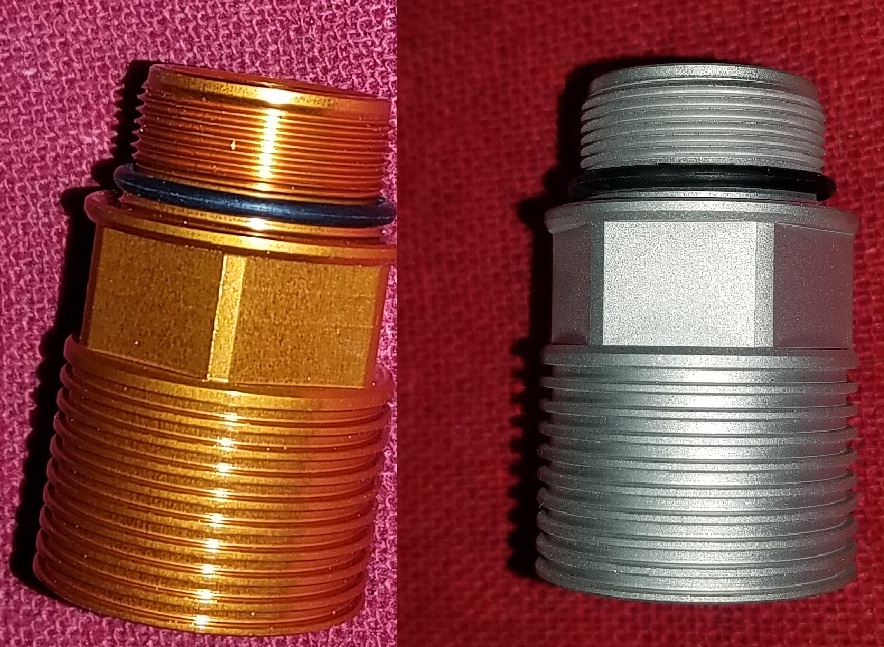

Some parts for the KTM only come in Pumpkin hide or black..
So, I blew the pumpkin hide right off this brake cooler with the vapor blaster..
KX GURU RACING 2016 KTM 250SXF KX500 CONVERSION 182.jpg (284.16 KiB) Viewed 10029 times

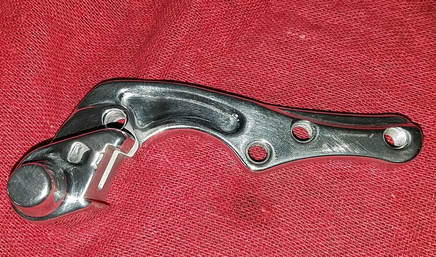

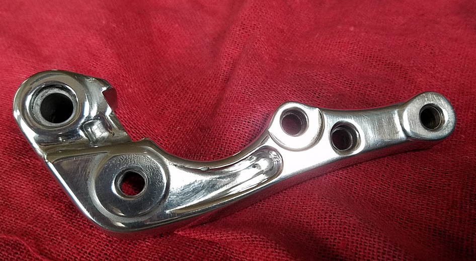

Ok... Finally have the front brake caliper mount ready to anodize..
KX GURU RACING 2016 KTM 250SXF KX500 CONVERSION 188.jpg (249.56 KiB) Viewed 9981 times
KX GURU RACING 2016 KTM 250SXF KX500 CONVERSION 189.jpg (413.75 KiB) Viewed 9981 times

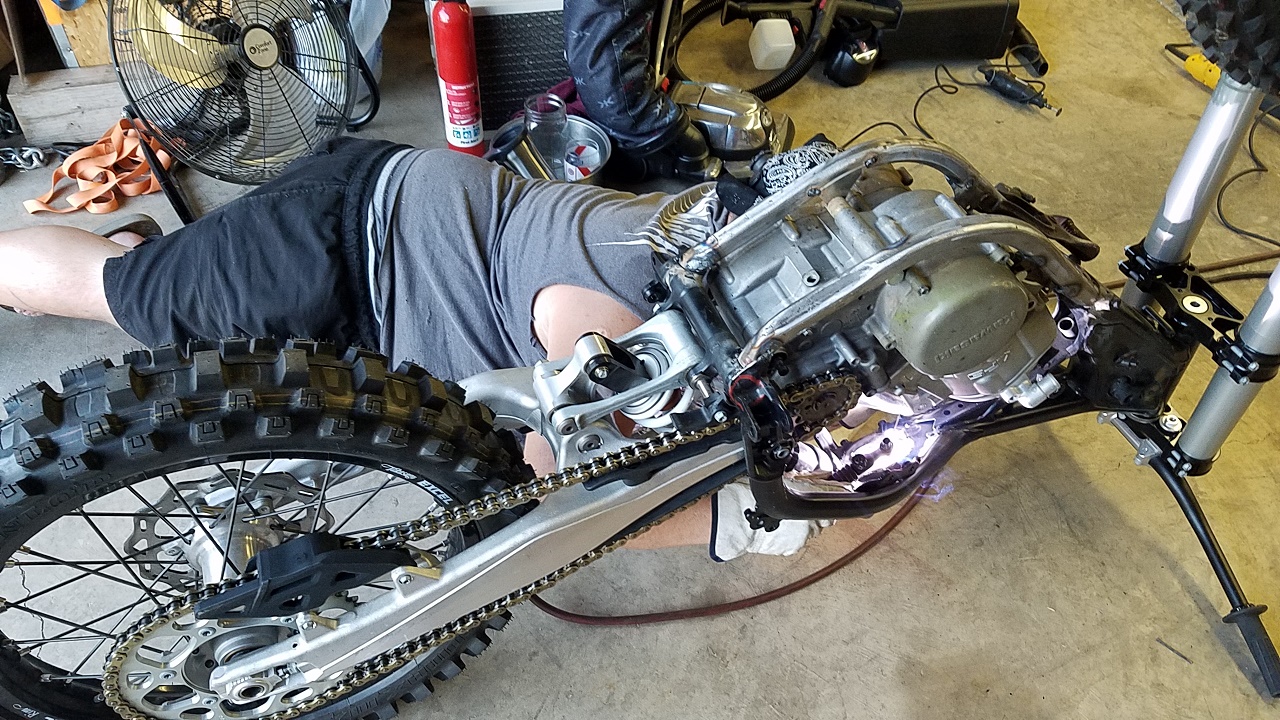

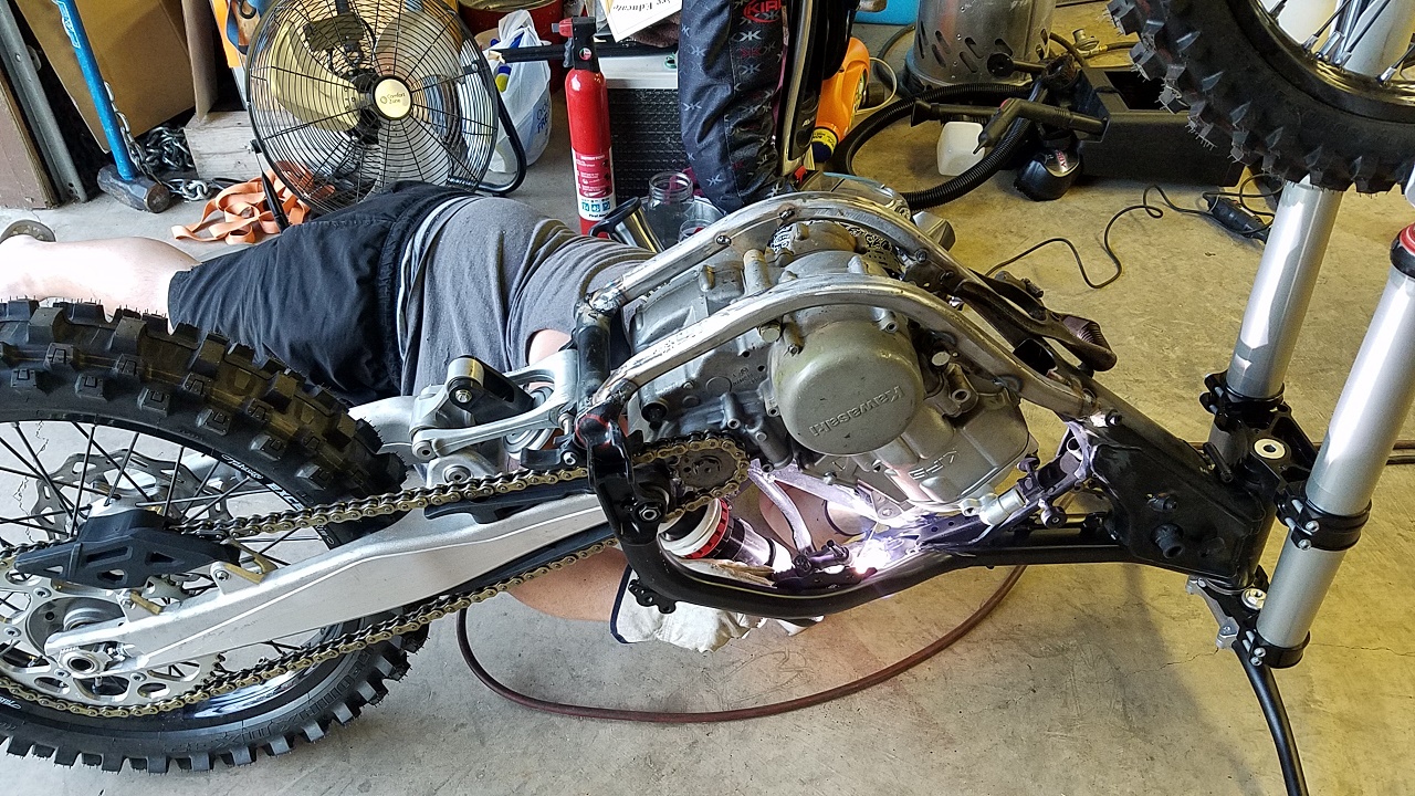

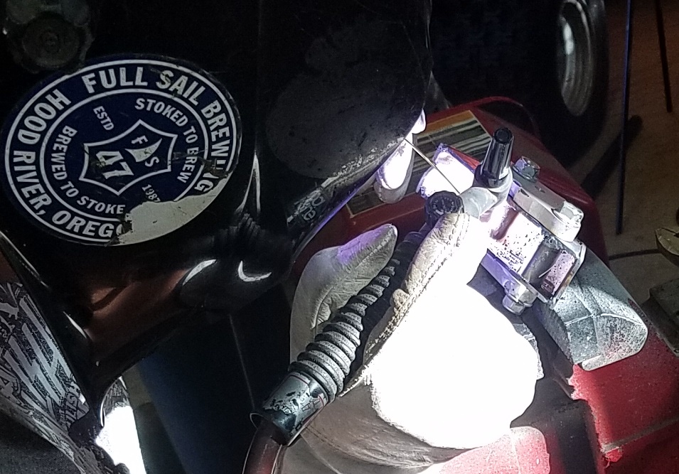

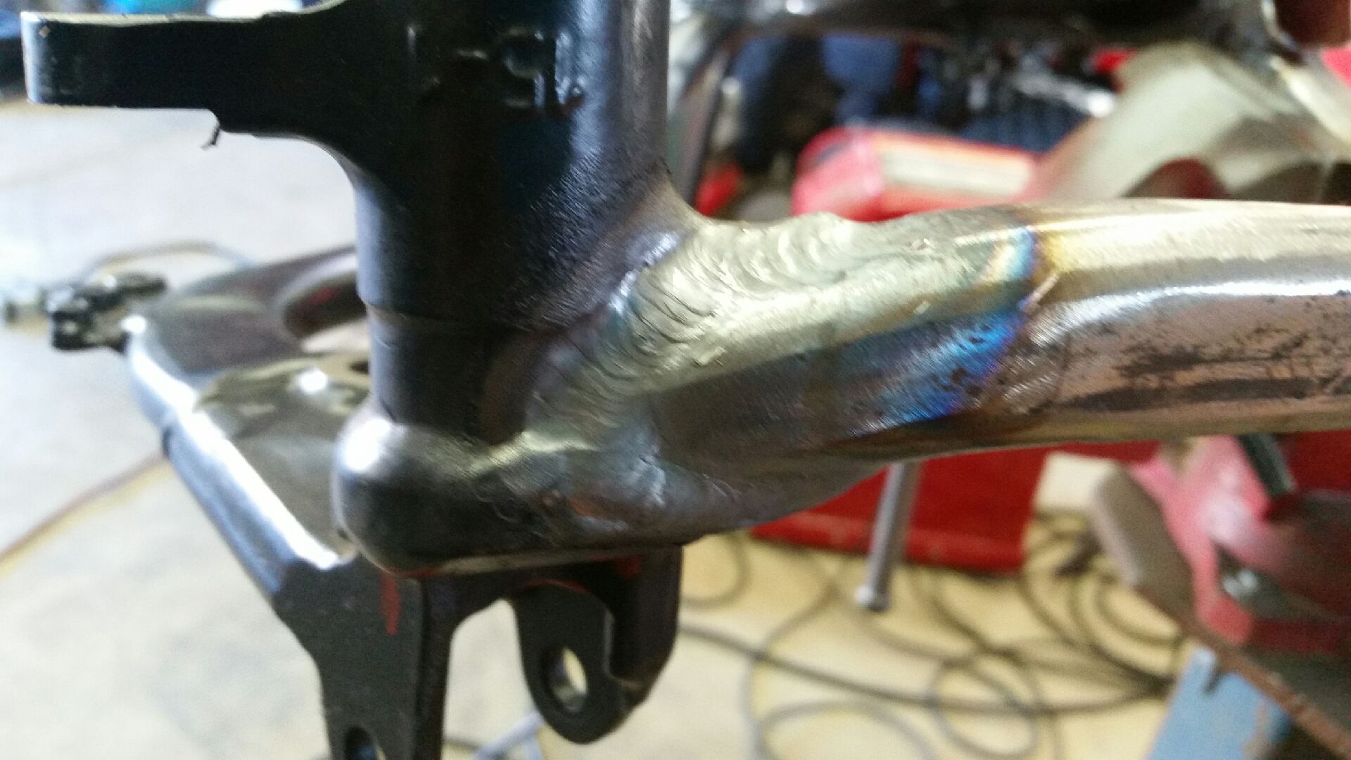

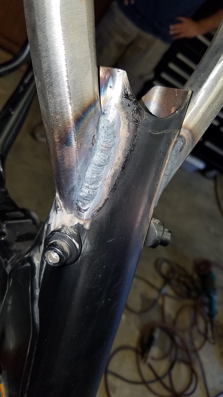

So, I finally brought the frame over to my bud's VInce and Travis place for some weld work..
KX GURU RACING KTX500E BUILD 101.jpg (527.44 KiB) Viewed 9890 times
KX GURU RACING KTX500E BUILD 102.jpg (500.17 KiB) Viewed 9890 times
KX GURU RACING KTX500E BUILD 103.jpg (252.86 KiB) Viewed 9889 times
KX GURU RACING KTX500E BUILD 105.jpg (532.24 KiB) Viewed 9889 times
KX GURU RACING KTX500E BUILD 106.jpg (568.66 KiB) Viewed 9888 times
A little bribery never hurts...
KX GURU RACING KTX500E BUILD 107.jpg (485.85 KiB) Viewed 9888 times
KX GURU RACING KTX500E BUILD 108.jpg (561.8 KiB) Viewed 9888 times
Hmmmmmm????
Tiggen it up :-)
I found out last night that the welder is doing 3 passes with the tig.
He starts with a very small diameter rod so that he can get deep penetration into the crack where the two parts come together.
He does this in short weld sections to allow for cooling.
Tigging short sections then moving to another part that needs to be tigged, working his way around the frame until all the parts are fully welded has many benefits.
After the welds are fully done, he increases the tig rod diameter and starts process again.
I had no idea but it makes sense.
Keeping the chromoly cool will help to keep it from getting needlessly annealed.
