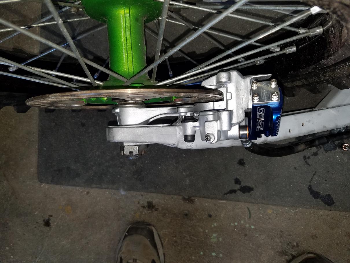

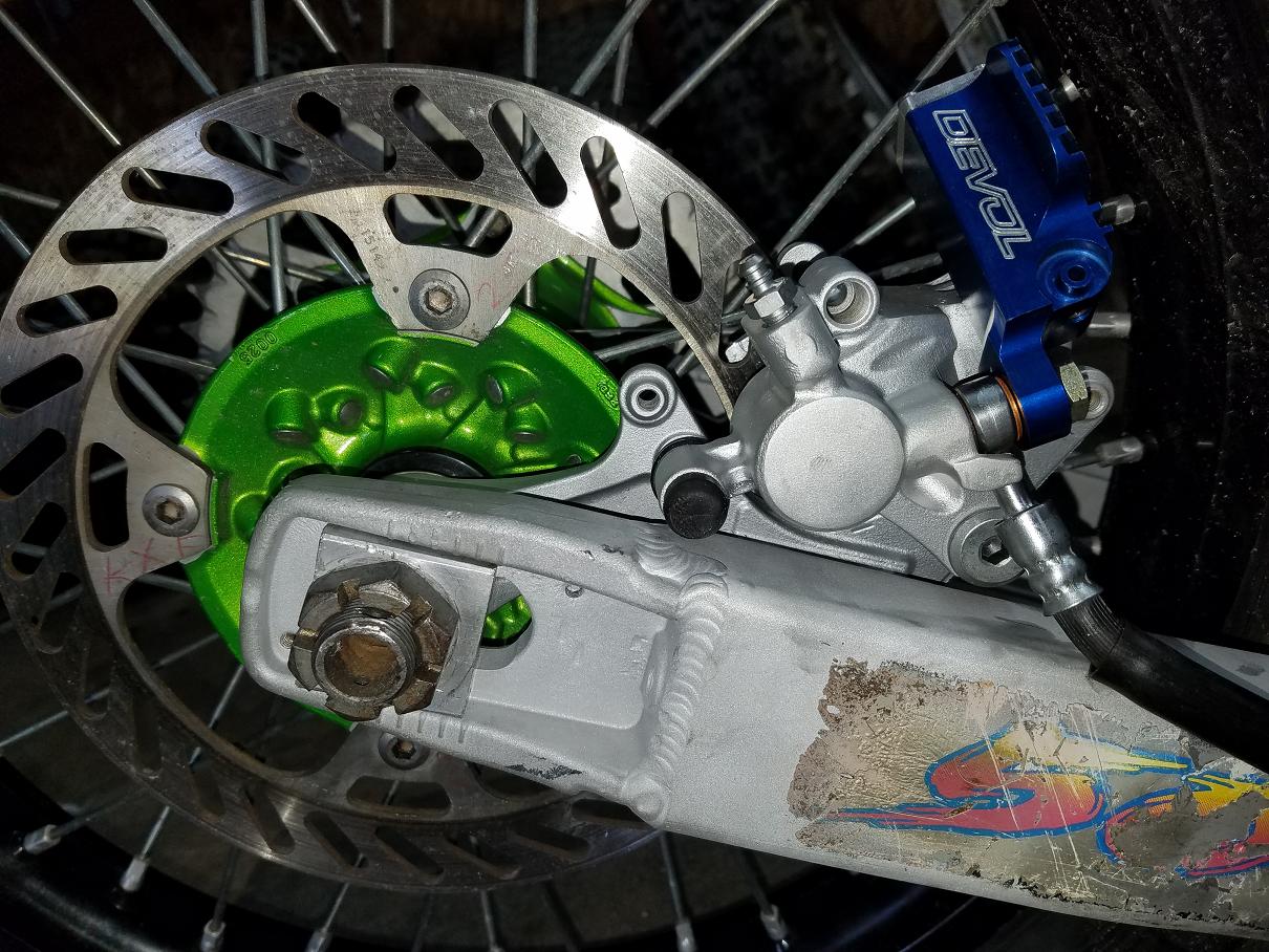

Got the top of the caliper decked so that the heat sink would sit flat on it.
The trimmed the heat sink to size and started whittling on it.
The idea is to angle the slots so that the air is pulled down and through the caliper, rotor, and pads.
Keep in min that this is very rough... I will be doing a lot of clean up before I'm done
