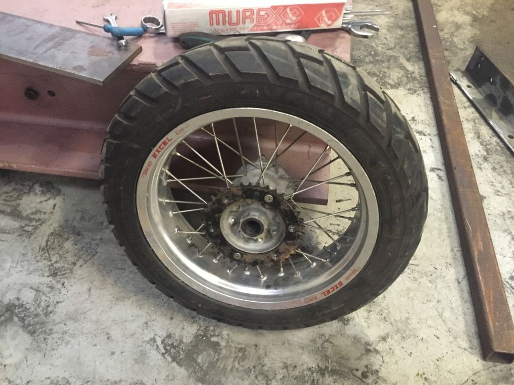

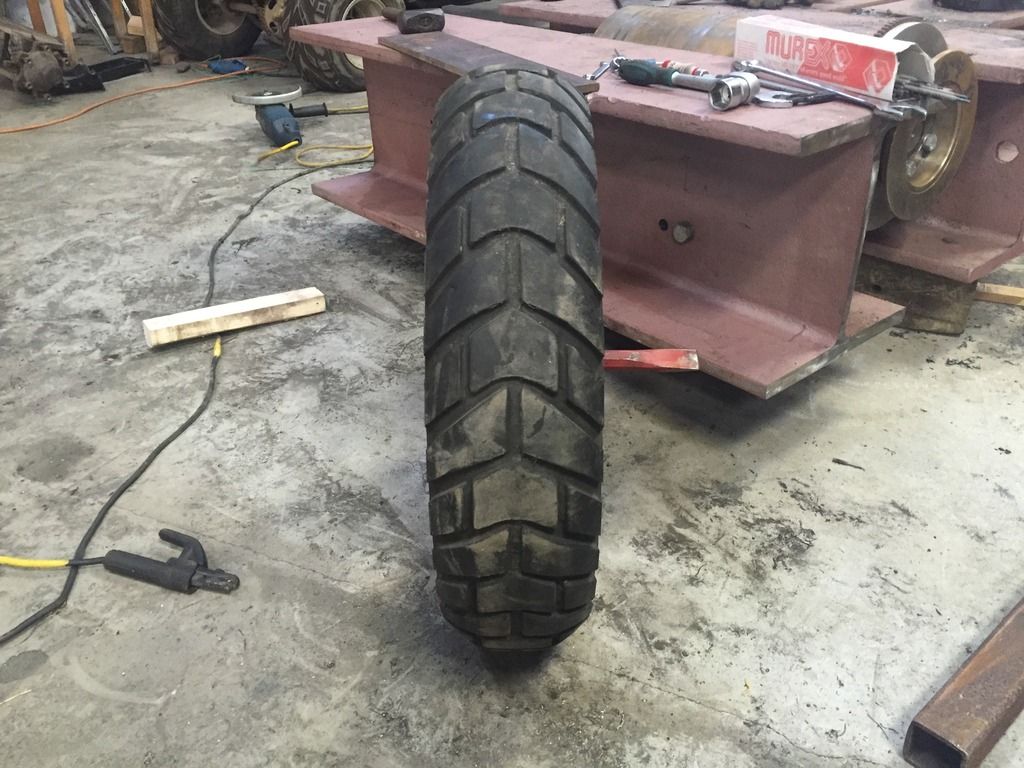

Not much of an update but it is what it is. I was home for a few hours and while in the shed I spotted this wheel and tyre, it gave me an idea.
I have been wondering what to do about the rear tyre of the KLX, I have a Michelin racing wet mounted on the bike just now which I initially thought would be an ideal choice but have now found out that sticky tyres can be quite power robbing on the dyno. So I was looking for a tyre to fit, then I noticed the tyre that came off the KLX originally, a 130/80-17, a little bit worn but not much. I had a pair of supermoto rims on crf450 hubs, the rim is 5" but I thought I would mount the tyre on and see how it looks. Well you can see it went on, I think it looks ideal, opening out the tyre beads has flattened the worn bit even more and the tyre can stand on its own now. I will see how it goes, at least fitting this will mean the Michelin wet won't get torn up on the roller.
I also intend to knurl the roller. I'm going to make a device to press knurls on to the roller to form a surface profile, something that will come off and be able to go back on again to do the job again if the knurling gets worn off.
Hopefully back to dyno building at the weekend.

If you are putting heat Ito the tyre then that's energy lost. I think the tyre pressures should be increased too.
That wheel has no Cush drive though so it's not ideal, but it was there and so was the tyre. See how it goes.

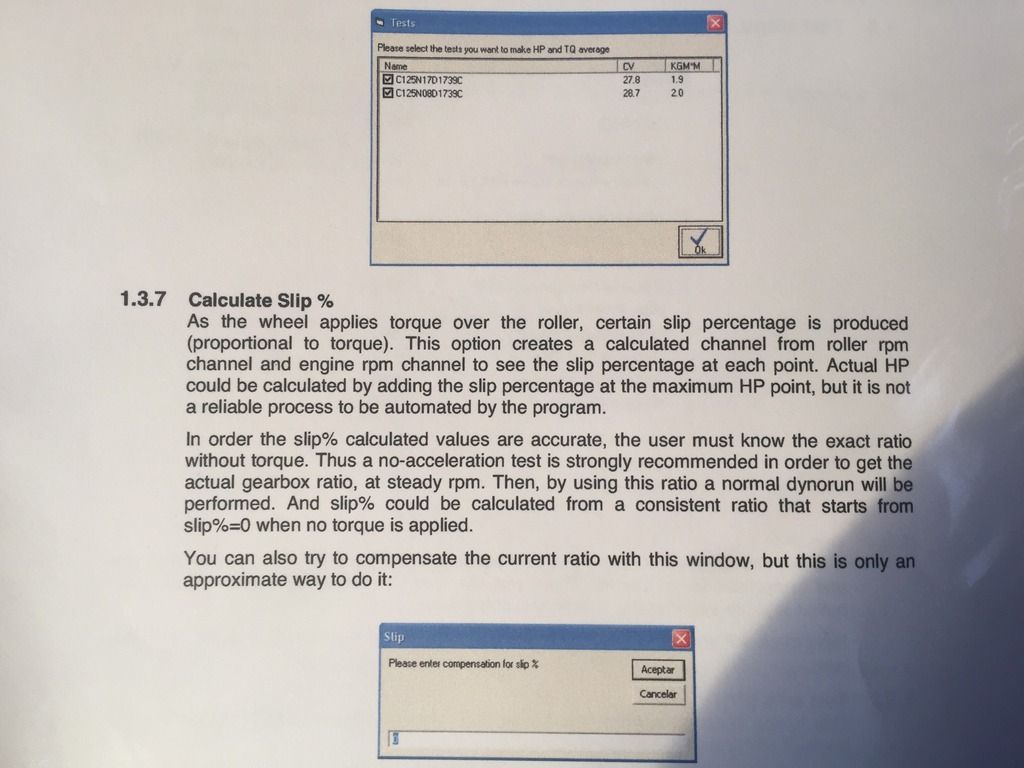

There is a lot to setting up this dyno, I might have known, with it being an entry level commercial set up, there is a lot of detail in it. It has a pickup clamp you put on the plug wire, so it has a rpm feed. You can tell if you are getting tyre slip and how much. But I think that's a test on its own then you have to enter that figure in for sucssesive tests.
You can also feed in info from the oxygen sensor, exhaust gas temp, water temp, boost, etc, basically k type thermocouples and 0-5v sensors. And it would seem you can include that info on the power graph.
But the guy who is the uk agent has dragged his heels at every point. I have not been on at him about it enough though, the main interface unit I paid for it and I did wait a month before I phoned to enquire where it was. I'm still waiting for the weather correction thing. That was ment to come with the interface itself.
I hope the set up part goes smoother. I can see that being a bit of time too, not just a mornings work and away we go.
