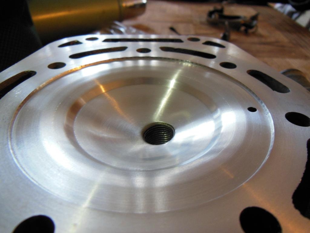

A little CC work...
KX500 JEFF WARD ROUND 3 REBUILD 1078.jpg (137.42 KiB) Viewed 9138 times

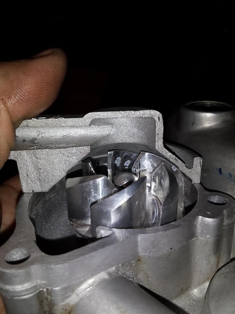

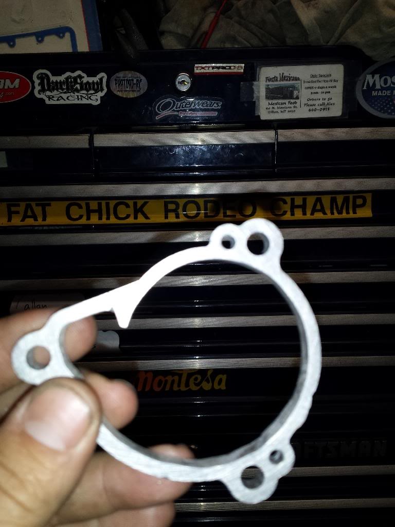

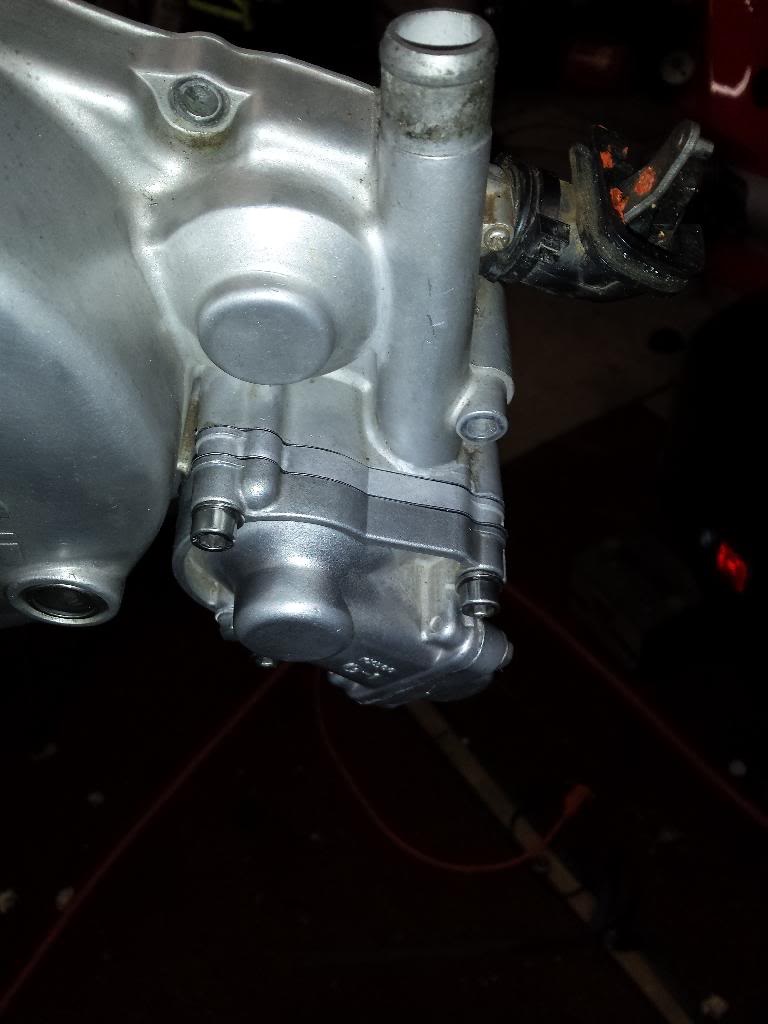

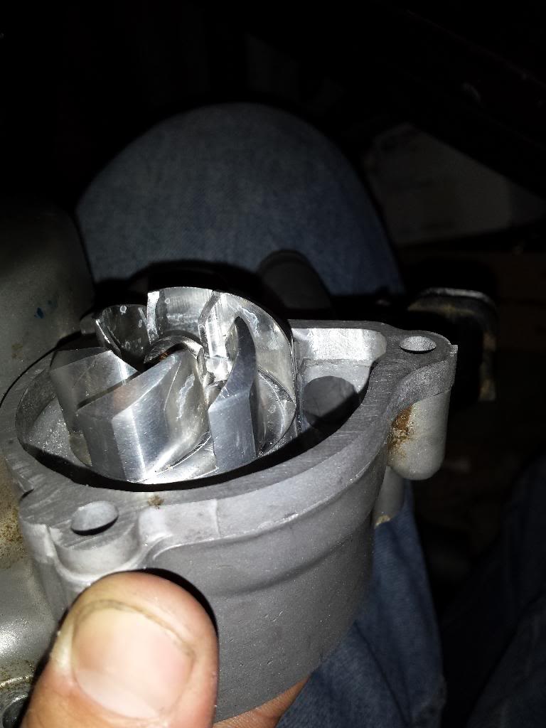

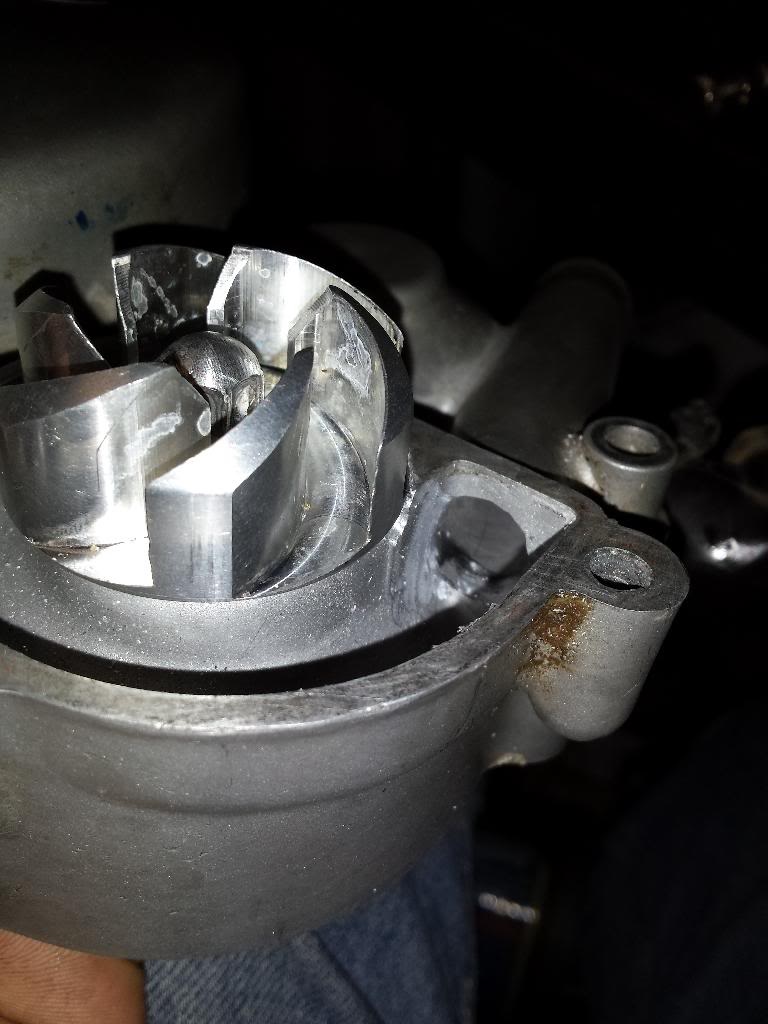

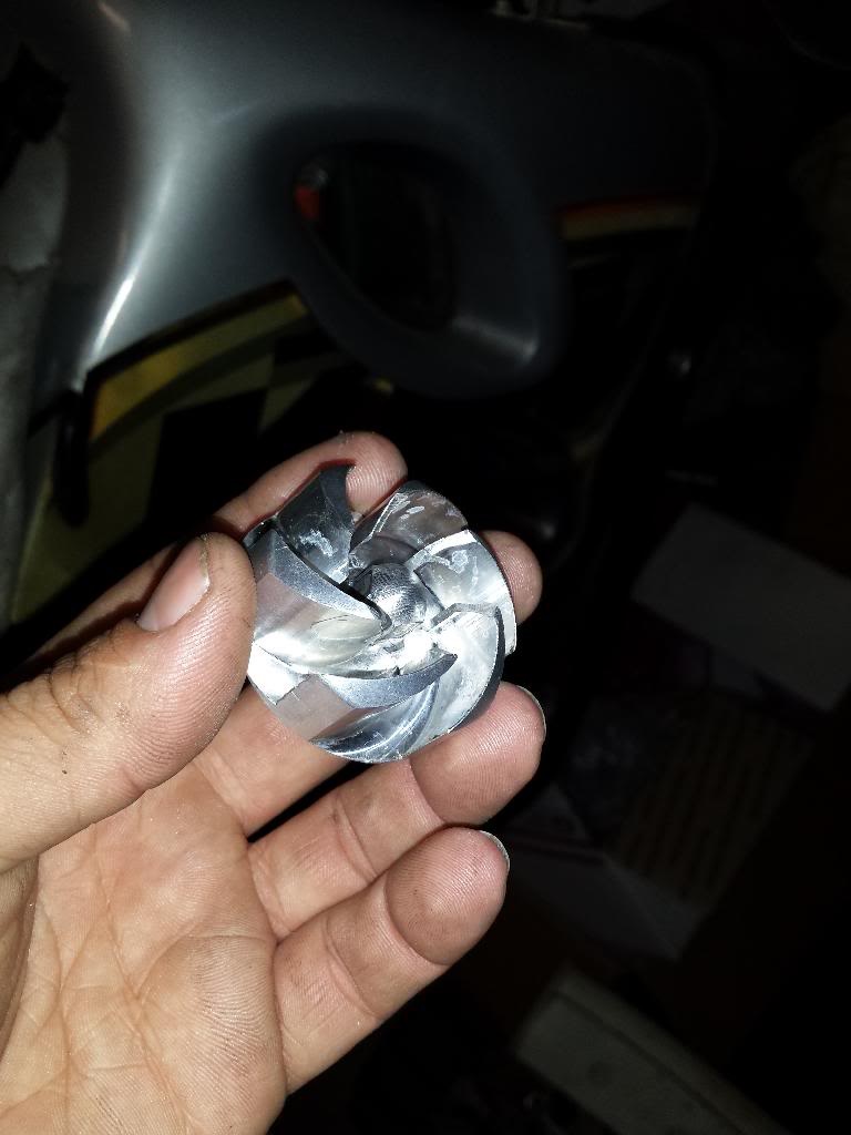

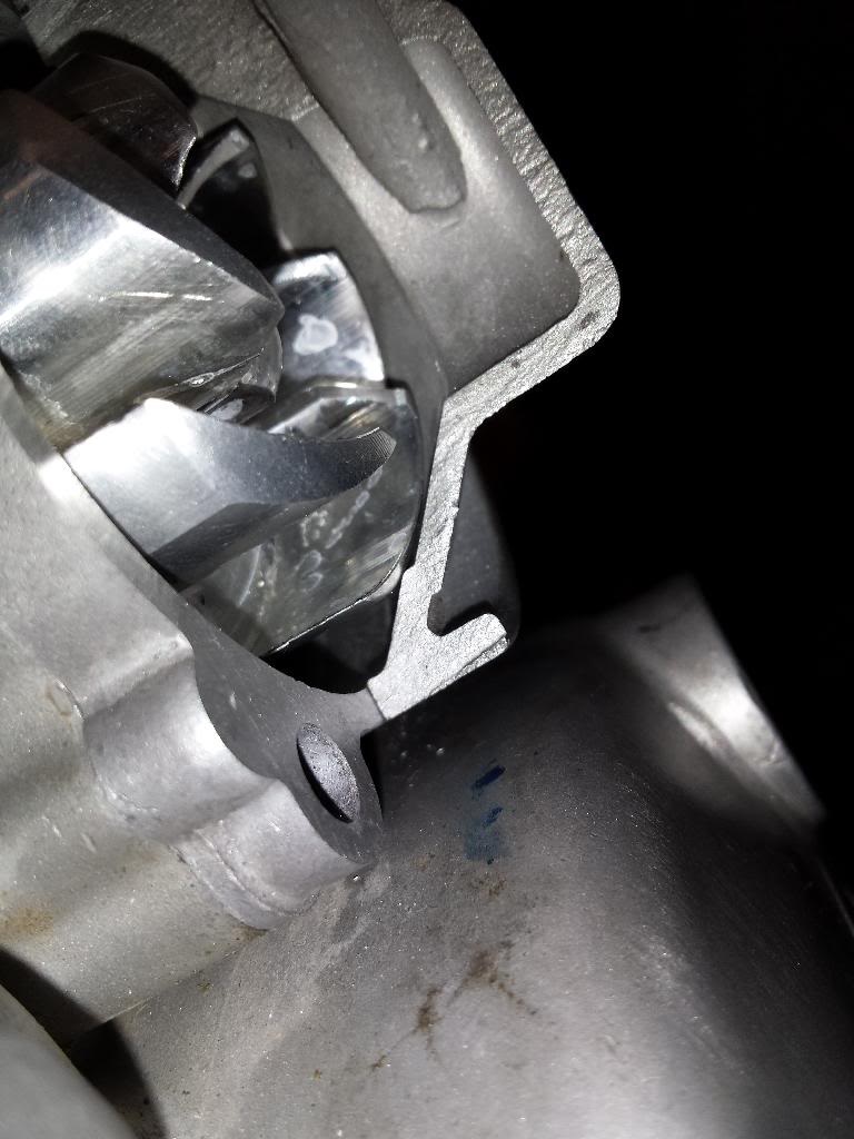

Factory looking water pump mod..
KX500 JEFF WARD ROUND 3 REBUILD 1079.jpg (113.1 KiB) Viewed 9138 times
I see something happening..
KX500 JEFF WARD ROUND 3 REBUILD 1080.jpg (98.77 KiB) Viewed 9138 times

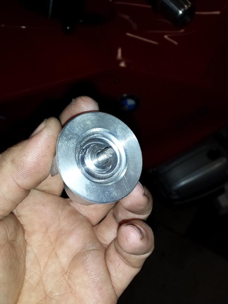

sandblaster
Threaded rod or cut off bolt?
KX500 JEFF WARD ROUND 3 REBUILD 1081.jpg (63.35 KiB) Viewed 9138 times
Motorrad
5mm to 6mm. Grade 8 adaptor

Final mock up to check port time on all new parts. My math was good Timing is on the money. And to mark piston for final mods
KX500 JEFF WARD ROUND 3 REBUILD 1082.jpg (181.36 KiB) Viewed 9138 times
dave916
what port timing are u running?
Motorrad
Dropping back down to 191. Was up at 199. But I also have more variance on my kips than stock (more range).
Motorrad
199 made a awesome ride and killer dunes motor. But for real world desert 191 was my favorite riding motor

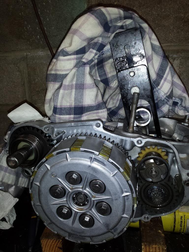

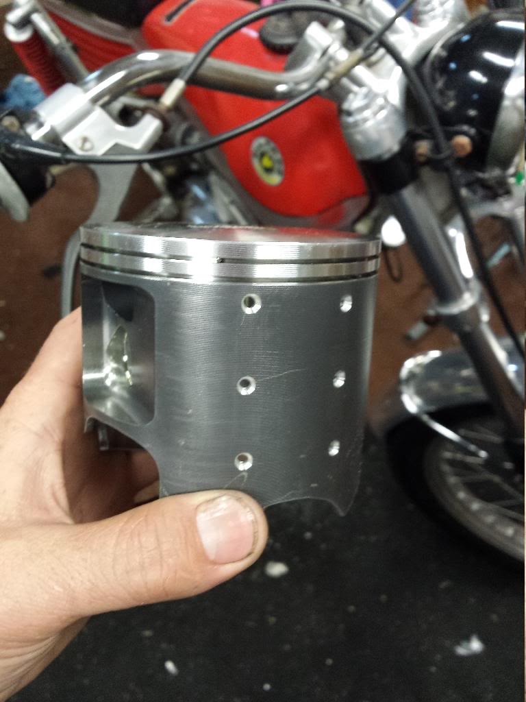

Spent the better part of the evening installing my pingle petcock. Doing more piston mods (not done yet).
And finding all the brackets that make my team green radiators fit the bike. As well as a few hours on the couch with some tweezers straightening radiator fins

Ring end gap check seconds before final assembly............. .011" hmmmm somthing is wrong.
Break out the bore gauge. Hmm 90mm forged piston should have more than .0015" clearance.
why is it always me that gets shotty parts, or workmanship?

Okay. took VERY carefull measurements. even broke out my GOOD measurement tools. and let everything sit in a 70deg room for 24 hours before I measured. (yes I dissconnected the thermostat from the wall, and brought it into that room, and set it next to all the parts)
Bore 3.5407"
Piston 3.5433"
Clearance of .0026
wossener wants 0.00275"
so a squeeeek tight. (less than most people can measure)
but not the drastic ammount that is throwing off my ring end gaps.
Hmmm
Found my problem. Time to break out big pink
