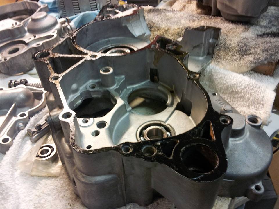

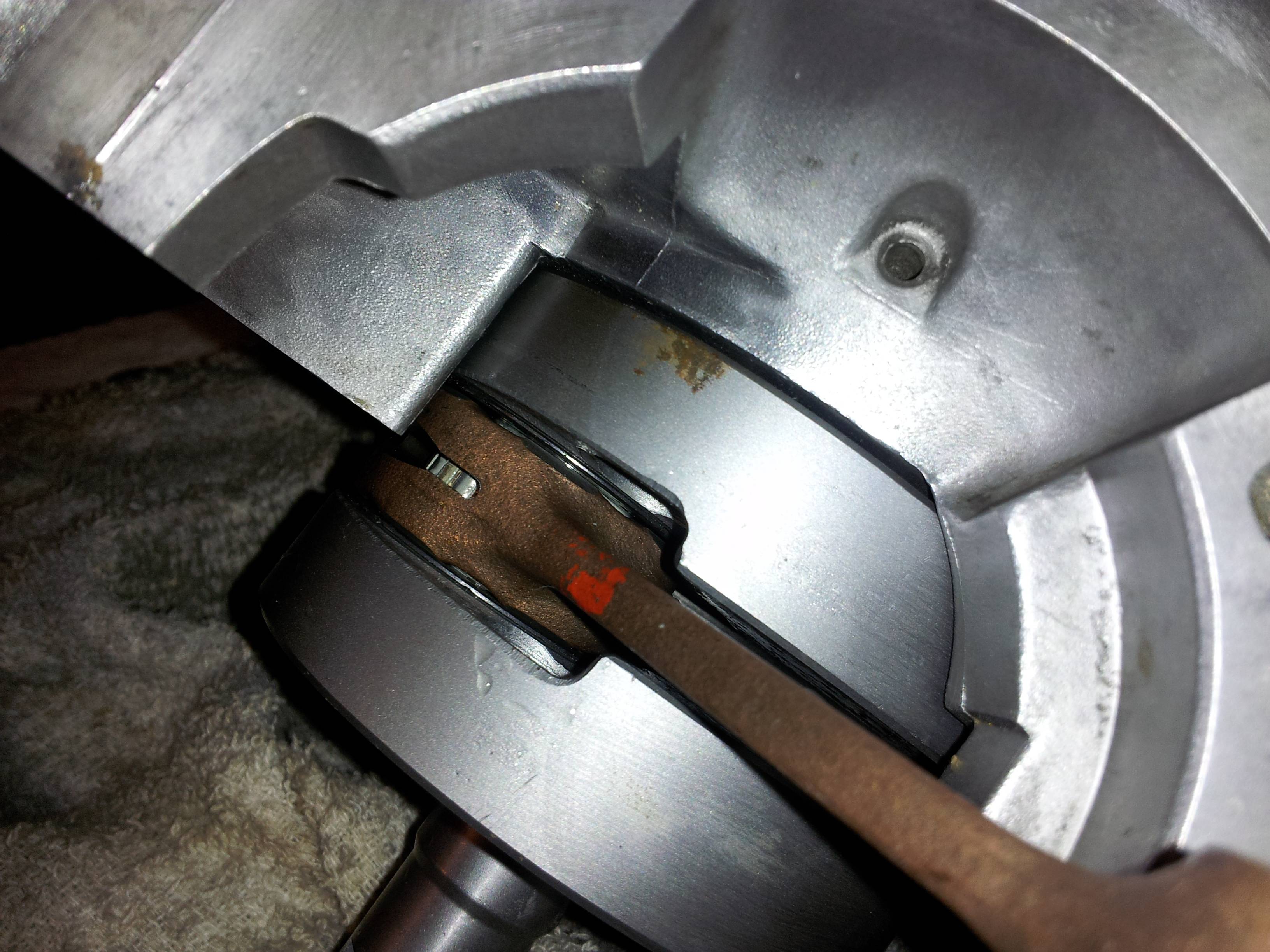

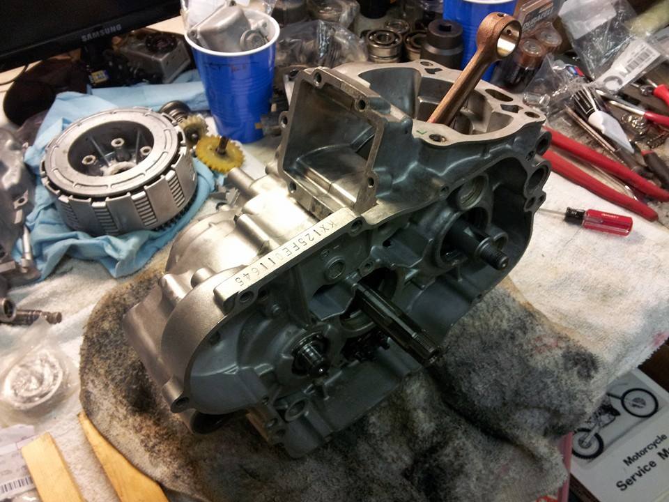

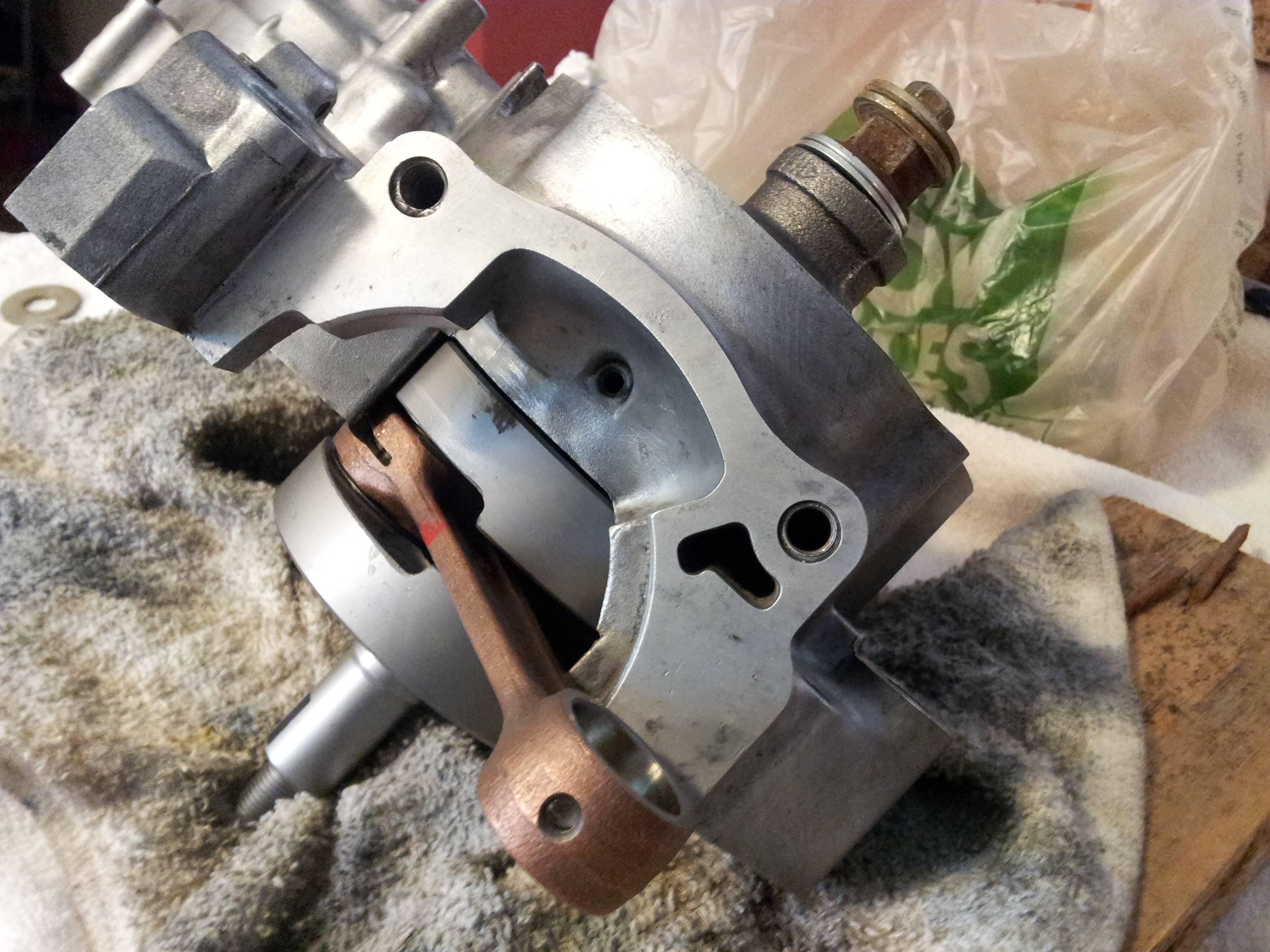

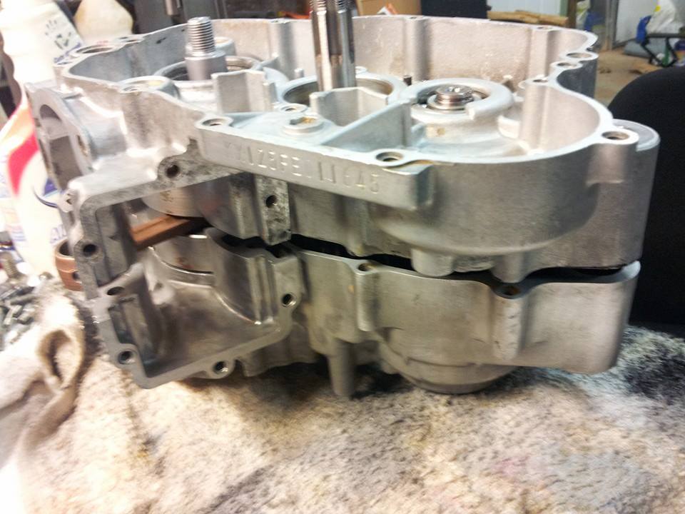

Need some advice/input.
How close should the crank half come to the case? I'm using the puller motojason suggested above. Will the crank half bump up against something before it touches the case?
Crank is rotating freely as it sits:
motojason's puller (well not his, but one like it :D )
Last edited by queen of spades on Sun Nov 23, 2014 1:27 pm, edited 1 time in total.
queen of spades
Posts: 7
Joined: Wed Oct 29, 2014 1:45 am
Re: Queen of Spodes 89 KX125 Kawasaki complete rebuild
Post by queen of spades »

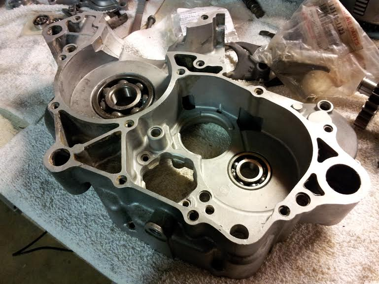

Clymer said to pull it in until it bumps up against the bearing - did that and it spins freely.
Checking out the shift drum & forks:
https://www.youtube.com/watch?v=le7_fOPx9wc

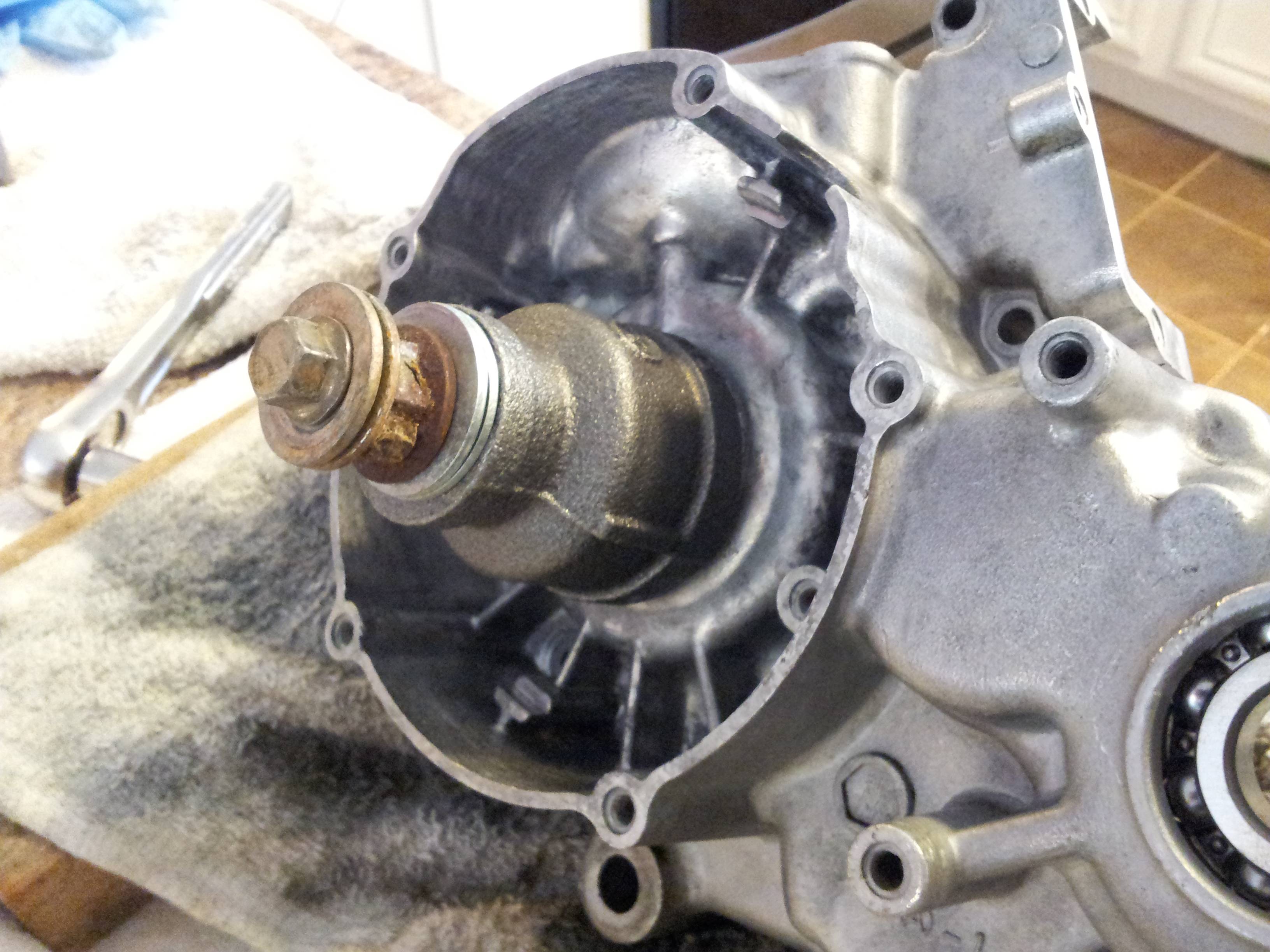

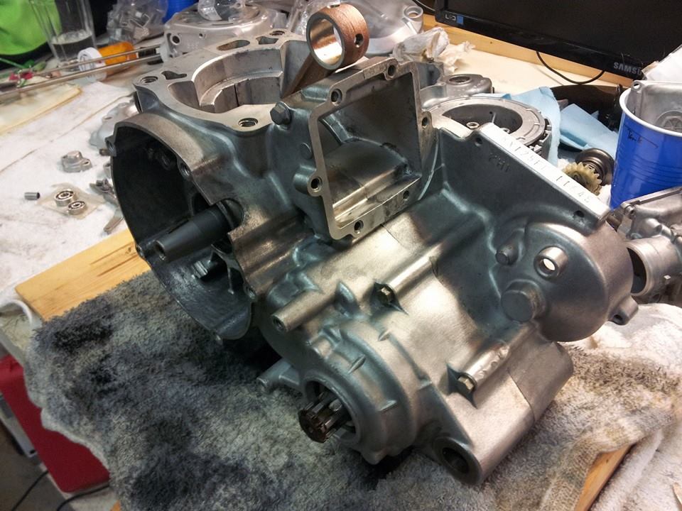

Cleaned off the case half surfaces of dirt/oil..
Think I am almost ready to button the cases together!
queen of spades
Posts: 7
Yamabond
Ready set go
Together again, at last...
Last edited by queen of spades on Sun Nov 23, 2014 1:29 pm, edited 1 time in total.

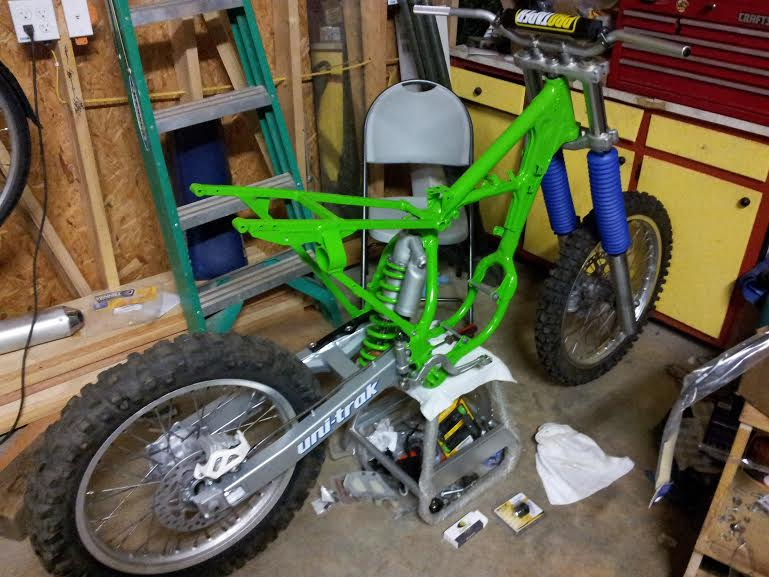

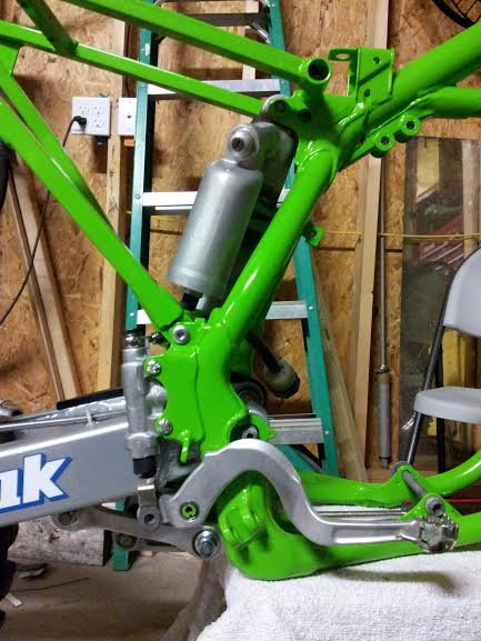

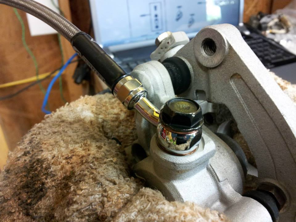

Got some new brake lines shipped in...

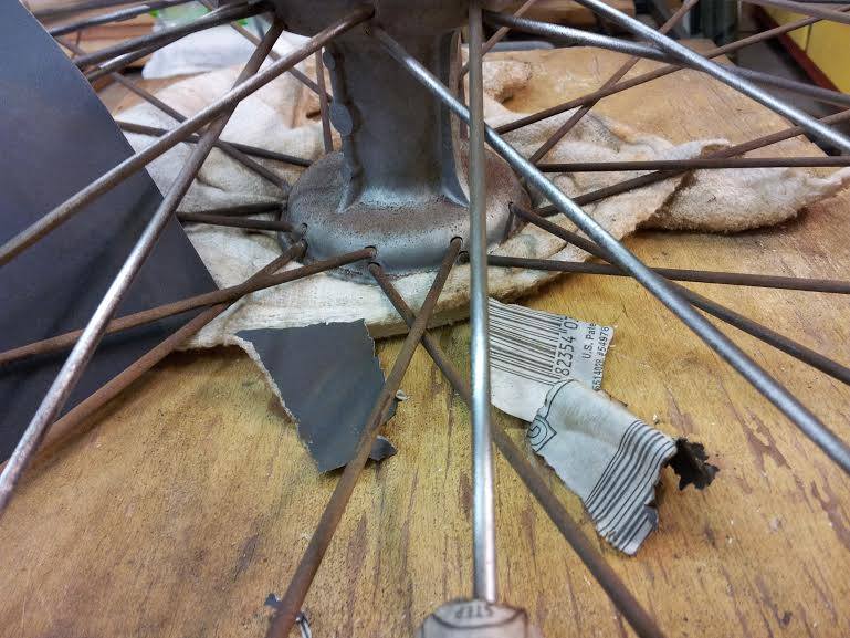

Can't afford new wheelsets right now so I spent a little time fine sanding the oxidation & rust from the stockers....
Yeah, as you know I used the heat freeze method and I let my crank drop all the way in till it stops.
The crank should rotate smoothly when your done.
You should only feel the light resistance from the seals and bearings.
Looks good.
I wish you lived closer... Those cases would be gleaming 8-)

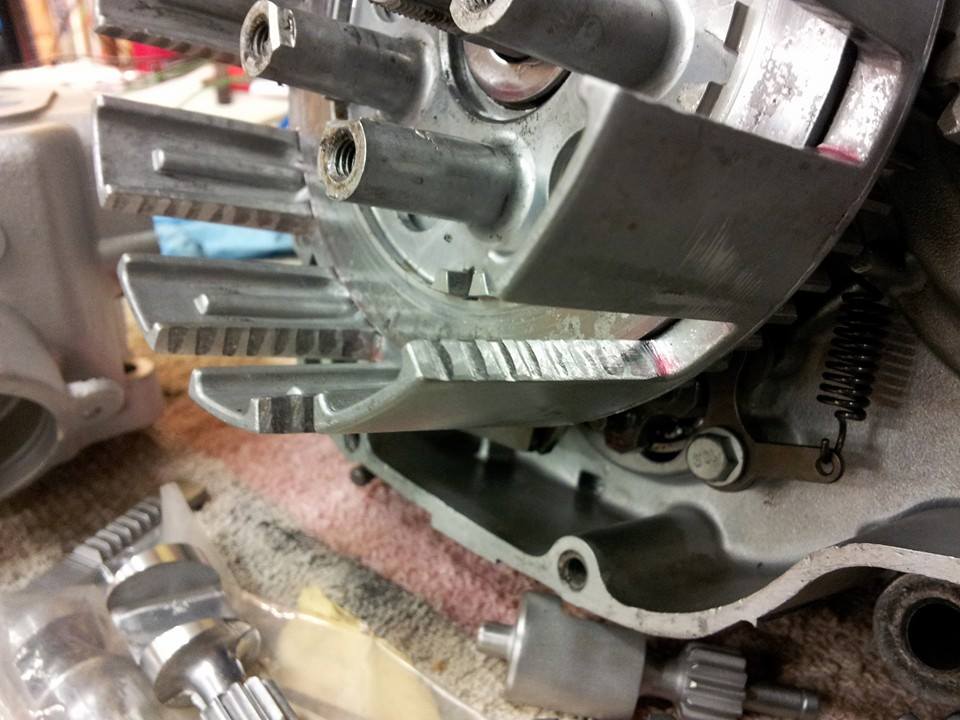

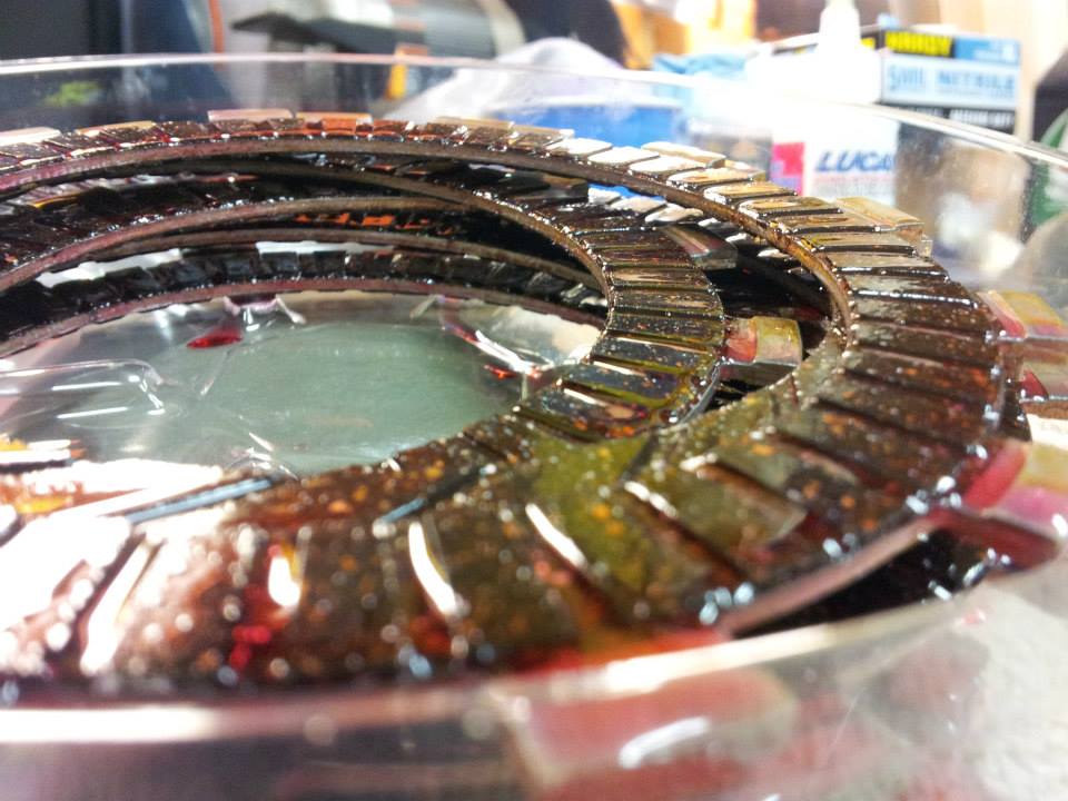

Got some new clutch plates...
queen of spodes 89 kx125 119.jpg (87.11 KiB) Viewed 11668 times
Looks like I need a new basket too. Luckily I found a NOS Matika basket in the UK, it's in route.
queen of spodes 89 kx125 120.jpg (78.63 KiB) Viewed 11668 times

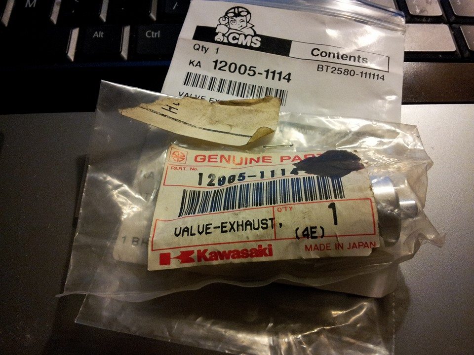

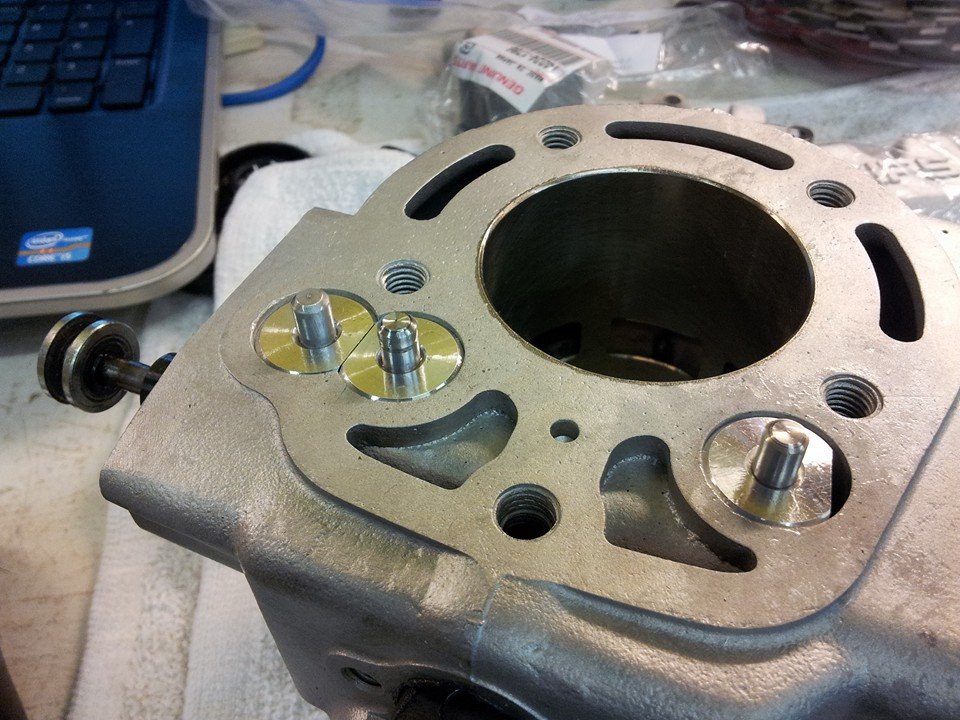

In happier news, I found the elusive RH power valve, NOS:

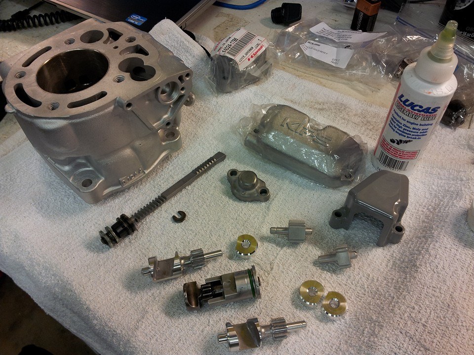

queen of spodes 89 kx125 121.jpg (132.67 KiB) Viewed 11668 times
Shiny happy parts
queen of spodes 89 kx125 122.jpg (129.12 KiB) Viewed 11668 times

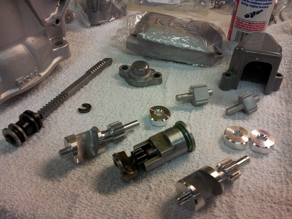

ed out on the Lucus assembly lube and instead went with premix (Klotz R-50)
queen of spodes 89 kx125 123.jpg (204.12 KiB) Viewed 11668 times

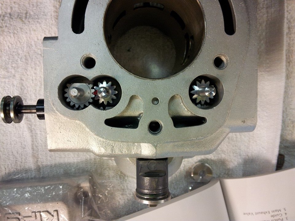

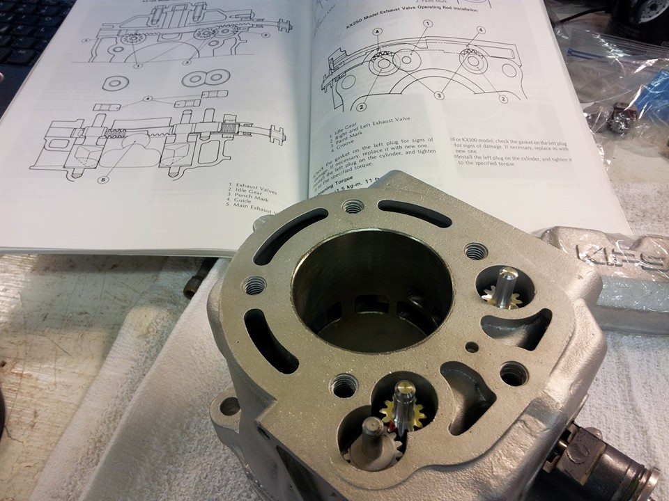

Dry run of powervalve assembly
queen of spodes 89 kx125 124.jpg (142.51 KiB) Viewed 11668 times
Everything lined up
