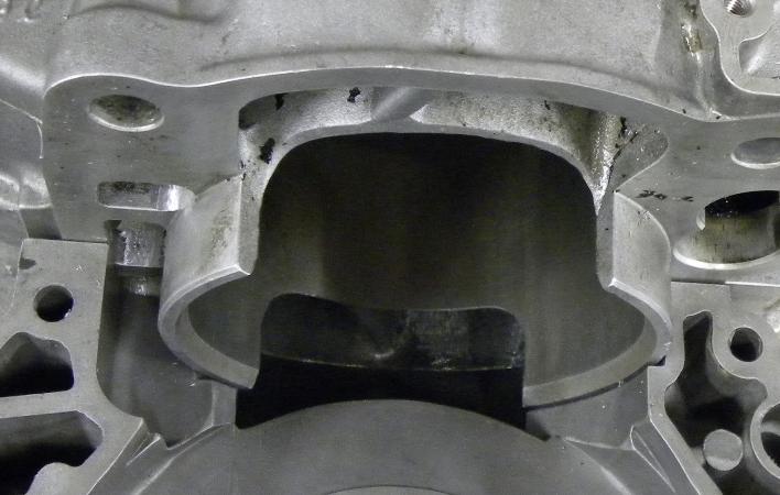

Thanks to Motorrad I was further examining the fitment between the cylinder and the engine cases.
other concerns.JPG (42.85 KiB) Viewed 15936 times
Looks like some improvement is required...
Then I checked out this cylinder that was removed from a bottom end on Friday.
Notice the gasket material hanging into the ports?
BAD!
Before my gasket goes on it will be matched.

Rick Peterson dyno testing a base gasket that hang into the transfer .250" and it didn't change the dyno numbers. Just like a mismatch at exhaust outlet and header flange.

Interesting.
I wouldn't do it on my build.
What do you do on yours?

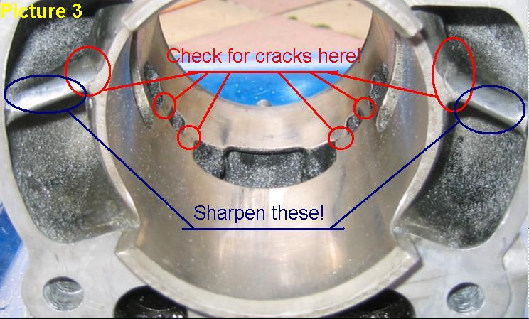

I really like this article:
http://www.hallbergs.net/kx500/
I have seen it referenced many times in the past few years but I finally sat down and read it.
Here's some pics of their port work.
port 1.png (405.16 KiB) Viewed 15934 times
port 2.png (362.96 KiB) Viewed 15934 times
port 3.png (533.77 KiB) Viewed 15934 times

It doesn't hurt to trim them up. On my devcon motor I have to make a base gasket.

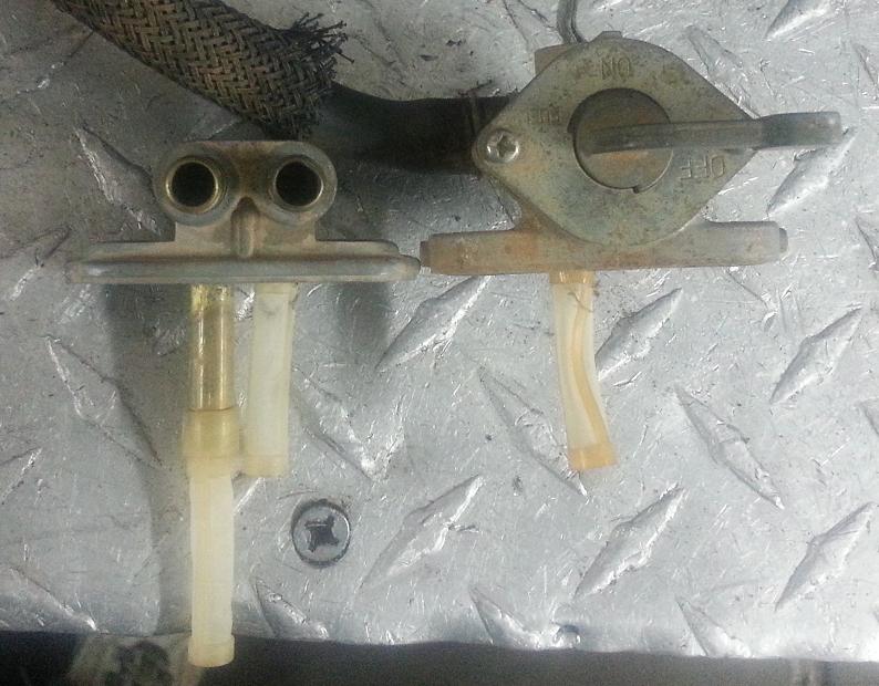

Here is the next challenge..
The gas tank hits the head even without the petcock valve.
As shown earlier, I destroyed my last tank so I will be a bit more careful when molding this one ;)
GAS TANK INTERFERANCE.JPG (136.49 KiB) Viewed 15674 times
Using a Petcock valve and remote reservoir from a KLX450 will help the problem but it is not a cure all...
pet cock comparison.JPG (78.08 KiB) Viewed 15674 times
Since I burned a hole in mine using a heat gun last time I am going try boiling my next one.
