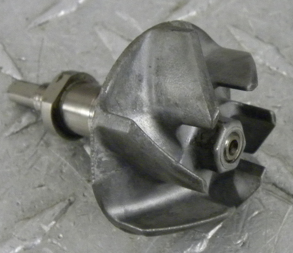

According to the book 02-08 CRF450R used the same impellers.
Here's a pic of a 05
05 CRF450R IMPELLER.png (503.48 KiB) Viewed 16138 times
It is the only one I have so I will check it out on Monday...
Thanks for the links.
I have more reading to do :geek:
