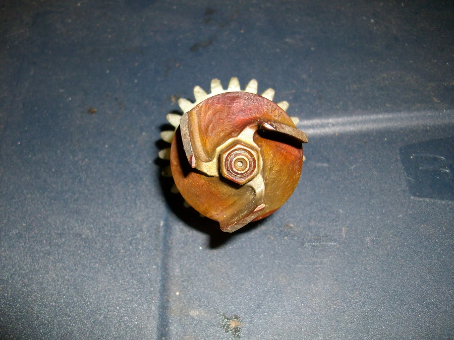

According to the book 02-08 CRF450R used the same impellers.
Here's a pic of a 05
05 CRF450R IMPELLER.png (503.48 KiB) Viewed 17016 times
It is the only one I have so I will check it out on Monday...

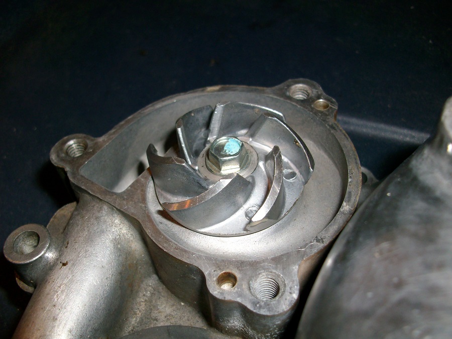

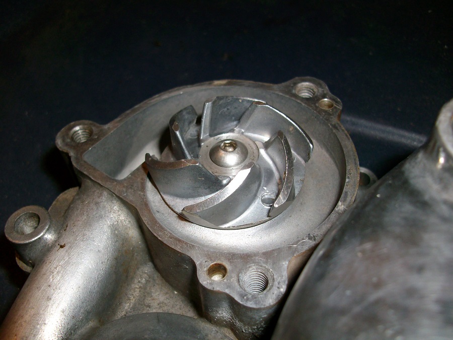

Yes, you right when you are talking about a stock kx 500 cooling system. The kx 500 system is only good for kx 125 horsepower. The stock kx 500 impeller is the same in the 125 and 250 for older model motors. That impeller is good for 90 horsepower at the wheel in the right cooling system.

smooth head
smooth head
smooth head.JPG (214.29 KiB) Viewed 16997 times
standard bolt
standard bolt
smooth head.JPG (216.92 KiB) Viewed 16997 times

Hmm never thought about the bolt head. Very good.....
Kx550 Power By
Motorrad
So the stock bolt is causing cavitation?
Makes a certain amount of sense....
