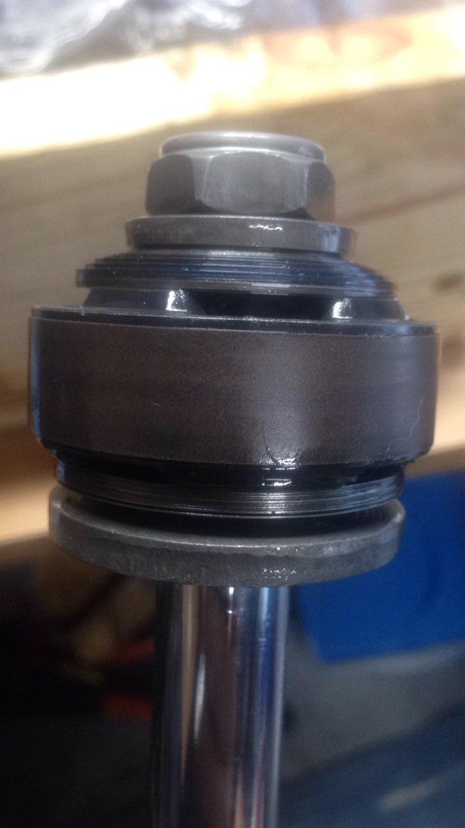

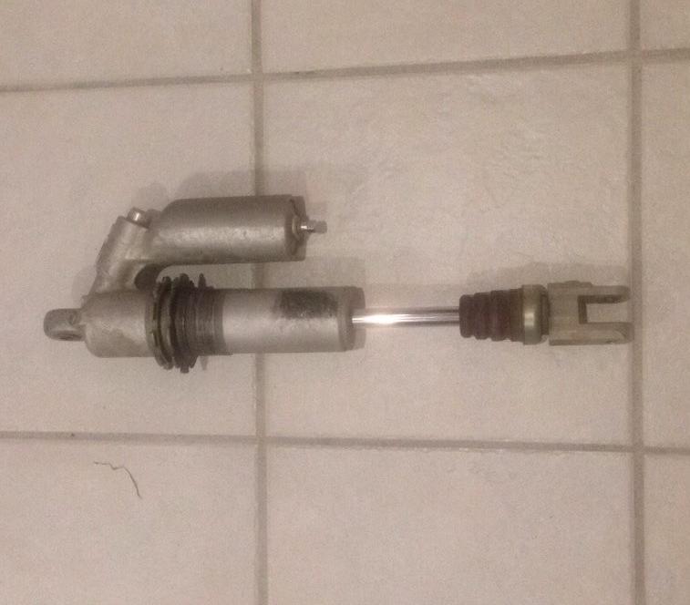

On to the shock.
This shock was specially built by Enzo for Sean.
The way that Sean rides however, he has more rubber on the bottom of the rear fender then he does on the rear tire :shock:
So, after discussing our options we sent the shock to Alex Ward at Crazy Al's Racing for a rebuild.
KX GURU RACING SEAN COLLIER KX500 223.JPG (44.73 KiB) Viewed 16388 times
Posted: Thu Oct 13, 2016 6:59 pm
I won't go into full detail on what all was found, I'll let Alex do that 8-)
But here is a brief description.
The body, clevis, rod, and bladder, were stock KX500
The custom valving that Enzo used was a Stock KX450F valve.
That's right, the KX450F valve fits right into the KX500 body and on the stock shaft.
Does it really gain you anything?
That's to be determined.
Then Enzo added a bunch of shims.
Alex has the details on the shim count, thickness, and diameters.
However, Alex has a better way to go.
That's right, Pro Action makes a nice replacement valve and custom shim stack for the KX500.
After Sean rides the Beast with this new set up we will let you know what he thinks.

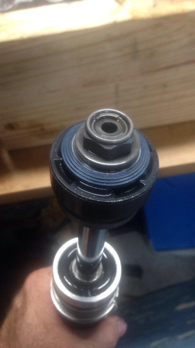

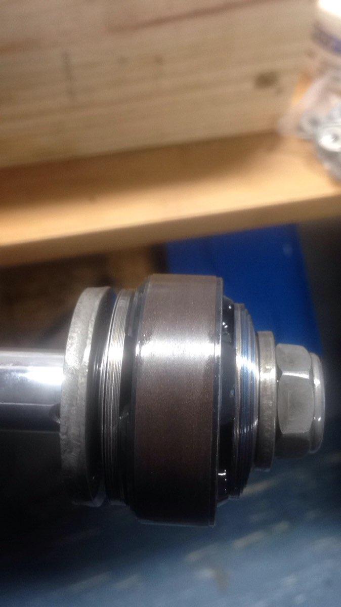

Posted: Thu Oct 13, 2016 7:01 pm
By the way, Alex donated all the parts and labor for this build...
THANK YOU ALEX!!!!!!!
Here is some pics of the old and the new for your viewing pleasure..
