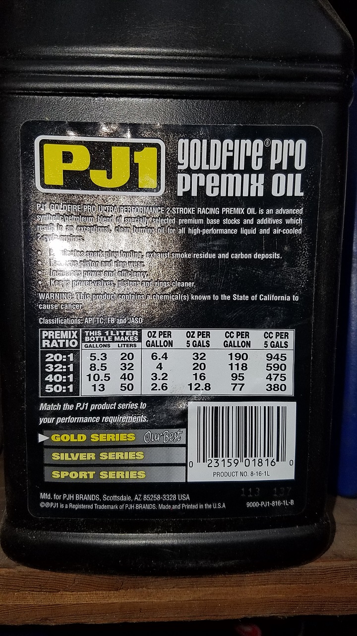

I have some PJ1 7-32 Silverfire 2-Stroke Injector/Premix Oil. Would I still go that high (50:1) using this premix? I'd hate to lose the newly rebuilt motor by not running enough premix.
I do not run that oil so I don't have first hand experience.
I went to their website but they do not specifically call out recommended mix ratios.
http://pj1.com/i-19004745-pj1-silverfir ... liter.html
I do have a bottle of the Gold series on the shelf.
This is what the back of the bottle shows..
Take a look at the back of your bottle and see if it shows a recommendation.

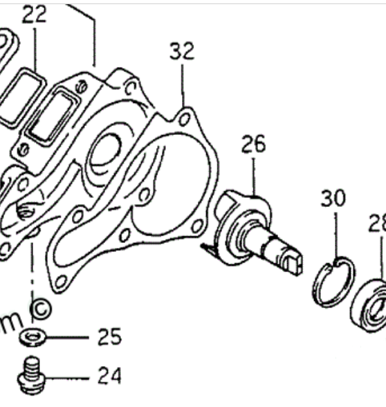

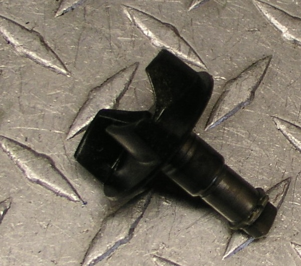

Mike, need your help on this. I have a brand new water pump impeller that was in the parts bin I bought. It looks like it may be too long, though. I have a shorter version that looks like it will fit once the case is fully lowered but I'd like to ask if you could recall what your impeller looked like and if it was a short or long stem. The guy I bought the parts from stated these were hard to find new and I was lucky he had one. The same guy who had four complete engine cases in the bin but didn't tell me one clutch case was for an RM125. The same one I decided to prep and paint to use on my rebuild!
https://scontent.fagc1-2.fna.fbcdn.net/ ... e=59ECF9E1
It seemed to me it looked like this one..
1988 rm250 impeller.jpg (123.55 KiB) Viewed 10422 times

Mike, the water pump impeller you showed was not the correct one. It was actually the longer version I had.
