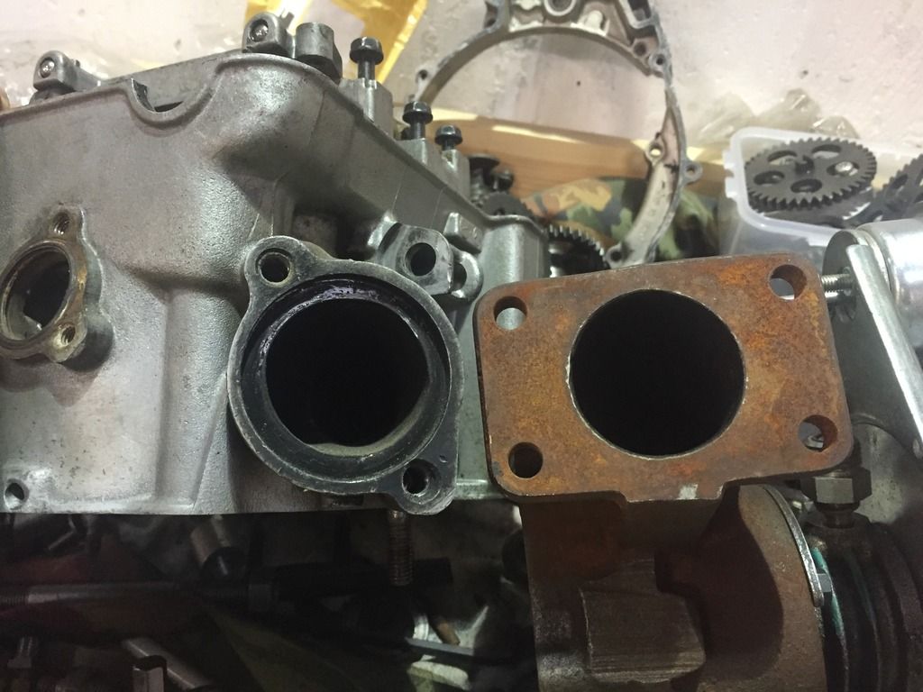

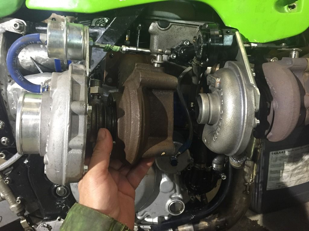

The turbo came in the post, it is bigger, most importantly it is much bigger inside.
The other thing I was hoping for a result on was the lack of restriction on the turbine entry.
It looks more different than it actually is here, the head exhaust port is 41mm diameter and the turbine entry is 43mm. Just from memory the other turbo has an entry of 35-36mm so that should ease exhaust pressure. Which will be a good thing as long as the flow of exhaust gas is sufficient to spool this turbine.
All things which will become clear through time.
Posted: Thu Aug 04, 2016 6:18 am
It would sure be easy to make the intake and turbine port diameters match...
Posted: Thu Aug 04, 2016 6:20 am
In fact, take a look at what size the gasket ID is for the exhaust port...
Is it 43mm or a little bigger?
Posted: Fri Aug 05, 2016 11:37 am
by Crofter985
It could be 43mm. I tried a OEM gasket but it did not sit on well with the manifold, I ended up making one out of copper which seems to be working out ok. What is probably the best thing to do is open out the exhaust port a bit. Perhaps not right away but at some time. And anyway a manifold will have to be made. So over the 3-4" of the manifold if I taper it from 41-43mm it should still give good gas flow.
I do have the head with big valves laying by. That head could easily need a opened out exhaust port. It is +1mm on the exhausts and just standard on the inlets. I also got hold of two "R" inlet cams which are +4 degree duration, as the inlet and exhaust are the same cams I thought to run two inlet cams, this would do away with the KARC but I do have the option to lower the compression as I have a piston from a Yamaha rhino with a lower crown to go in, I could tailor the compression with that, it also is a +3mm bore and I have a bored out cylinder ready too. Now if I'm having trouble spooling that new turbo, that stuff might help.
