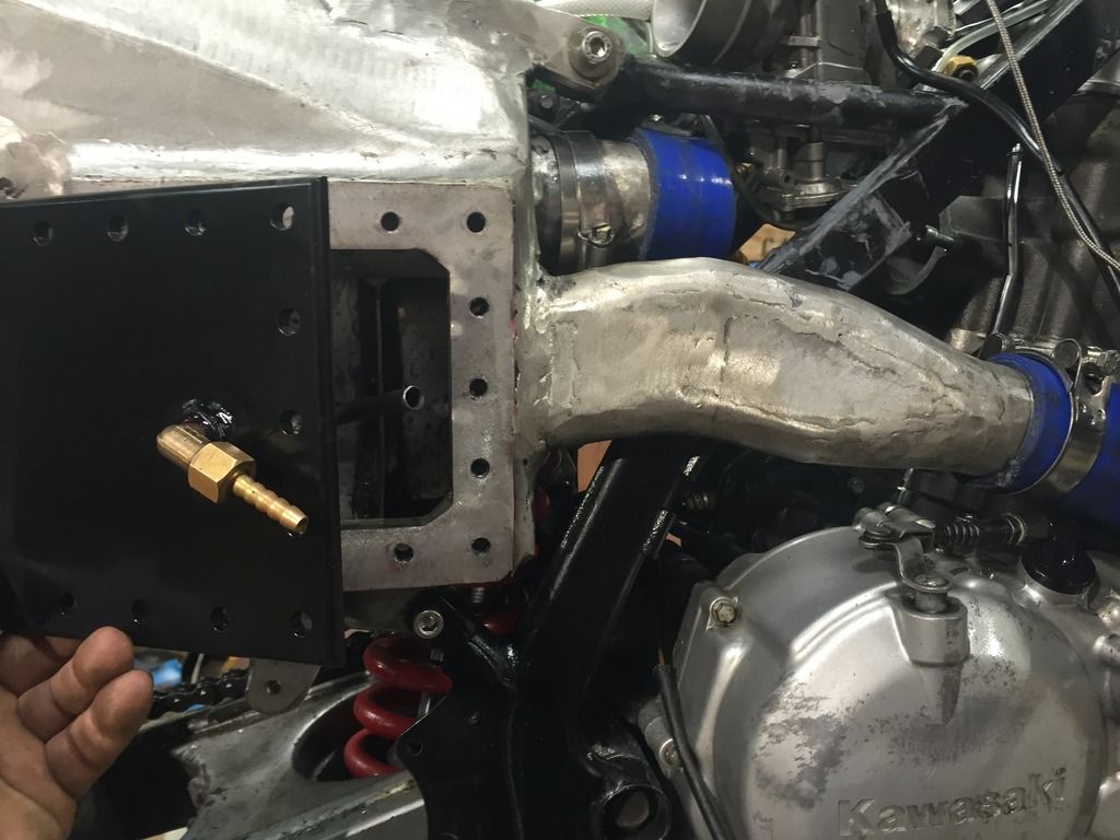

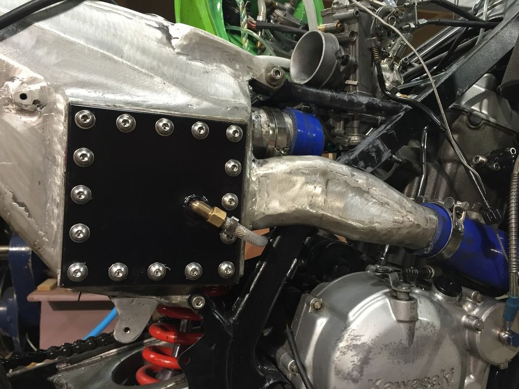

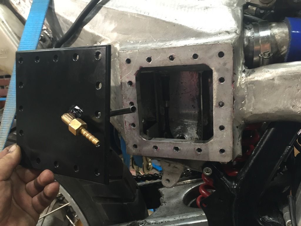

Made a pitot tube.
It points up the tube coming from the turbo.
Cleaned up the welds and gave it a lick of paint too.
So another go at getting it to run. No dice, very lean. Put in a 55 slow jet, tried again. It's starting really well now. Picking up right away. But lean with throttle I think I started with the 175 main in. To make a big difference, as it was off the scale lean as the pressure got up, I drilled out a jet to 200. Still not rich enough. So I had a 210 surely that would be enough??? Nope, more of the same. Tits, well I'm going to get some more gauges on the go tomoro, see if I can shed some more light on this. See if that pitot tube is doing its stuff.
The float valve seems to be holding up to the pressure well now, so a positive in among all the frustration. I fed the FPR from the pitot tube too so it was putting a bit of fuel pressure there too.
Oh well, no nearer really.
