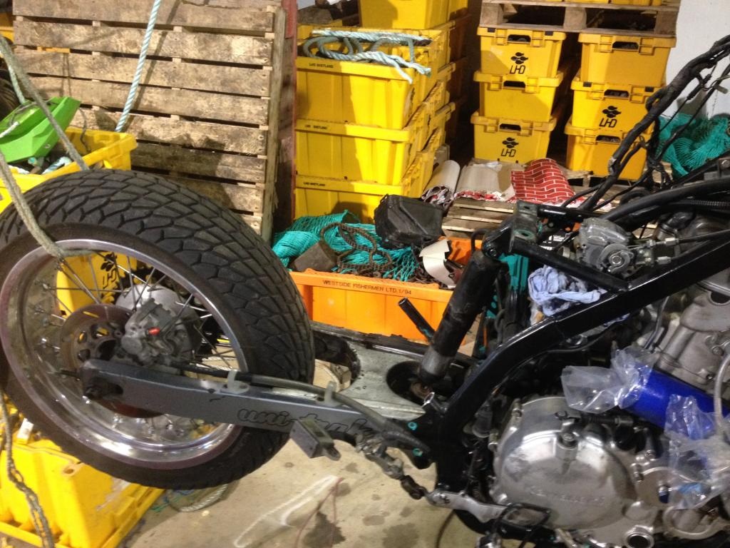

Made up a frame for a reference of the seat mounting and the rear mudgaurd mounting.
Crofter985 klx650c supermoto build 129.jpeg (249.12 KiB) Viewed 12351 times
With the tank lifted 15mm it also moves it back around 10mm, the frame or jig, has been moved to compensate.
Now off with the old one....
Crofter985 klx650c supermoto build 130.jpeg (253.38 KiB) Viewed 12351 times

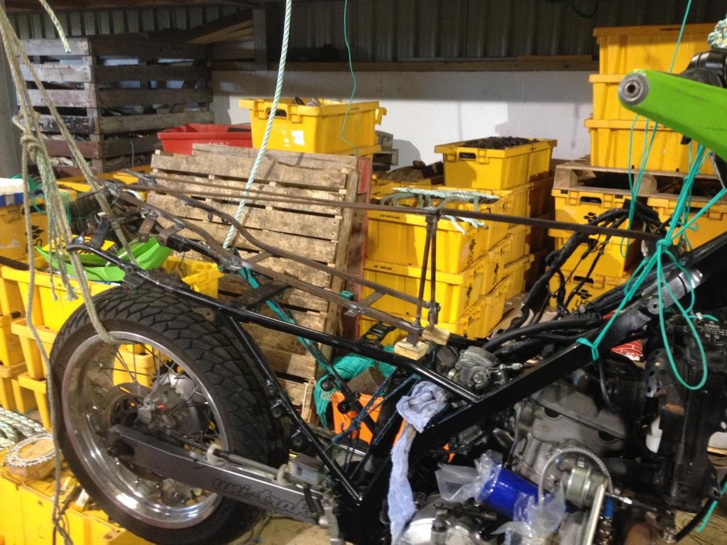

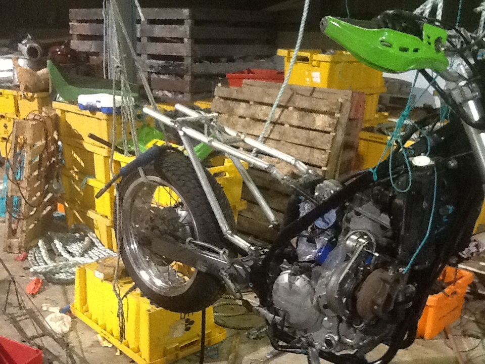

Now, no going back now, I bent 4 "U" shaped bits of steel flatbar with a 25mm jaw and turned 4 25mm bits of alloy bar for mounting points for the subframe.
Then got on with roughing out a frame.
Crofter985 klx650c supermoto build 131.jpeg (311.69 KiB) Viewed 12351 times
That's where I'm up to now.
Still a lot of fabrication to go yet and a lot of stuff to fit in to that subframe.

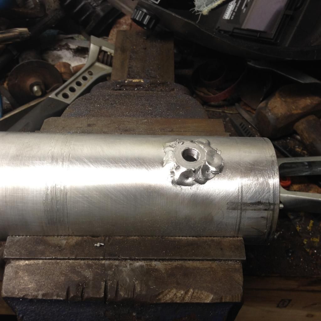

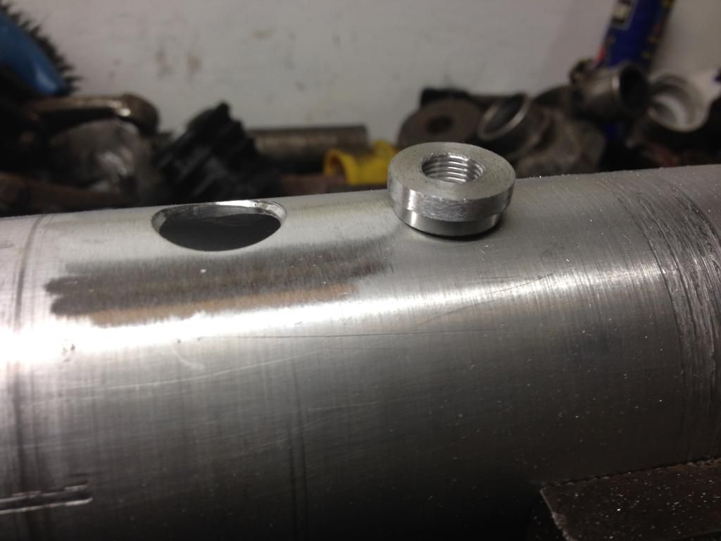

So to keep some momentum going I messed around with the intake tube for a bit. I got a 2 1/2" aluminium tube the other day but all I could get was stuff with a 3mm wall, a bit thick for what I was needing so I bored it out to just under 2mm and I need a bung for the water meth jet, it's got a 1/8bsp thread so I got a tap for that and made up a bung and drilled a hole to weld it into the pipe
Welded it in
Now that's not the prettiest weld ever but there's no holes and it's not going to fall out, that thin aluminium is not the easiest to weld.

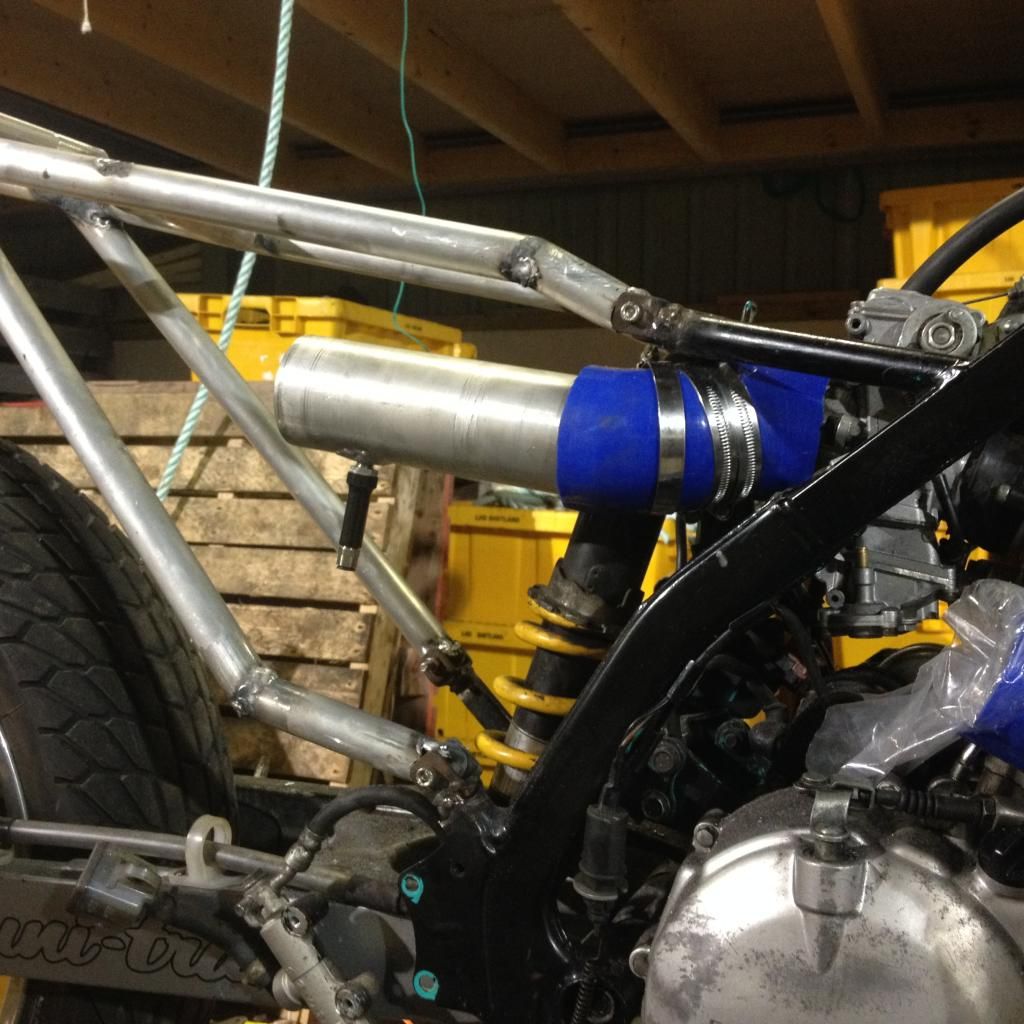

Here it is, with the w/m jet in place, the blue hose is a 90 bend neoprene hose cut in half and turned so you get a dogleg of hose, which was needed to clear the upper shock mount.
So there it is the AEM kit recommends the jet goes a few inches behind the throttle plate so this should push all the buttons for that. I will make a door on the plenum so I can get to the jet later if needed.
