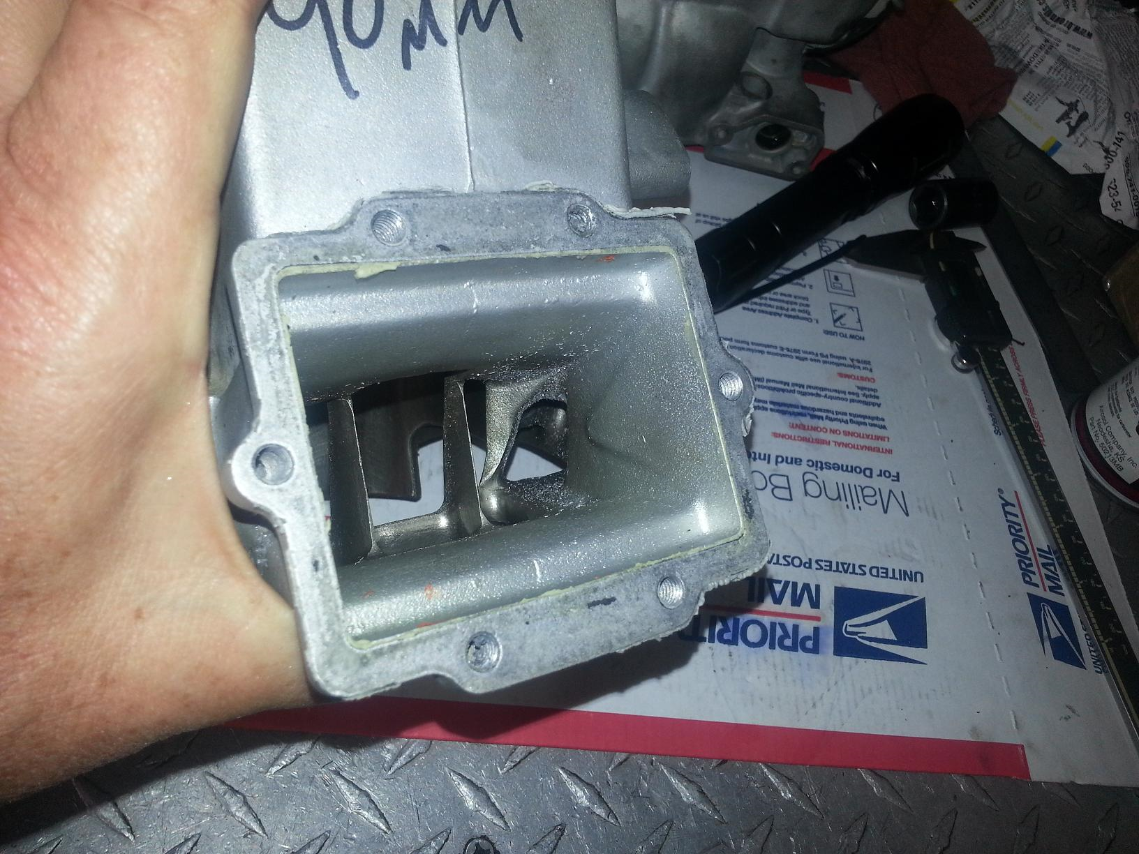

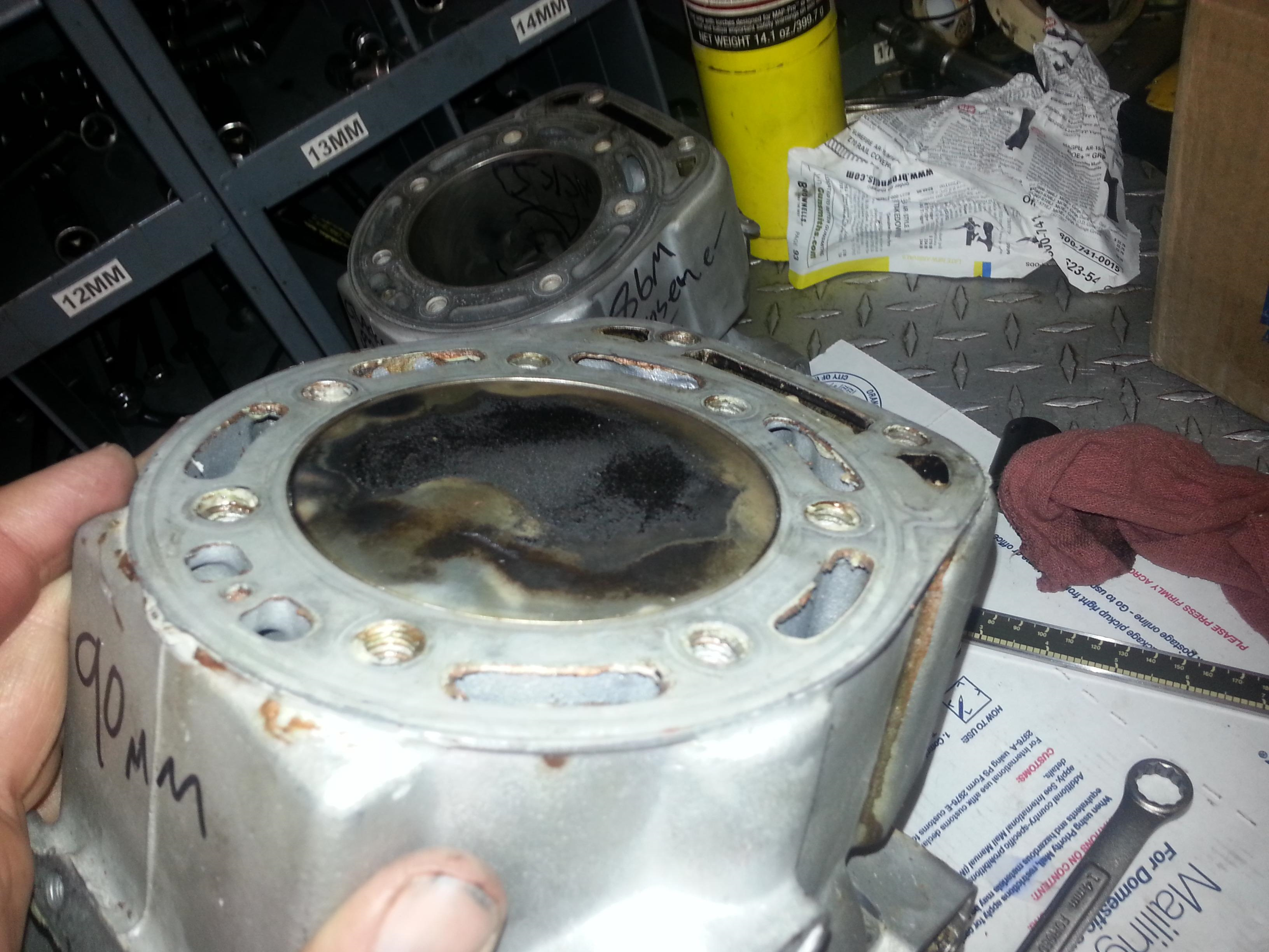

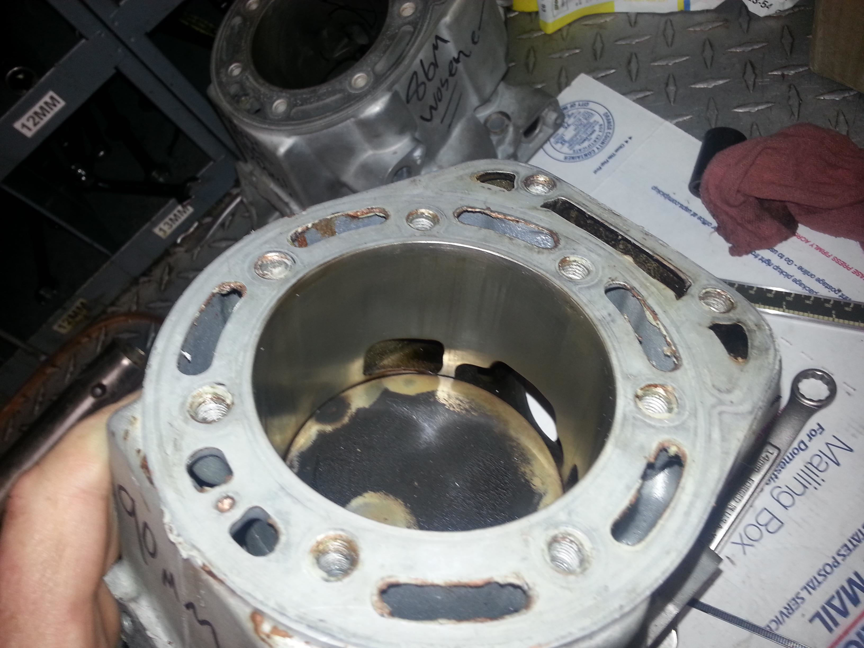

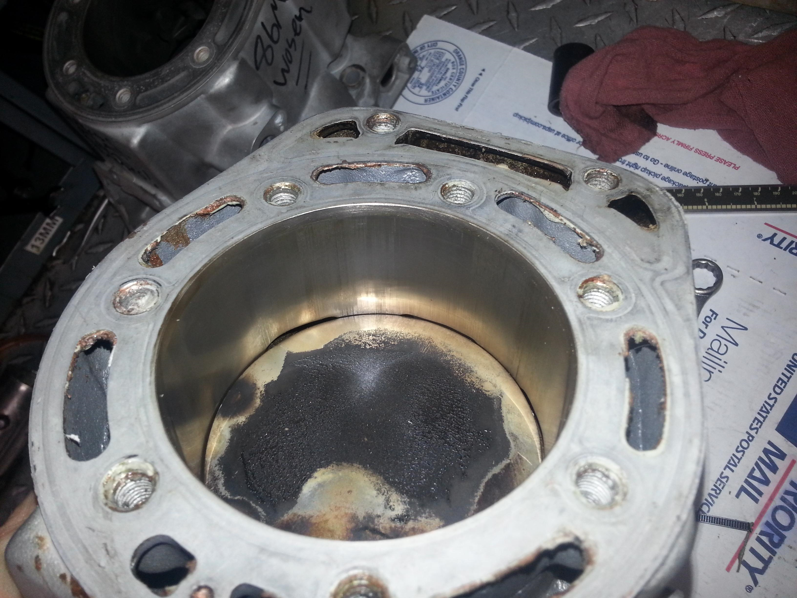

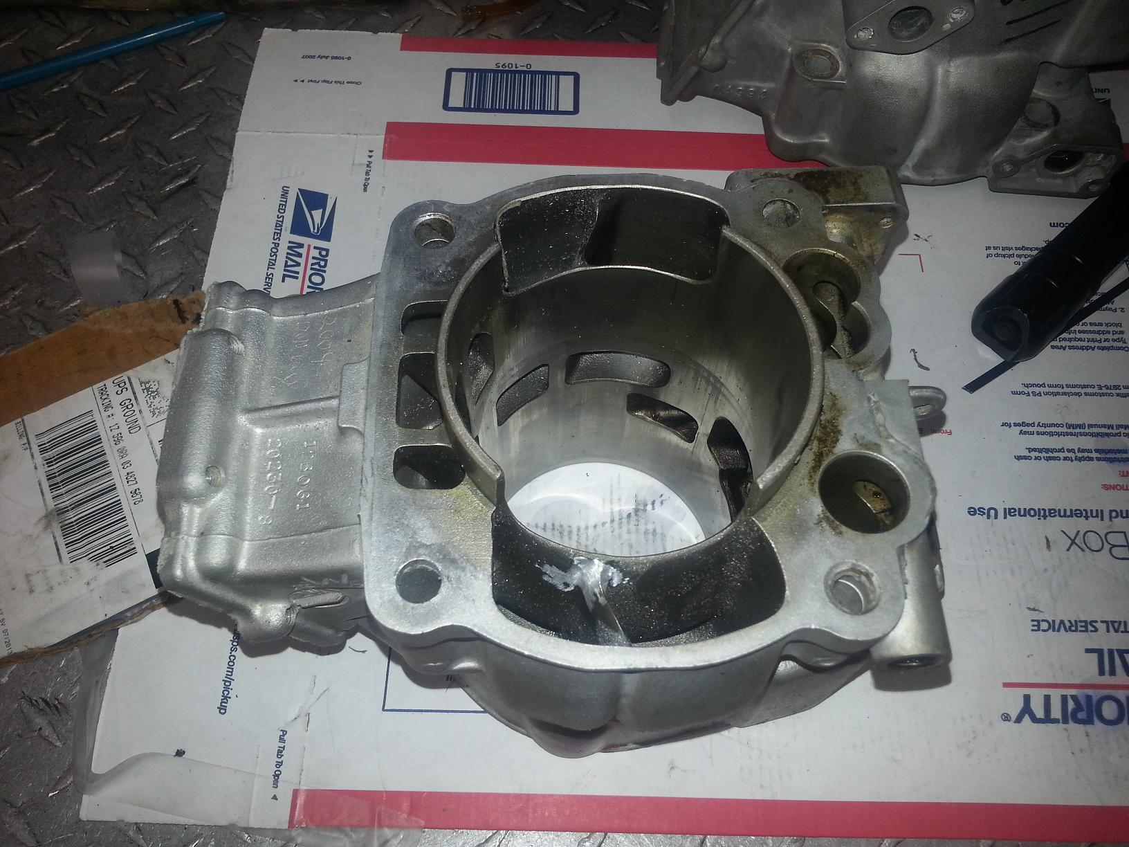

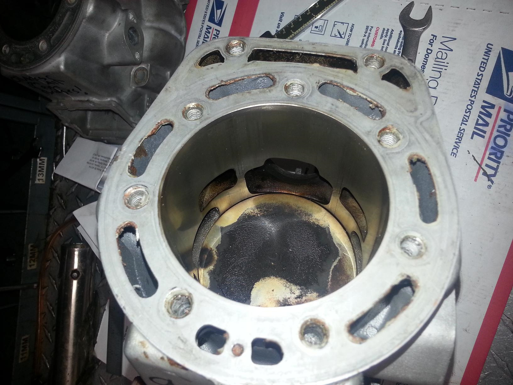

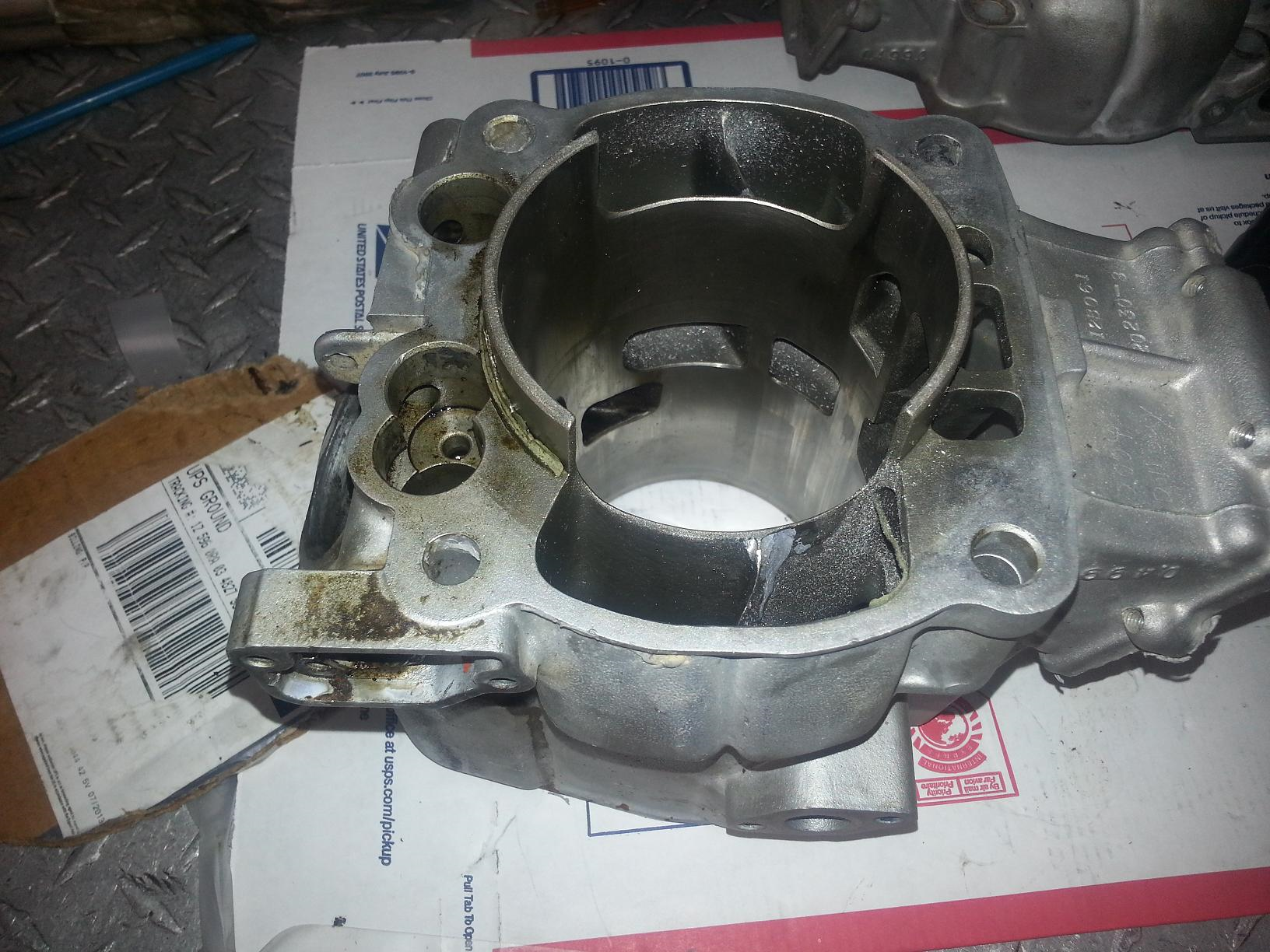

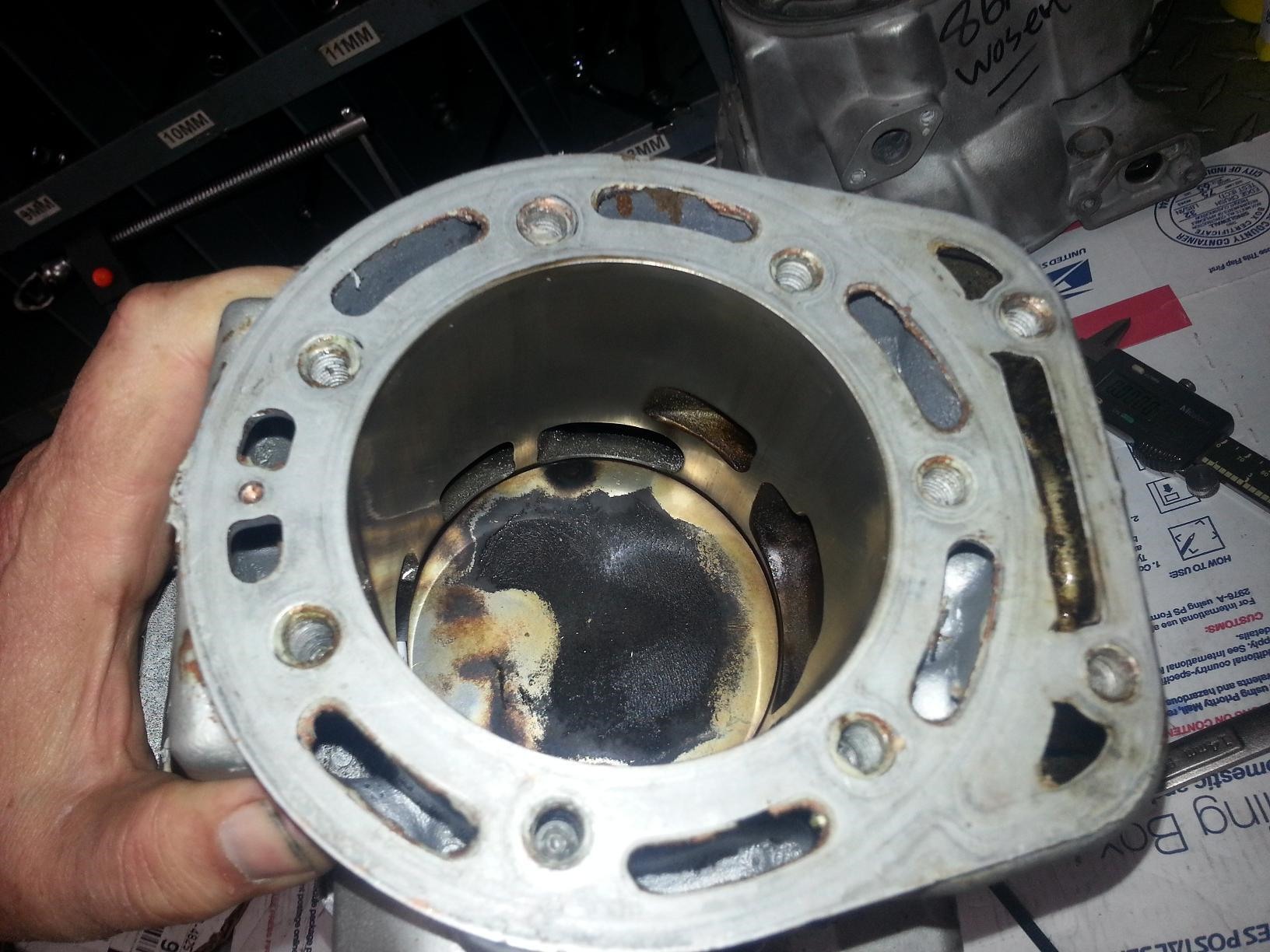

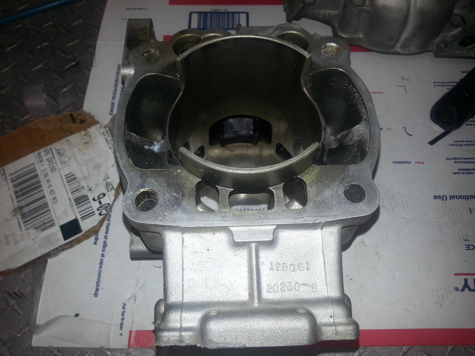

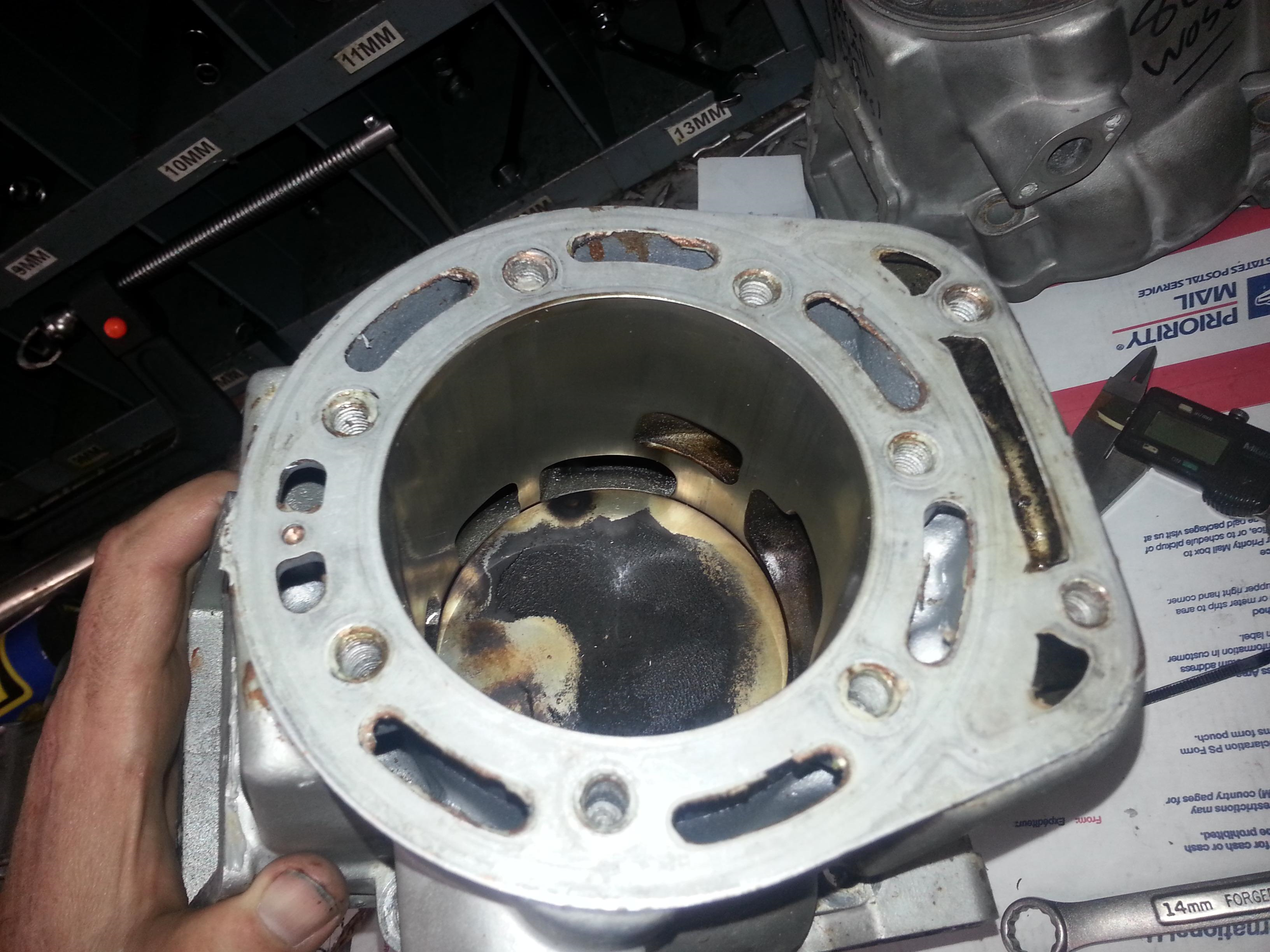

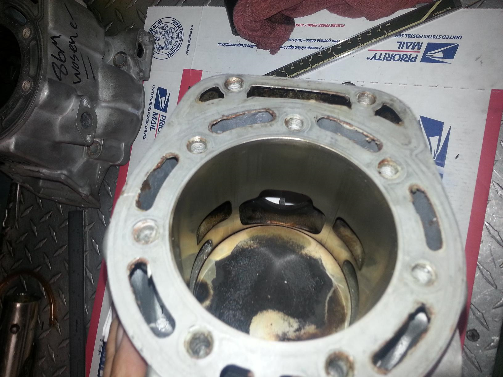

81cr450:
Thats a pretty good burn pattern. Just a couple thoughts I've had on doing this. Paul F you in the A Class, had a divided intake boot to help keep & improve a sweet burn pattern like that. So all the charge doesnt end up on the right side of the motor. Where can I get that, someone said watercraft?Huh??
Also Dave have you considered reducing crankcase volume, use the cr5 piston & rod shave from top & bottom to shorten the barrel & valves a couple mm. The valves you could just cut out of the stem between drum & gear as long as you had a jig.
2 more while I'm at it, the volume in the transfers,ex side, I can see you removed the divider, the drum becomes a restriction at some point so the drums should be cut to increase the volume in the exhaust port. You also showed a k5 cylinder with a flange welded on the outside of the jug so the pipe junction is larger, when you finally look at the cpi pipe youll see the volume theyre trying to deliver at that point. For that matter ask Roost about porting the CR5 clear out into the flange. I know youre thinking intake side , cooling etc... dont forget theres alot of room in the xhaust too
Finally I weigh 165 & live in Utah, am lighter than you, please I'd help with about anything you could ask. I'd even polish your rod grin

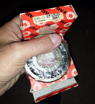

So a pair of old German FAGs knocked on my door today.
And you thought I was telling a joke.

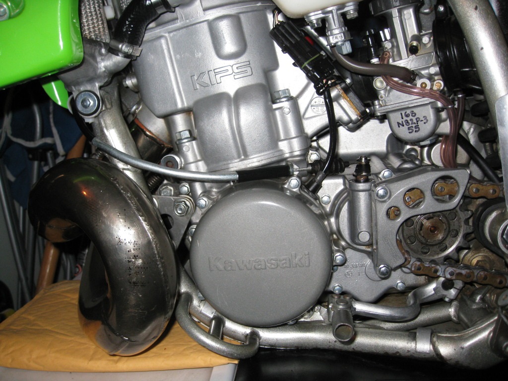

My Jug is going to drop .0523"
somewhere on this site, somone had a team green bike, that had a watertight connection plug on the motor harness for easy removal.
was that your bike Tom? Since I was lazy and CUT my wire's when I removed the motor this time (I planned to put a plug on it or I wouldnt have). I now need one to put it back together.

Yeah Toms had the weather pack plug. I believe you can get something of the sort at Napa
2-Stroke Tom
Your guys are correct, mine has the all weather plug. Here is the best picture I have it of it.
KX500 JEFF WARD ROUND 3 REBUILD 1064.jpg (268.35 KiB) Viewed 8520 times
Motorrad - Let me know if you want me to look for a number or get a better picture.

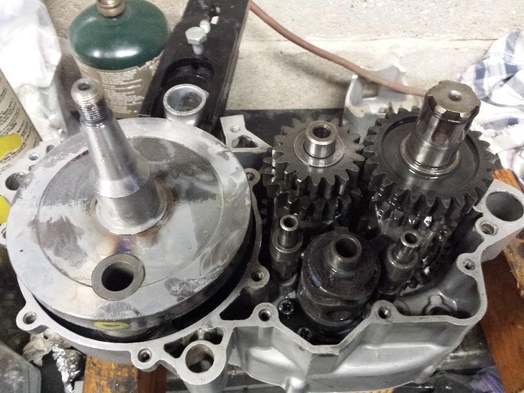

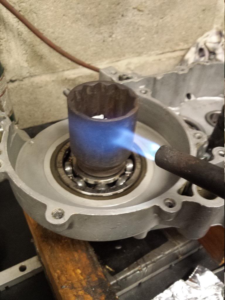

hmm trans bearing 92045C feels crunchy.
sandblaster
Stinks that you just replaced it a short time ago and now you have to do it again... :x
Motorrad
And that one is the blind hole one
sandblaster
Yep, I looked it up.
If it was on the out put shaft I'd say ok, they are abused and any time my engine builder does a bottom end he automatically plans on replacing it.
But the bearing you need usually feels good.
So, you gotta wonder, why :?:
Motorrad
Was a new nsk bearing too hard to find that one
