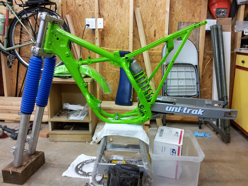

Queen of Spodes 89 KX125 Kawasaki complete rebuild
Re: Queen of Spodes 89 KX125 Kawasaki complete rebuild
queen of spodes
queen of spodes 89 kx125 111.png (1.19 MiB) Viewed 9360 times
motojason
Frame looks great!
sandblaster
Quote from: queen of spodes on September 28, 2014, 12:39:35 PM
What size tips are needed for these snap rings/circlips? I had a devil of a time getting these off.. ending up mangling a few of them. The snap ring ends kept popping off the tips. I tried a smaller diameter pair and those bent.
Sorry buddy... no idea what size I used... I destroyed some smaller tips and my bigger tips were too big so I ground some big tips till they fit to perfection.
Your chassis is looking great!

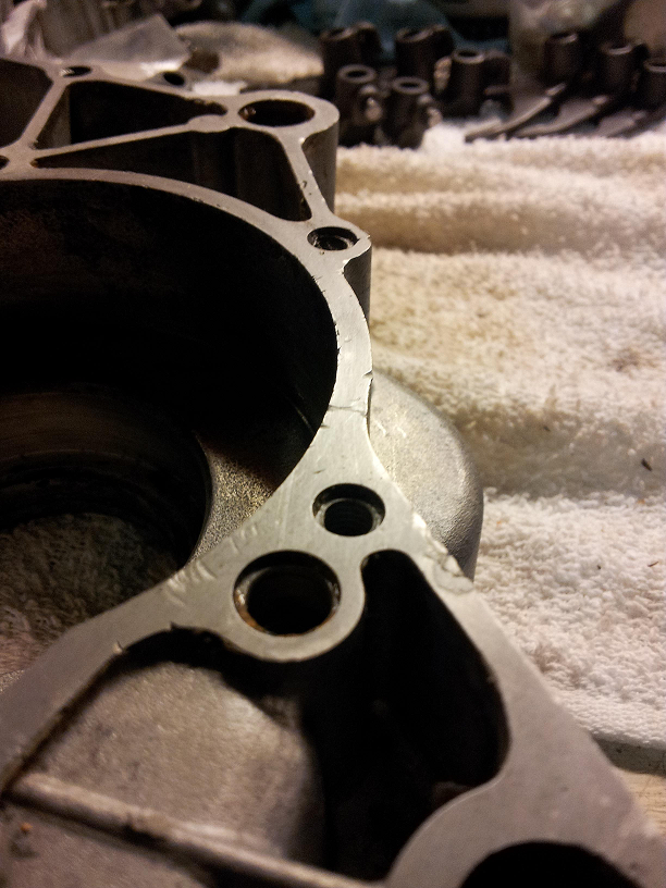

queen of spodes
Help!
I lapped case halves tonight using the bolt method. They are tight now, used to have some light shine through, now virtually none.
I did spot this troubling defect:
queen of spodes 89 kx125 114.png (820.03 KiB) Viewed 9360 times
This little scratch catches on my fingernail. Will Yamabond seal it up, or do I have a problem on my hands?
sandblaster
Yamabond might do it but I like to fill them first with JB Weld.
viewtopic.php?f=40&t=411
queen of spodes
I was thinking of that - thanks!
