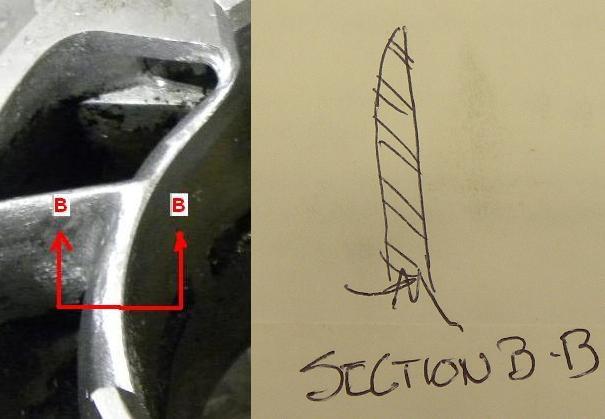

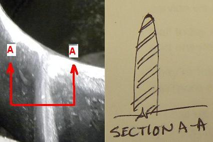

Re: BUILDING A KX500AF with a 2007 KX250F chassis
Posted: Sat May 04, 2013 3:24 pm
Thanks Tuck, reminds me of a few classes I had in college :D
I'm a little further along then is suggested in this article.
Work is finally showing signs of life and the weather is better so I'm either working or playing... Lot's of work, little play.
Here is some pics I sketched out last week to show what I am attempting to do.
CROSS SECTION A.JPG (16.98 KiB) Viewed 16371 times
CROSS SECTION B.JPG (27.4 KiB) Viewed 16371 times
I use to build and fly RC aircraft.
The P51 Mustang is one of my favorite aircraft and I use to play with laminar designs :D
Back to the cylinder, Motorrad has been helping me and I have been using his pics as a guide.
The problem is that it's hard to see curved or angular surfaces in pics so I have been asking him 1000 questions a day :o
I'll post some of my questions later.
And your right, there is huge rewards in this, so while I am nervous about it and it can be tedious, it's also fun.
And, this is a practice cylinder.
If it looks good when done I'll get it plated.
If not, well someone will want it, or maybe I'll cut it up and use it for demonstration purposes :o
